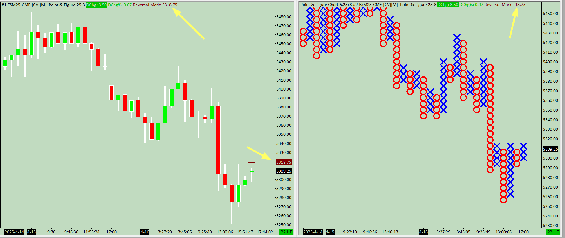

Problem Description:
As soon I add the Point and Figure Chart study (to show the X's and O's) to a Point and Figure chart (Bar Period and Study both set to 25x3) the Point and Figure Chart Reversal Marker Study loses it's value and shows either -18.75 or +18.75, not the actual price where a reversal would be printed.
I tried to just have a duplicated PnF chart without the Point and Figure Chart Study and use the Study/Price Overlay to get the reversal price onto my real Point and Figure chart, but this is not working either - my chart is printing X's and the reversal price marker is above the X's while it should be below to show where the chart will start printing O's.
Screenshot of the two charts attached, as well as the Chart Book.
Chart 1 is a 25x3 with only the Point and Figure Chart Reversal Marker Study
Chart 2 is a 25x3 with the Point and Figure Chart Reversal Marker Study and the Point and Figure Chart study
Let me know if I can help with further information.
image2025-04-16 17_24_51-Sierra Chart 2739 pnf_issue SC Data 2025.png / V - Attached On 2025-04-16 23:25:53 UTC - Size: 93.88 KB - 337 views
attachmentpnf_issue.Cht - Attached On 2025-04-16 23:26:13 UTC - Size: 10.3 KB - 370 views
