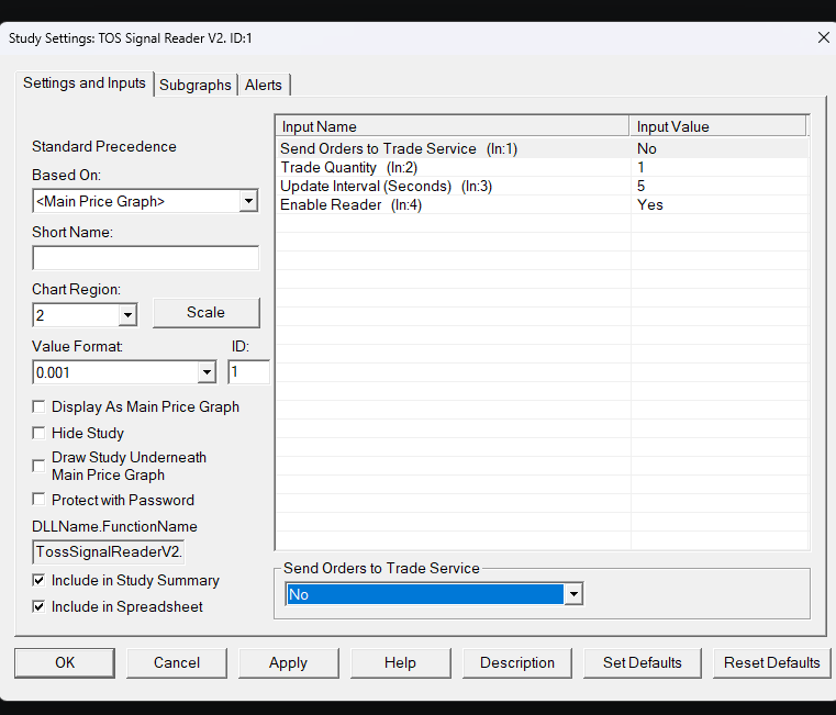

I’m using a custom study (TOSSignalReaderV2) to place a simulated short order via sc.SellEntry() for [Sim]MNQM25-CME. It consistently fails with error -8996 ("Order quantity is zero or invalid"), despite setting TradeQuantity to 1 in sc.SetDefaults and enforcing it in code. The log shows Order Details: Symbol=[Sim]MNQM25-CME, Qty=0, Type=0, TIF=0, and no position opens in the Trade Window.

Steps Tried:
Forced newOrder.OrderQuantity = 1 at startup, pre-signal, and final assignment (tradeQty > 0 ? tradeQty : 1).
Renamed DLL to TOSSignalReaderV2.dll, rebuilt via Remote Build, deleted old DLLs, and restarted Sierra Chart.
Reset Study Settings, manually set Trade Quantity to 1, confirmed Send Orders to Trade Service = No (simulation).
Added detailed logging (Order Details) to verify parameters—still shows Qty=0.
TOSSignalReader.cpp source code.
Screenshot of Study Settings (Trade Quantity = 1, Send Orders to Trade Service = No).
Request:
Why is TradeQuantity.GetInt() returning 0 despite being set to 1 in code and Study Settings? Is a Sierra Chart configuration overriding this? Please check the Trade Service Log for additional clues (I’ll attach it if needed).
