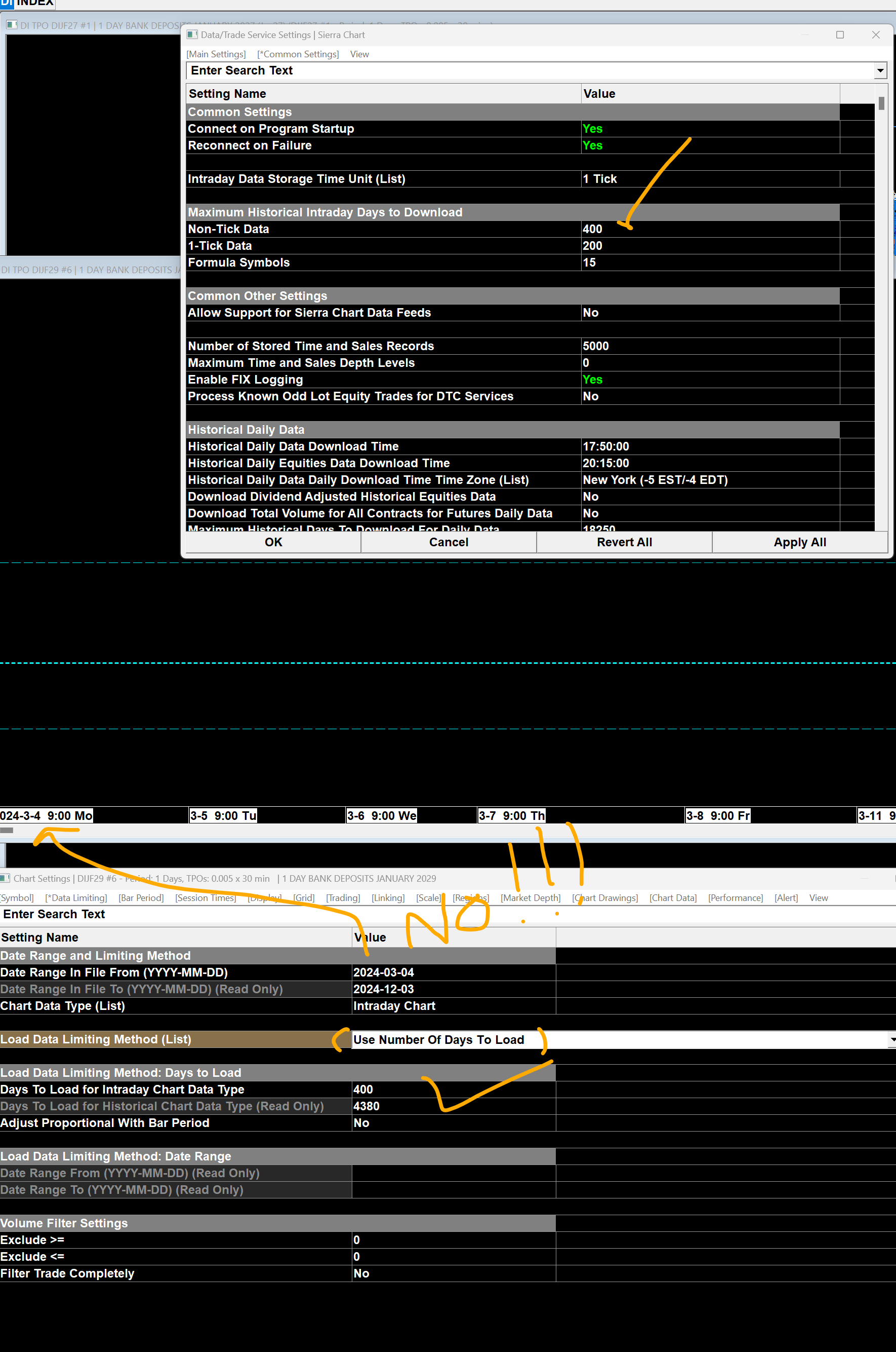

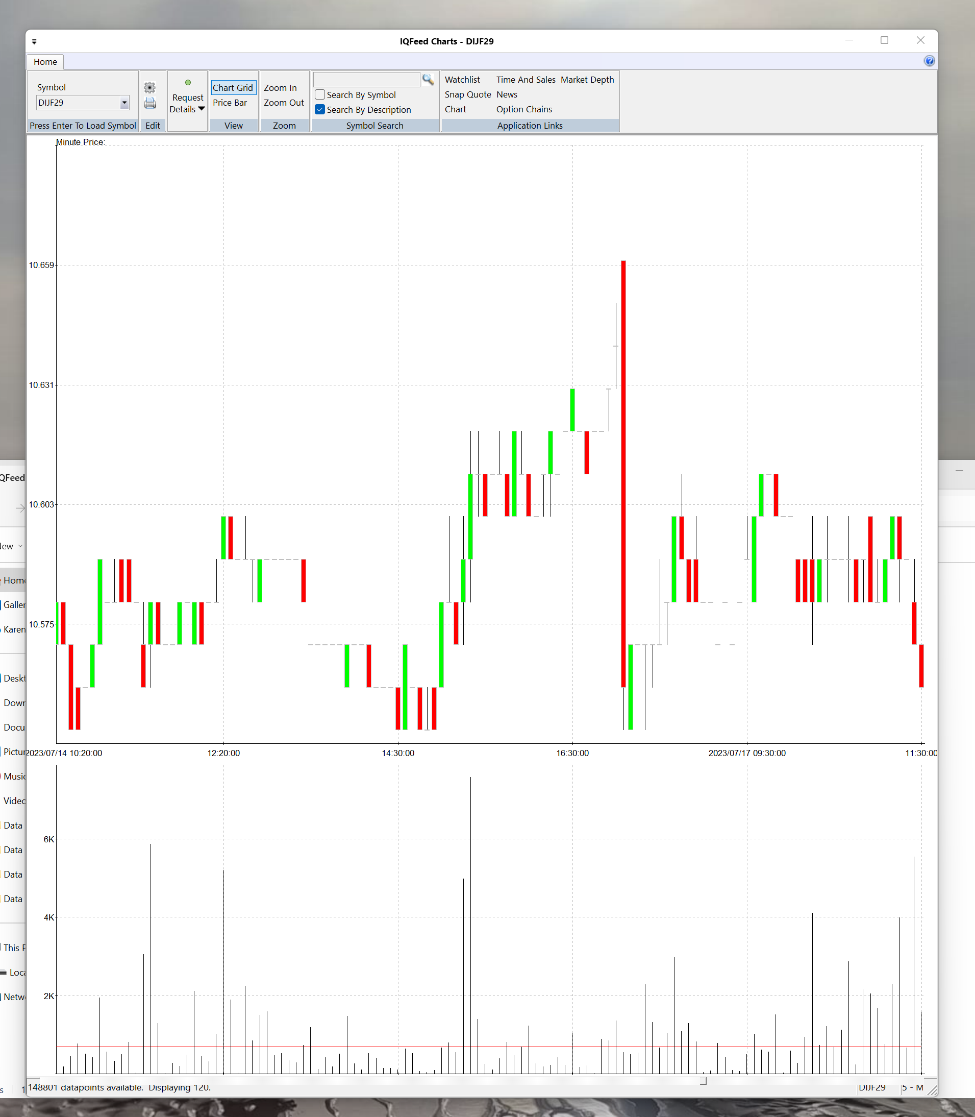

I hope someone can help as I am at my wit's end. I have a data feed with IQ data for the Brazil BMF. The data I am receiving from them clearly shows I am getting full feed. ie I can call up a basic chart on their feed and see 1-60 min bars charts 2-4 years ago. So the data is clearly coming into my PC. The issue is I cannot access this data fully using SC despite, as you will see in the screenshots, following SC rules. I can see historical data for Brazil but NOT intraday past some arbitrary date the software picks for each product.

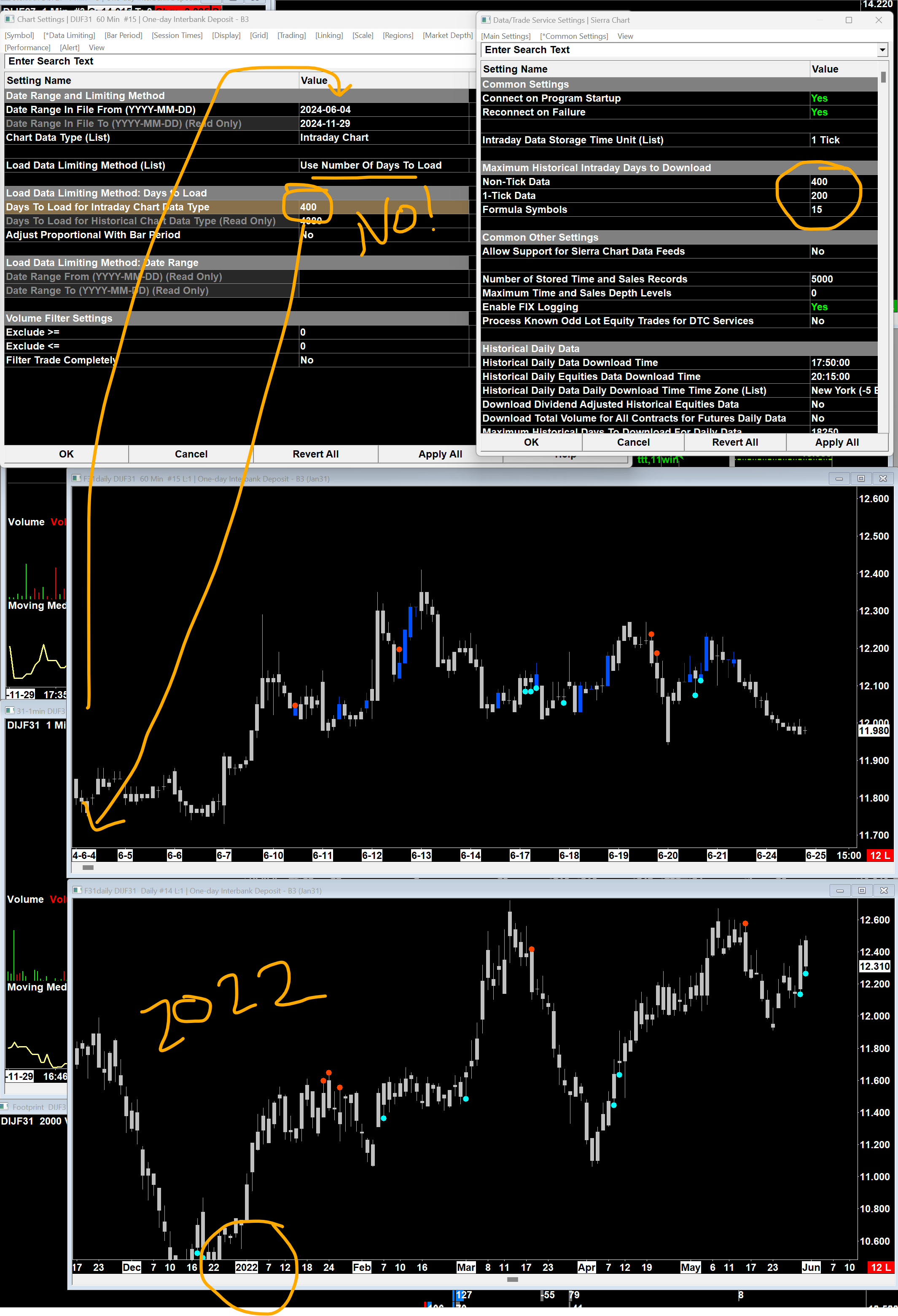

How can it be that I can see historical data going back years, but if I ask for 60min(or any min chart) it will not go back further than a few months? You see I have for the 60min chart '#of days to load' set to 400. You see in data service settings I have non-tick set to 400. I have followed the SC instructions to the letter. You can also see from my IQ chart that they are supplying 5min data going back years. So there must be some glitch that I am not getting minute data longer than some arbitrary date that SC decides. Why June 4th does it stop? I have spoken extensively with IQ, and it's obvious from the screenshot they are giving me minute data years out...
I appreciate any help or suggestions, but again I have done 'days to load', I have done the data/trade service adjustment, and SC overrides my asking for 400 days to load, and gives me date in March as a start...(see last chart uploaded). Help anyone, and THANK YOU for taking the time to read this. KK
