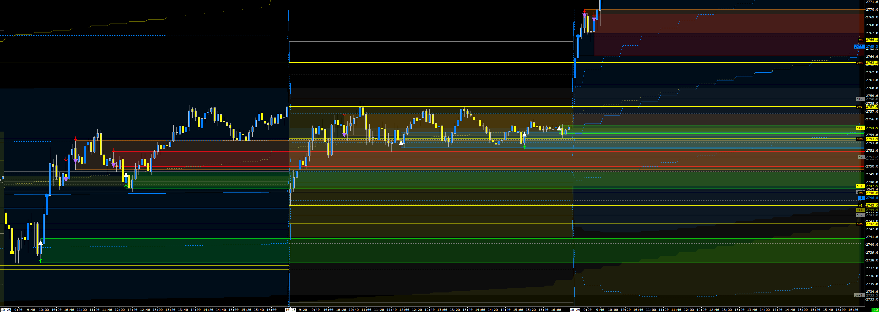

Im trying to make a custom study that draws an extending rectangles around the high-low range of the candles where the following color bar based on alert conditions are met; so a buy" rectangle would be when id25.sg1=true, (id25 being my CBBOAC) and likewise for a "sell" rectangle id26.sg1=true.
please see attached a screenshot where ive manually drawn on the rectangles around the range of the candles in which my alert conditions are met.
to clarify, i have colored rectangles green where a candle has not closed below the low of this rectangle, indicating its still an "active" area, and blue, where price has either traded below and closed below the low, OR a new alert has occurred, painting a more updated area, thus rendering the previous idle so to speak. Likewise red for active sell area and orange for idle.

imageScreenshot 2024-10-30 091347.png / V - Attached On 2024-10-30 09:14:23 UTC - Size: 81.46 KB - 347 views
