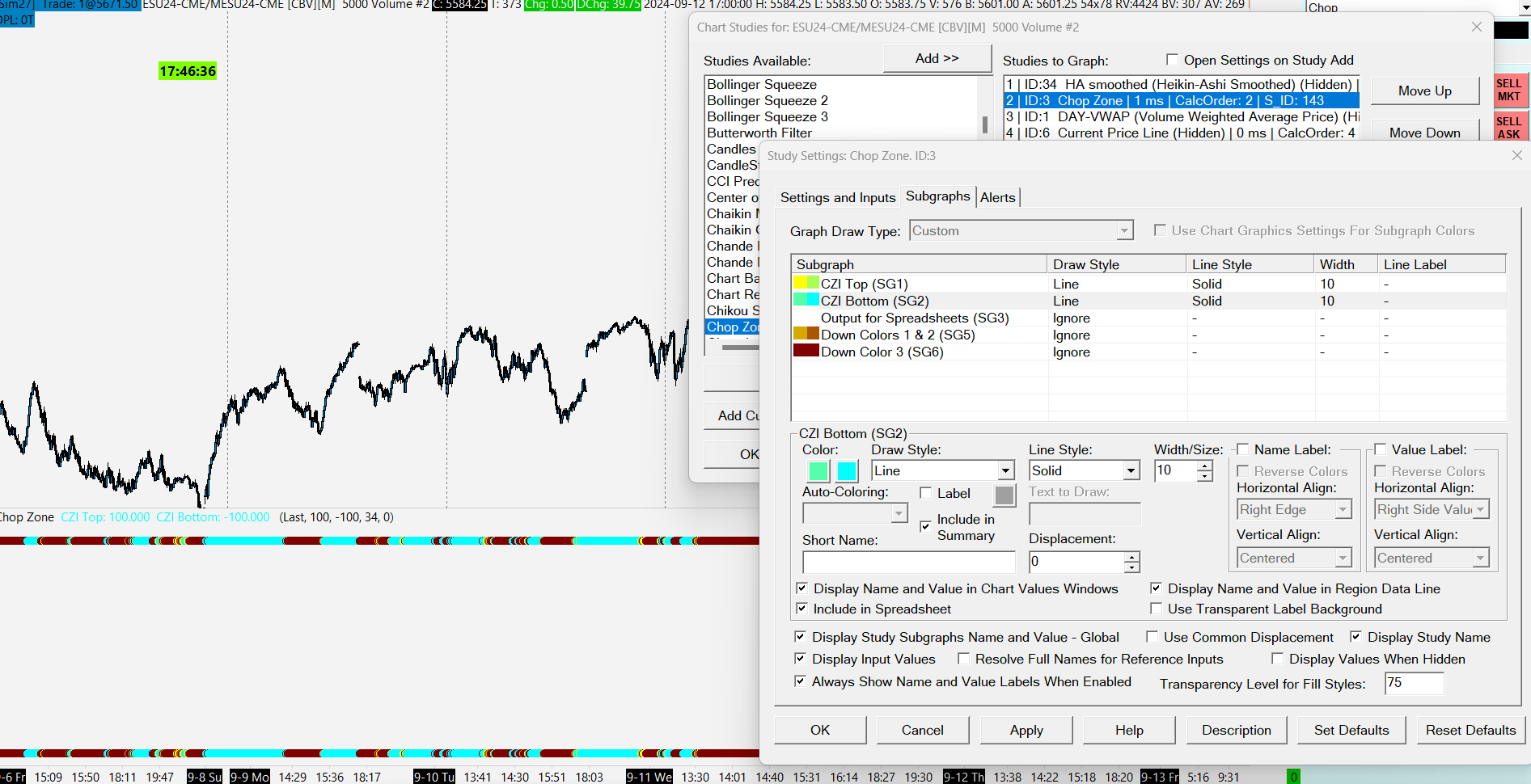

Hi, I am trying to create an alert (color bar based on alert conditions) for the Chop Zone study. I can't see a way that I can configure the code so that an alert is triggered when either of the horizontal zones turns cyan (as per the study's default settings - this appears to be the secondary color for SG2).
Also an alert for when the study turns brownish (this appears to be the default color for SG6).
I've worked with Copilot AI for ideas, but things such as =OR(ID3.SG1 == RGB(0, 255, 255), ID3.SG2 == RGB(0, 255, 255)) aren't working.
I'm doing this with an ultimate view to sim trial this on the autotrading based on alert conditions study.
Can you think of way this might be possible?
imageScreenshot 2024-09-12 184646.png / V - Attached On 2024-09-12 17:47:12 UTC - Size: 173.8 KB - 153 views
