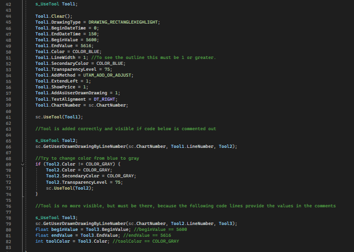

Dear Support Team,
I was inactive for a long time (about a quarter to half a year) and have now updated Sierra Chart to the current version (2670). A study I implemented back then no longer works as it should.
I have attached a simplified version of the code as an image and the code below to reproduce the error:
- I add a ChartDrawing and set "AddAsUserDrawnDrawing=1" (Line 42 to 61 in the picture)
- If the lines 69 to 74 below "sc.UseTool(Tool1);" are commented out, the tool will be displayed correctly
- If I then try to change the color (lines 69 to 74 are not commented out), the chart drawing is no longer visible
- However, the tool still needs to exist because in the code the tool can still be accessed via the LineNumber (see lines 78 to 82)
I hope you can help me and thank you in advance.
s_UseTool Tool1;
  Tool1.Clear();
  Tool1.DrawingType = DRAWING_RECTANGLEHIGHLIGHT;
  Tool1.BeginDateTime = 0;
  Tool1.EndDateTime = 150;
  Tool1.BeginValue = 5600;
  Tool1.EndValue = 5616;
  Tool1.Color = COLOR_BLUE;
  Tool1.LineWidth = 1; //To see the outline this must be 1 or greater.
  Tool1.SecondaryColor = COLOR_BLUE;
  Tool1.TransparencyLevel = 75;
  Tool1.AddMethod = UTAM_ADD_OR_ADJUST;
  Tool1.ExtendLeft = 1;
  Tool1.ShowPrice = 1;
  Tool1.AddAsUserDrawnDrawing = 1;
  Tool1.TextAlignment = DT_RIGHT;
  Tool1.ChartNumber = sc.ChartNumber;
  sc.UseTool(Tool1);
  //Tool is added correctly and visible if code below is commented out
  s_UseTool Tool2;
  sc.GetUserDrawnDrawingByLineNumber(sc.ChartNumber, Tool1.LineNumber, Tool2);
  //Try to change color from blue to gray
  if (Tool2.Color != COLOR_GRAY) {
    Tool2.Color = COLOR_GRAY;
    Tool2.SecondaryColor = COLOR_GRAY;
    Tool2.TransparencyLevel = 75;
    sc.UseTool(Tool2);
  //Tool is no more visible, but must be there, because the following code lines provide the values in the comments
  s_UseTool Tool3;
  sc.GetUserDrawnDrawingByLineNumber(sc.ChartNumber, Tool2.LineNumber, Tool3);
  float beginValue = Tool3.BeginValue; //beginValue == 5600
  float endValue = Tool3.EndValue; //endValue == 5616
  int toolColor = Tool3.Color; //toolColor == COLOR_GRAY
imageProblemAdjustingChartDrawing.PNG / V - Attached On 2024-08-28 12:51:29 UTC - Size: 86.96 KB - 150 views
