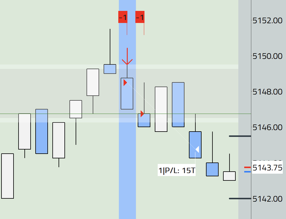

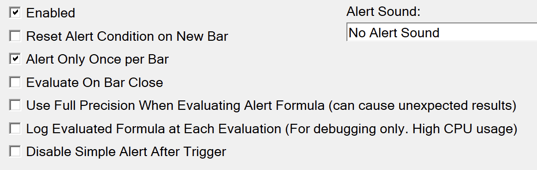

I have a strategy I'm trying to test to verify that it's functioning correctly and have come into a couple things about behavior which I will describe. I'm sure the answers are somewhere on the site's documentation, I went looking but haven't found anything yet. To preface the questions, I have attached screenshots with the settings that were used while performing the test.
1. Using Standard Replay as the replay type, my signal will evaluate on open (which is what I want) but the signal also appears to fire either on the close of that bar, or the open of the following one, while I have "Alert only once per bar" checked. If there was a secondary signal, the background should also highlight as it does with the original signal. See screenshots.
2. During the replay test, the first position opened with 1 contract and actually used the ATM specifications I defined on the Trade Window for Chart for a bracket order for stop/target (also what I wanted, great). Then between the time the first entry happened & the second (undesired), the bracket order disappeared completely. Is it acceptable to use a twconfig to manage entries and exits when using the Spreadsheet System for Trading or should I be specifying everything fastidiously in the spreadsheet (eg: I didn't even have J26 Order Quantity specified)? Not sure why the ATM would disappear mid-bar.
