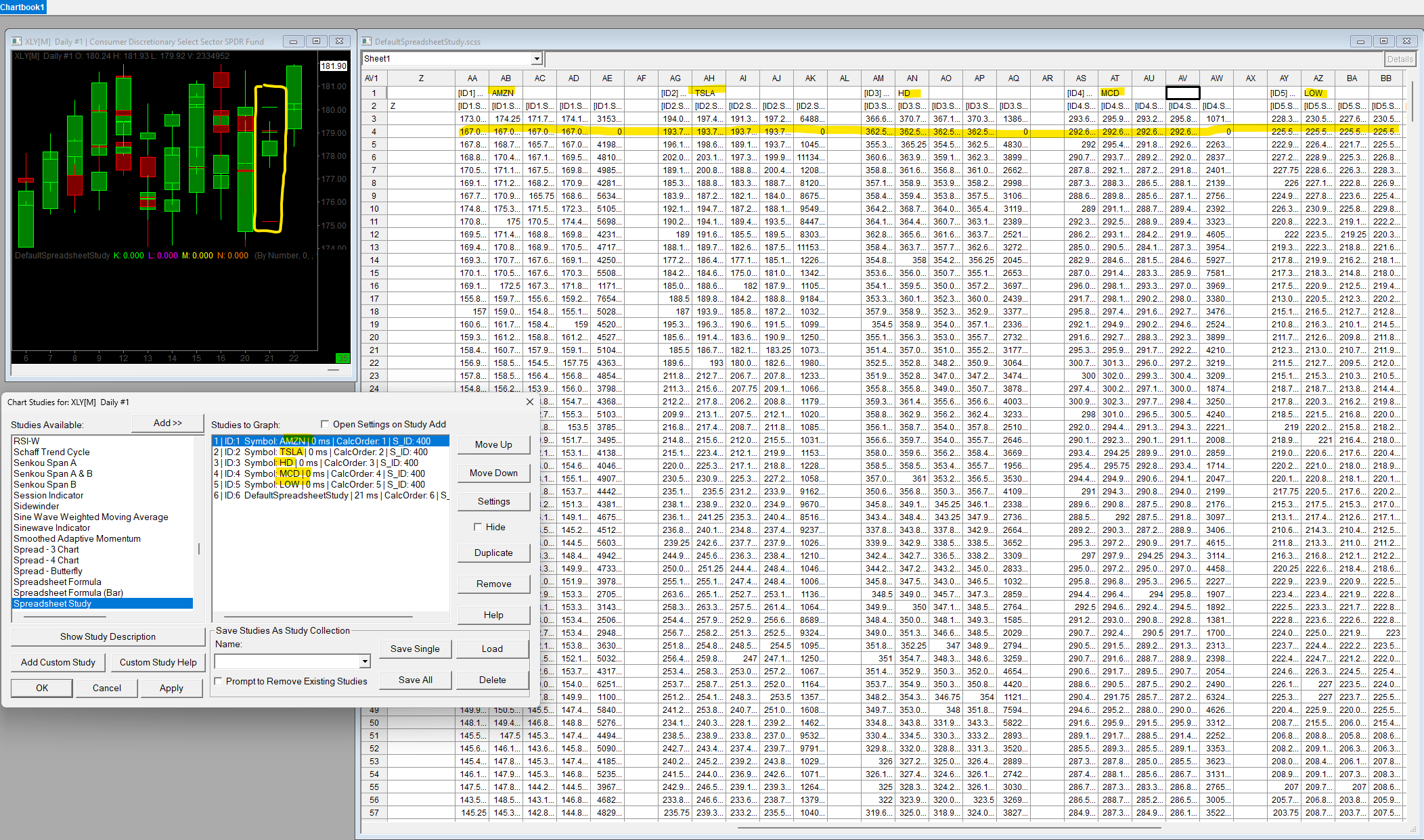

Thanks for your reply.
I closed all Chartbooks.
Open and new Daily chart of XLY. (Daily #1)
Used 5 times Add Additional Symbol Study in (Daily #1)
Then created Spreadsheet Study in (Daily #1)
And as you can see I have the same issue, "row 4" doesn't update OHLC data, even in the chart there is no candle.
* See 2024-02-22 attachment
Trying to find the solution for this issue, I found that ONLY when I manually go to Find Symbol, and Open Historical Chart of any of those 5 symbols, at the moment it finishes downloading the Historical chart (blue message), then the data is overwritten on row 4 in the Spreadsheet Study.
*See 2024-02-22 2 attachment
Is like when I manually load the historical chart is pushing to update row 4.
Thanks for your feedback.
image2024-02-22.png / V - Attached On 2024-02-22 18:48:50 UTC - Size: 295.15 KB - 202 views
image2024-02-22 (2).png / V - Attached On 2024-02-22 18:48:56 UTC - Size: 365.19 KB - 138 views
