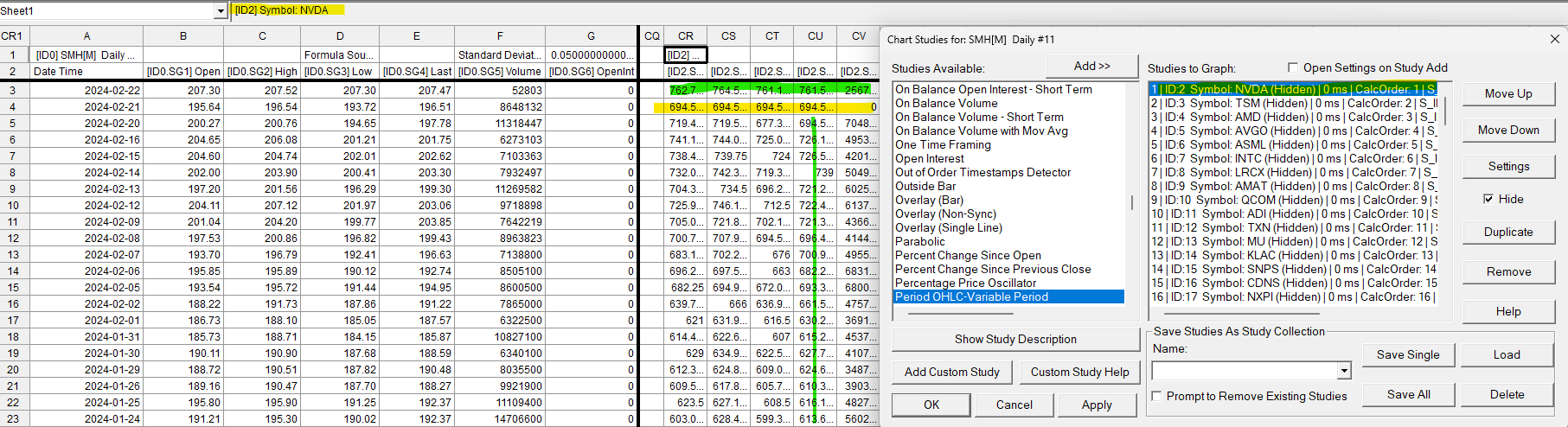

Post From: Spreadsheet study not loading OHLC on row 4 for Add Additional Symbols
[2024-02-22 13:09:10]
Poblano Trading Capital - Posts: 18
Thank you for your link and information.
I made sure calculation precedence and order are respected, but the most remarkable of my issue is that the OHLC data doesn't update ONLY for yesterday's data ( row 4 ) for all Add Additional Symbol studies, but for the rest of the days is perfectly fine.
So the issue is not that is not updating ( row 3 and 5 to end are ok ), is just the OHLC data on row 4 the one that has the issue.
There must be something else that I can check, why the row OHCL data for line 4 is not updating for all Add Additional Symbol studies?
Thanks for your support.
image2024-02-22.png / V - Attached On 2024-02-22 12:59:01 UTC - Size: 149.47 KB - 198 views
