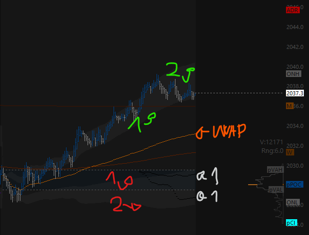

- See picture attached, 1 and 2 with green and red are standard deviations of FSVWAP (Full session VWAP from 17:00 to 16:00)
- 1 and 2 in white are the 1st standard deviations of VWAP from RTH (08:00 to 13:30h). I am using a study supgraph to extract that from another chart (Trigger RTH on the chartbook) with RTH times.
The study is working properly on RTH, but after the RTH session ends it show a wrong calculation until the next RTH open.
Is there any way I could add a line stop time or similar to this indicator so it does't show a wrong calculation on my charts?
Thank you again
