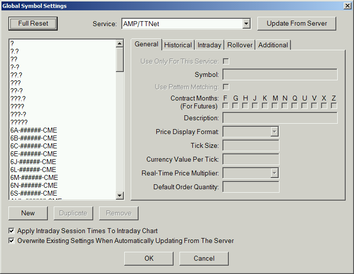

You must perform a full reset of the symbol settings when you change the exchange portion of the symbols to CBOT.
Before I made any changes I confirmed that both the CME and CBOT suffix symbol names were available in my Global Symbol Settings file.
As I noted in post #2 and post #5, I am having trouble performing a Full Reset of the symbol settings. When I press the "Full Reset" button on the Global Symbol Settings window, I receive a corrupted XML file. Attached are images showing that window before and after pressing the "Full Reset" button. The results are the same regardless of whether the "Overwrite Existing Settings . . ." box is checked or not. The results are the same regardless of whether I am connected to the Data Feed or not.
As you can see from the attached images, when I perform a Full Reset I lose all the market data symbols from $AXFI through $ZOC. I need some of those market data symbols for some of my charts. You can judge the size of the XML file from the size of the scroll bar button in the attached images.
I just now noticed that the corruption with all the question marks is already in the file before I perform a Full Reset. Before performing a Full Reset the question marks show up between the market data symbols and the futures symbols.
What can I do to get a full list of symbols with a Full Reset?
