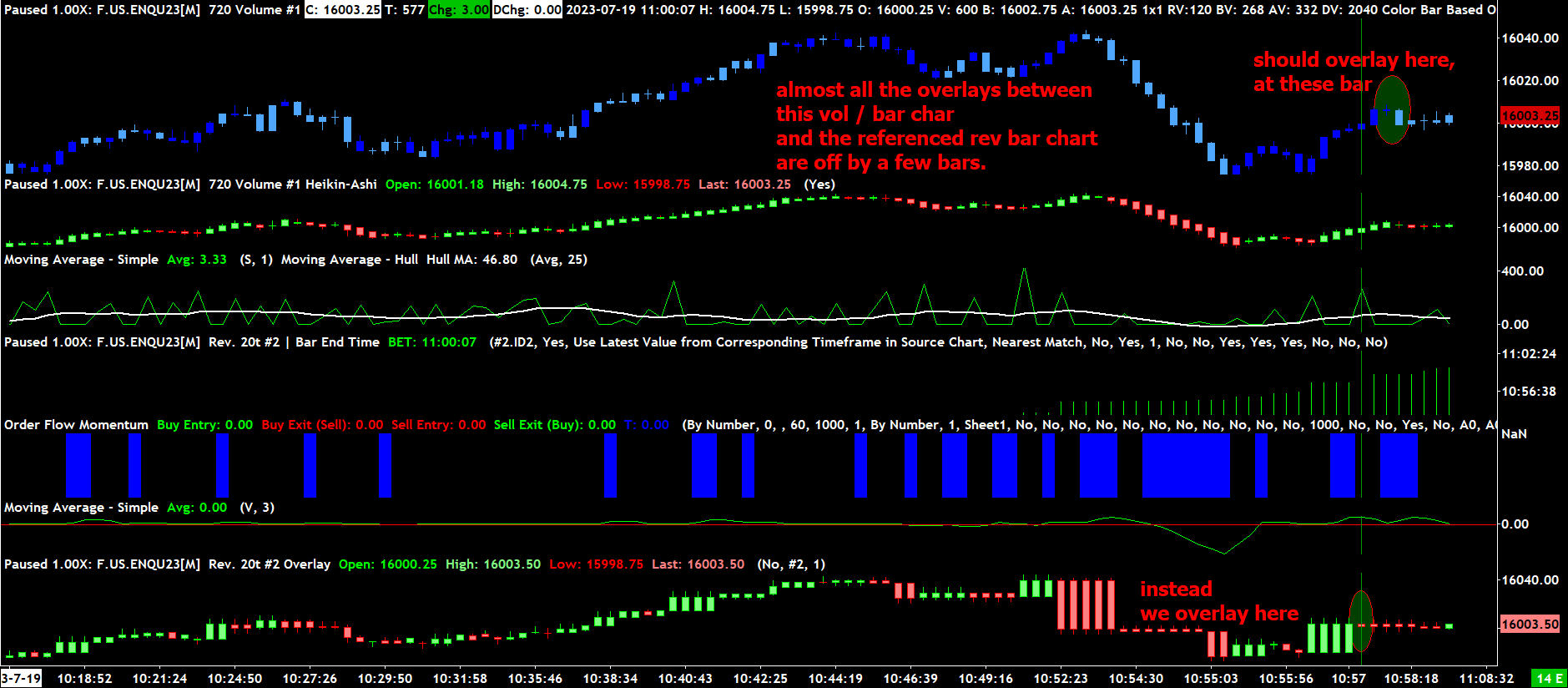

Hey Sierra, I am trying to load and count the number of bars (in a volume per bar chart), which happen during a reversal tick chart bar.
Inside a single reversal bar, I might have multiple volume bars (inside the timeframe of a single reversal bar). Sometimes I might have 1 or less.
However, the Price overlay does not appear to be using timestamps to overlay the price charts. I have tried using Study price overlay, and Overlay studies.
I like the idea I am working with, maybe it could be a momentum type study. I am replicating a study that uses this method.
Although, this study requires the overlay to be as close to the timestamp as possible. So I might not be able to use this overlay method.
Is there a better way to configure the charts?
-LD
I've included a snapshot below
https://www.sierrachart.com/image.php?Image=1690738971496.png
(A new bar on the Reversal Tick chart, begins at 10:57:52. But the Overlay studies mark the reversal at 10:57:17, two bars before it should.
Two bars later, there is a new bar at 10:57:45, and three later is 10:57:58). This happens nearly every bar. they don't seem to line up like I thought they should.)
