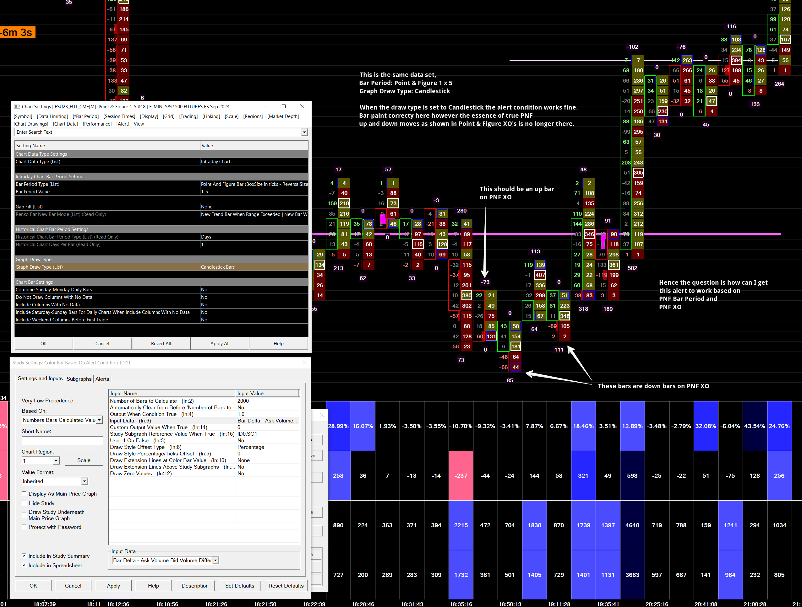

Hi John,
Thank you for your time and reply.
Please see 2 pics attached.
Point & Figure charts show the up and down legs as marked with X+O's
Yes that is a numbers chart with settings:
Bar Period Type: Point And Figure Bar
Bar Period Value: 1 -5
Graph Draw Type: Point and Figure XO
The alert condition does not work properly when
PS>> It does work when Graph Draw Type = Candlesticks, however this does not give a true representation of up and down legs as per PNF XO (1-5).
Hence the question is:
How can I get the alert to work based on
PNF Bar Period and PNF XO
What does the Alert need to be modified to for PNF XO Chart to show the mentioned divergences.
Thanks again,
cheers
imageAlerts on PNFA set to PNFXO.png / V - Attached On 2023-07-20 01:35:14 UTC - Size: 372.61 KB - 332 views
imageAlerts on PNFB set to Candlesticks.png / V - Attached On 2023-07-20 01:35:32 UTC - Size: 379.75 KB - 317 views
