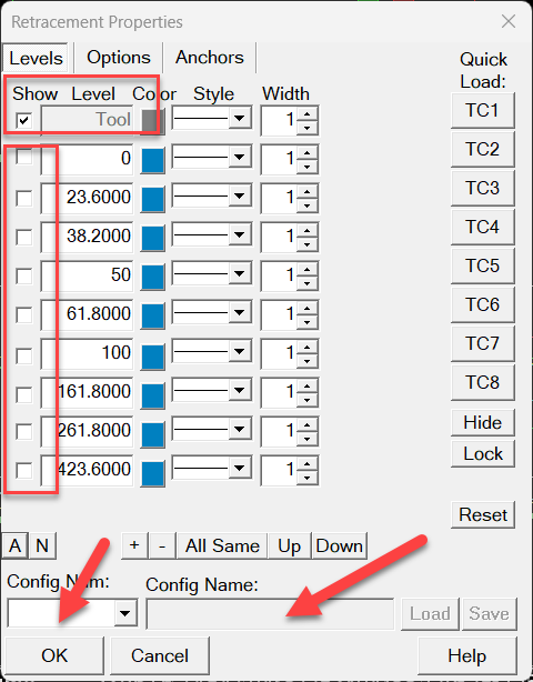

Soooo.... As with most things related to SC, if you think about it and learn enough about SC, there is usually a way to accomplish what you want. After digging, and trying various thought processes, I did come up with a way to do something similar to what you want to do. Change the Price levels tool from calculating % to ratios. My goal, was a fan that was based on 3 price/bar points. SC Gann fan tool only uses 2 points. Here is what I did to accomplish my goal. It is a hack, but I get what I want. You would do a similar project starting with the price replacement tool.
1 - Set up a configuration of the tool with the numbers you want for the levels and delete the rest of them. Also set the line values, color, style, etc.
2 - K E Y -- uncheck ALL of the levels -> EXCEPT <- the first one - tool. You always need this to be able to see the original drawing to be able to move change it. I made it a different color and line type to be able to see it easily.

imageCustom tool.png / V - Attached On 2023-06-19 13:18:59 UTC - Size: 43.4 KB - 274 views
