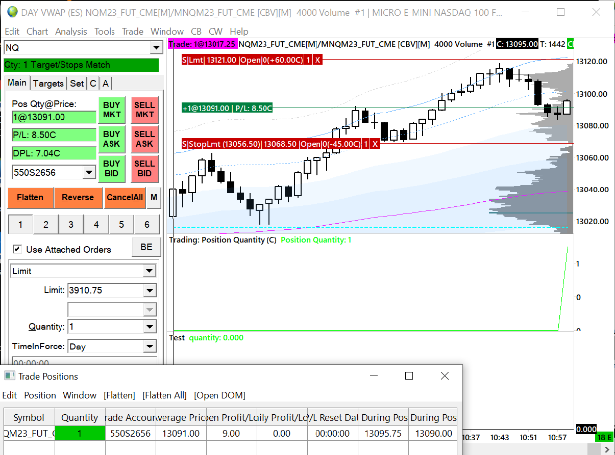

Post From: Position quantity with GetTradePosition is 0 on Teton Order Routing
[2023-04-27 15:12:12]
glacialspring - Posts: 27
The trade positions window shows the data correctly. I also tried the Trading: Position Quantity study and that is also working correctly. I tried writing a barebones test (below) of the GetTradePosition function and it was not working correctly for this account. I've attached a screenshot, sorry haven't had time to read your screenshot guidelines but I think it is clear enough.
I'll go ahead and check all of the values of the position data structure now.

s_SCPositionData pos;
if (sc.GetTradePosition(pos) == SCTRADING_ORDER_ERROR) {
sc.AddMessageToLog("error getting position", 1);
return;
for (int i = sc.UpdateStartIndex; i < sc.ArraySize-1; i++) {
sgPositionQuantity[i] = pos.PositionQuantity;
imagequantitytest.png / V - Attached On 2023-04-27 15:04:16 UTC - Size: 76.86 KB - 325 views
