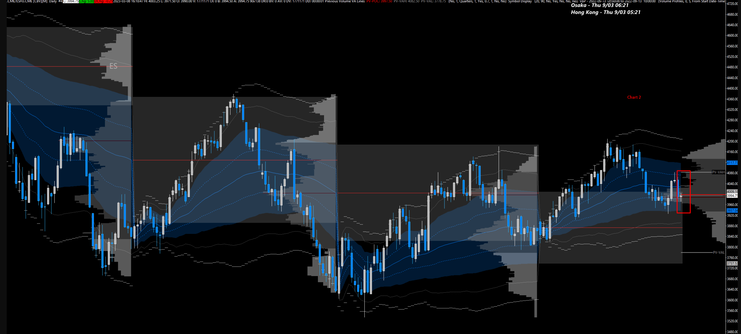

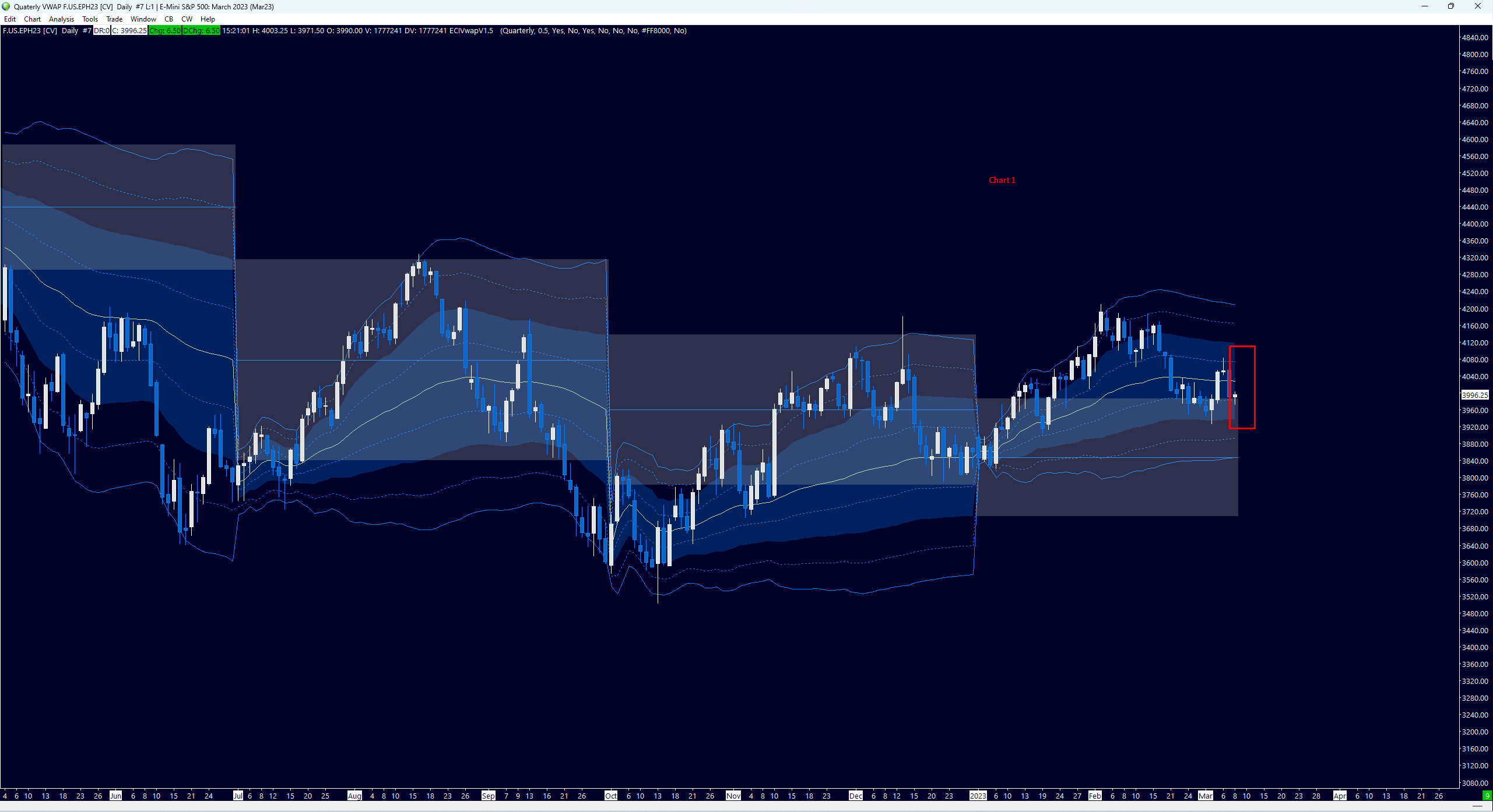

Hi guys, I have come across an interesting issue with one of my colleagues and I comparing charts. - My Current Sierra is 2382 with CQG data feed.
I have attached two charts - Chart 1 = My chart on a historical Daily chart with ECIVWAP study set to a Quarterly time frame
Chart 2 = Colleagues chart on a historical daily chart with ECIVWAP study set tp a quarterly time frame
The problem, is chart 1 shows the current daily candle trading ABOVE the Grey box (prior quarter value extension), And the Chart 2 shows the daily candle BELOW the same price level.
There is an extremely important difference here which can completely change or influence a trading decision.
Can you please clarify what is going on here???
Also, bring this chart down to an intra day 240 min chart. I cannot get the chart to go back far enough historically to show the full previous quarter for reference. Can you please guide me on how to do this???
imageChart 1.png / V - Attached On 2023-03-08 21:22:30 UTC - Size: 141.43 KB - 173 views
