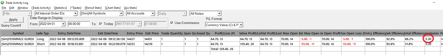

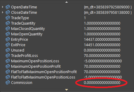

I'm trying to get some trade-information into an s_ACSTrade structure by using the function GetTradeListEntry() as soon as the trade has been closed.
The structure seems to be filled completely except for the field "commission".
Please see the two screenshots attached:
TradeActivityLog.png: I marked a trade in the trading-log showing that the commission is shown there - that's why I assume everything is set right from a SierraChart point of view
Debug.png: this screeenshot shows the debug-window of MS Visual Studio showing the s_ACSTrade-structure after calling GetTradeListEntry(). All fields make sense except the one for the commission.
