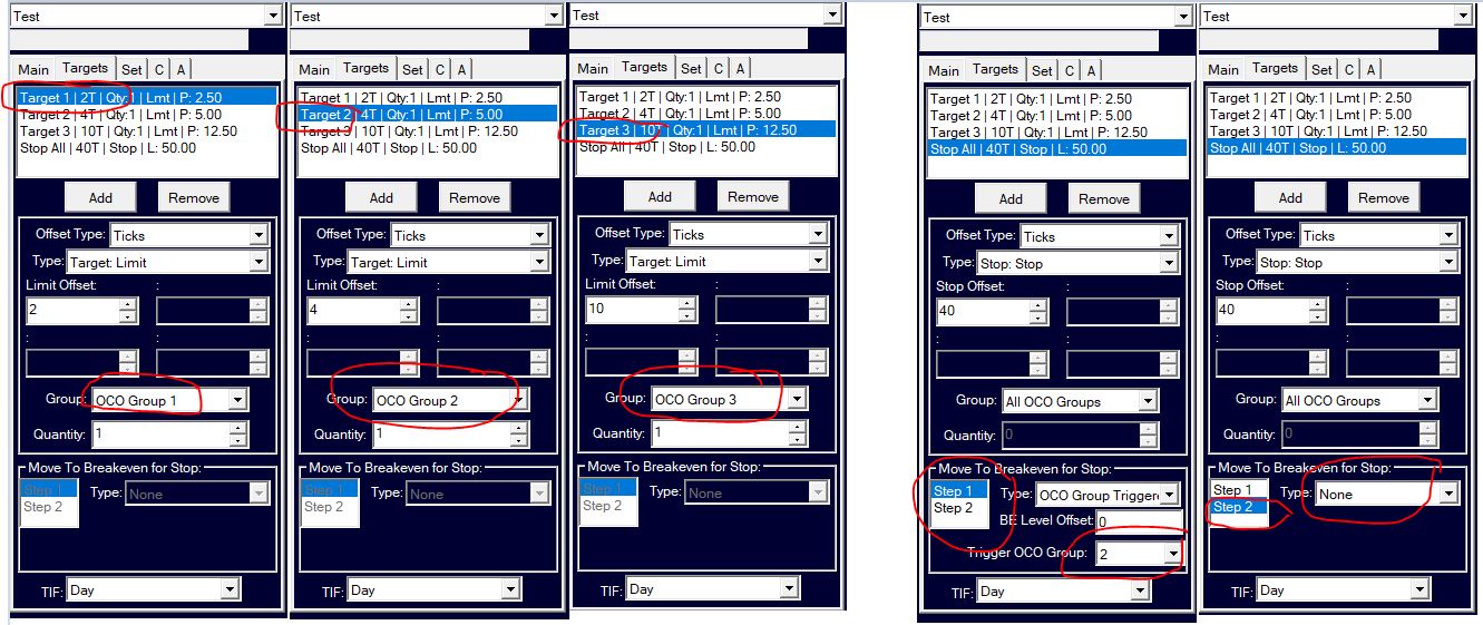

Hello John,
Thanks for taking the time to test it out. Yes, OCO Group 2 is correctly set and nothing is Step #2 either. If it's working for you then I am not sure what's wrong on my end. I also tried "Offset in Ticks Triggered" as the type and that works fine. But with that, if I use the same number of ticks as target 2, it might touch the price and move the stop, but the target 2 order might not have been filled yet. I could use target 2 + 1 tick to ensure that it's filled, but I've seen target 2 get filled, but the price would come back right from there as well. The OCO Group Triggered would be the most effective way if I could get it to work.
I've attached another picture to show you the entire setting. Let me know if you want me to test it another way.
Thanks.
