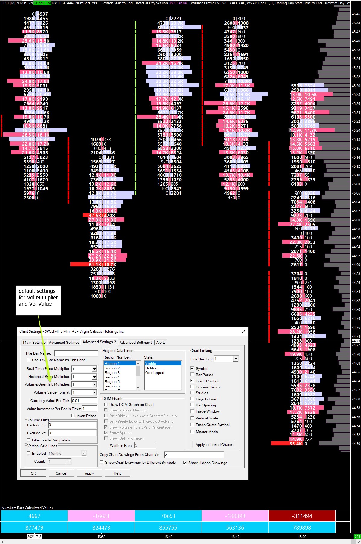

Can you please give us a screenshot of what you are seeing and/or trying to do?
spce_default.jpg - Here is a current 5min chart of SPCE, displaying Number Bars instead of candles. I've reset all volume settings to default.
To use an easy to spot example, you see the 35.4K in red on the bid at the very bottom of the last bar? I would like to format this to display `35` or `35.4`. The 14.9K bid I'd like to display `15` or `14.9`, the 11.6K as `12` or `11.6`, the 2707 as `3` or `2.7`, etc... i.e. I want to display one thousand shares as a `1`. 10K shares would be `10`, and 100K shares to display as `100`, etc.
spce_vol_mult_001.jpg - If I set the Volume/Open Int. Multiplier to 0.001, I get the numbers to display in the thousands like I want, but the values are inaccurate due to the rounding issue mentioned in the initial post. This setting is too inaccurate for my needs. Screenshot of this attached as well. In an ideal world, this is how I want the numbers to be displayed, but with more accuracy than this setting can provide. Is there a different way to achieve this display but with more accuracy?
spce_vol_mult_01_vol_value_pt1.jpg - This screenshot shows a Vol Multiplier of 0.01 and Vol Value Format of 0.1, which gives the Number Bars values in thousands. 24.2 represents 24,200 shares. That is the display format I want.
However, down below on the Number Bars Calculated Values, the display values are in a different format. The Delta 705 represents 70,500 shares. I want it to display as `70.5`. The Total Vol of 8567 represents 856,700 shares. I want it to display as `856.7` or even just `857`.
Is there a way to achieve the above?
