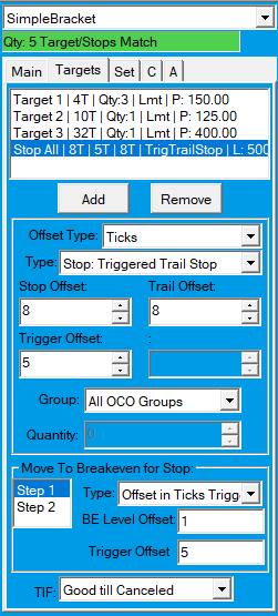

New to SC and trying to figure out how to setup the following Attached/OCO automation to happen when I place an order. I am going through the help materials, but am having difficulty figuring out how to get this logic into the Targets tab.
Trade logic:
1. Buy/Sell STOP xx amount of lots
2. Stop Market Stop Loss at 8 ticks and close out all lots if hit
3. Profit Target #1 at 4 ticks, when hit close out 50% of lots; and Move Stop Loss to BE+1 tick for remaining lots
4. Profit Target #2 at 8 ticks, when hit close out 50% of remaining lots, create Trailing Stop Loss of 6 ticks (not sure how this effects original Stop Loss).
5. Profit Target #3 at 20 ticks, when hit close out 100% of remaining lots.
Essentially trying to get 4 ticks profit on 50% of lots, with a SL protecting 100% of the lots, and then have one runner, and then a second runner leg.
If we cannot use % of lots to buy/sell logic, that is fine, I can use a fixed number of lots for each.
The area I am having particular difficulty with is figuring out how to move the original Stop Loss that is set with the order to become a trailing stop loss further into the trade logic described above. It is not clear to me if I should be attempting this using a 'Single Common Stop' that has some 'Move to Breakeven for Stop' logic, or using a different 'Type' of Stop altogether.
The attached image is my attempt at this (minus the percentage to close out as described above).
Any help would be greatly appreciated!
