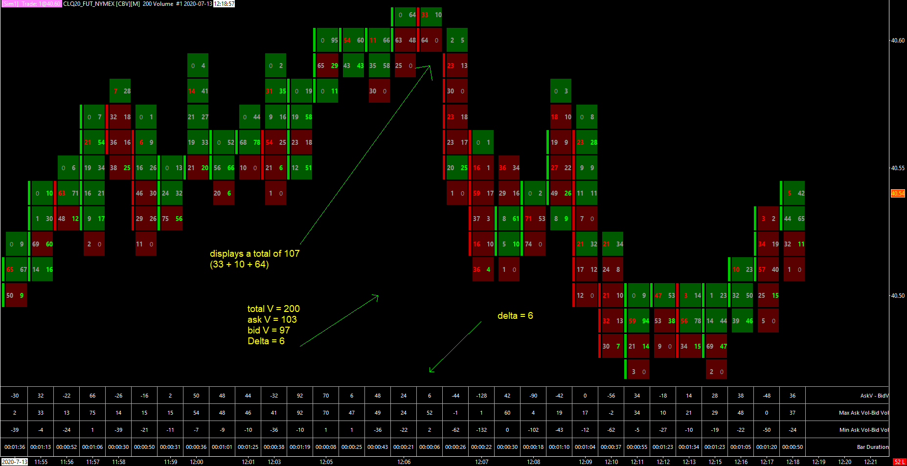

Below is a screenshot where the total for the number bar equals 107, but the chart values shows a total volume = 200, with ask = 103 and bid V = 97 for delta = 6.
The number bar is not consistent with the actual volume. This bar is from today at 12:06:40 EST

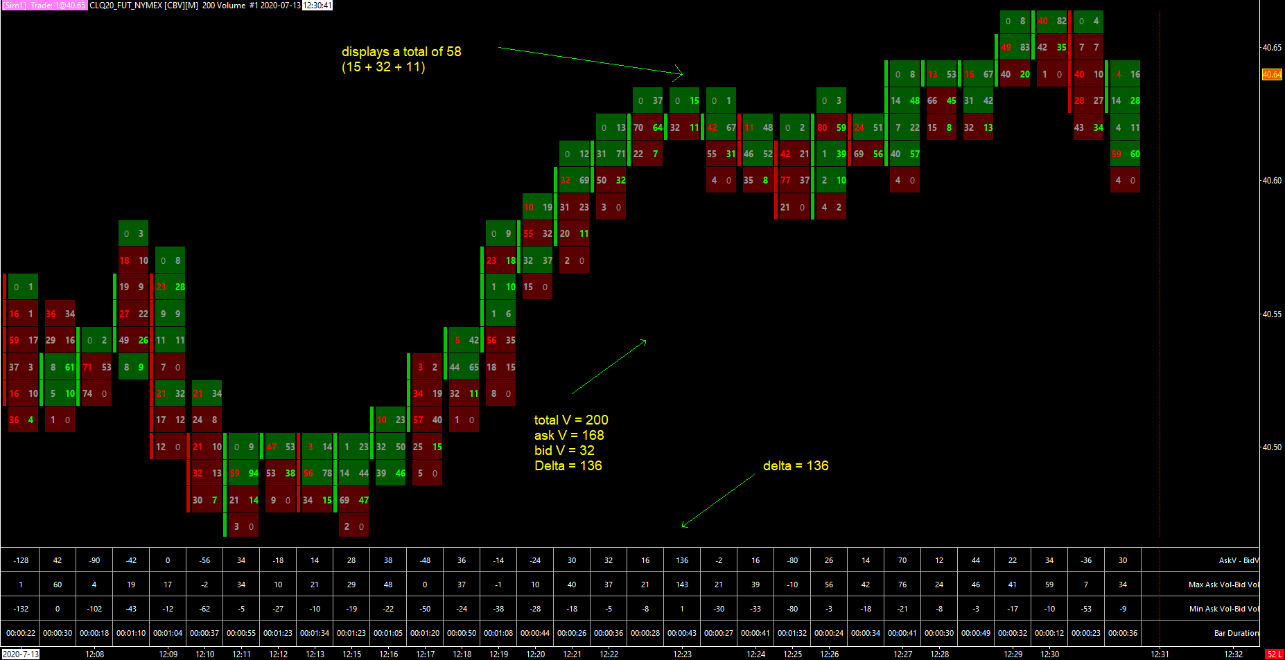

Below is another screenshot where the total for the number bar equals 58, but the chart values shows a total volume = 200, with ask = 168 and bid V = 32 for delta = 136.
This bar is from today at 12:23:09 EST
