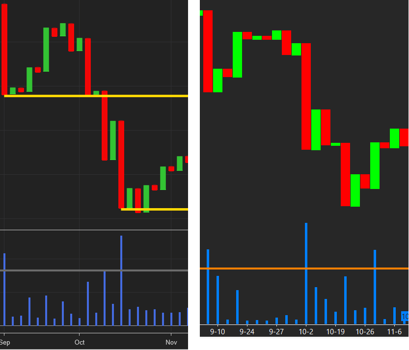

I´ve been testing a bit more. I managed to fix it in the 60 minutes P&F chart, you needed to set the start and end time (session times) from 8:00 to 22:00 as it was by default in NT for that symbol. Even the volumes are exactly the same.
Box Size: 2
Reversal Size: 3
Box Size percentage: 1
Set to Yes only: "Ignore Last Bar Until Completed", "Calculate Only Using Close Prices"
However, setting the session time didn´t completely help for the daily P&F chart unfortunately. It´s similar but not the same, I believe it has to be to another parameter that they are using to calculate things.
If you would have any further ideas please share!!
I´m attaching another picture of a small time frame, you can see how NT is collapsing some days in one column, and in SC that is done for another different bars; this way the volume looks different for different bars.
THANKS!
