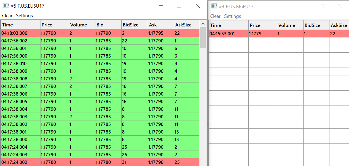

This morning I noticed that trades coming in for M6E were being given early time stamps not consistent with simultaneous 6E data that did not have this problem.
In fig 1, the single M6E trade occurred at the same time as the 6E trades on the left, but was given a time stamp more than two minutes earlier. In fig 2, a second M6E trade occurred about a minute later, but was time stamped with the same incorrect value.
