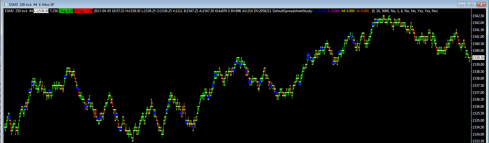

Here's the best I could come up with. The speed seems to be limited to the value I mentioned above which means below a certain bar threshold you'll get more signals than you want since SierraChart isn't able to calculate units of time less than what I believe is one second (represented by 0.0000115740695036948 in the spreadsheets).
You can see the attached 250 tick chart starts to show too many signals, and any faster chart (meaning less than 250 ticks) is going to show even more unless we can use a lower value than 1 second.
