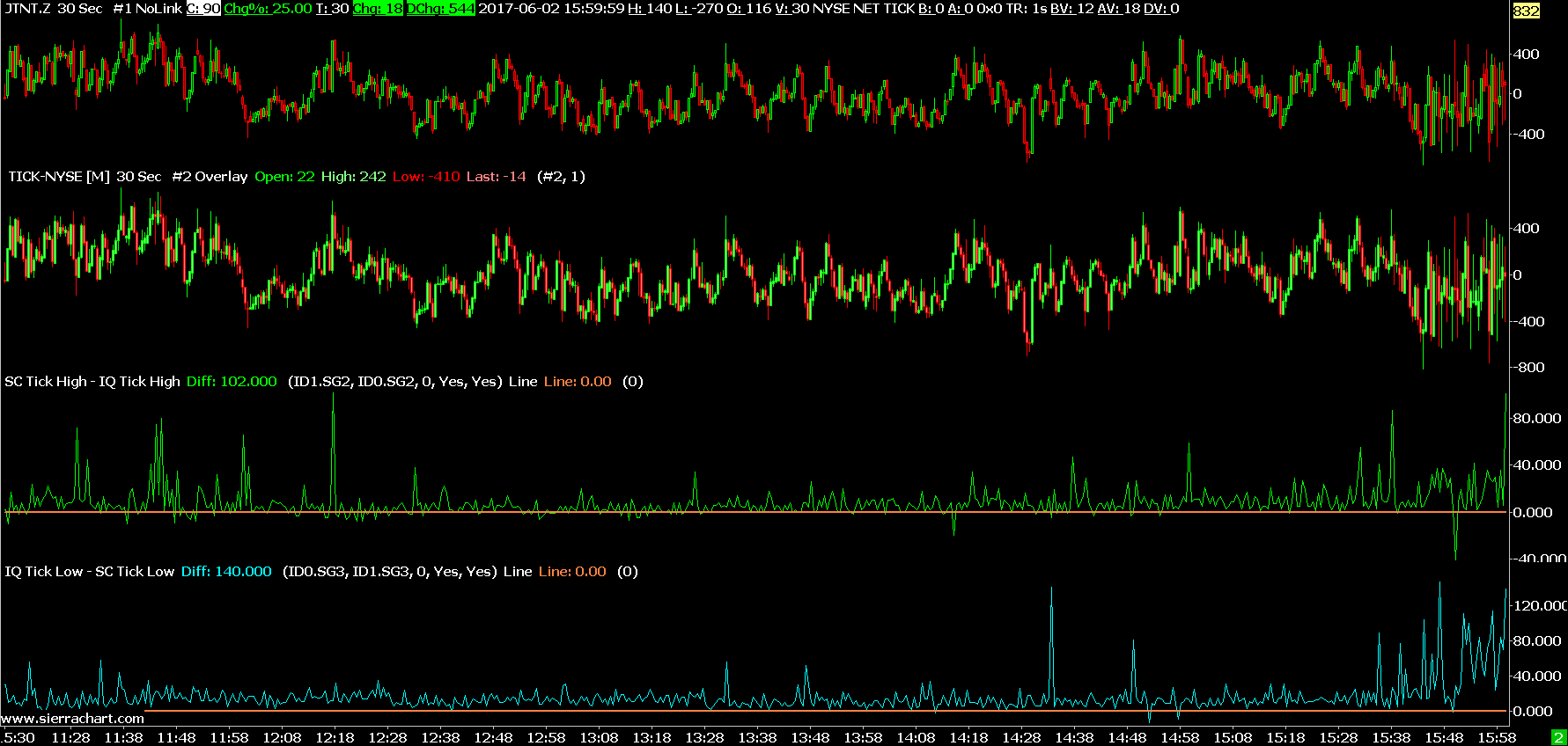

As we were comparing the TICK today to the IQ Feed calculated TICK (JTNT.Z), we noticed it is very clear that Sierra Chart provides faster updating, up to six times a second, and provides a higher highs and lower lows.
Here is the comparison for 2017-06-02:
http://www.sierrachart.com/image.php?Image=1496442065719.png
The two graphs at the bottom, show that the high extremes of the Sierra Chart calculated TICK are higher than this TICK from the other supplier. And the low extremes are lower with the Sierra Chart calculated TICK.
Also as we were monitoring the values in real-time, they basically literally matched, other than the extremes which Sierra Chart was doing a much better job of.
The reason Sierra Chart we believe is providing higher highs and lower lows for TICK is because SC calculates this data using each and every single tick from the entire NYSE and records the maximum and minimum extremes for every quarter second and transmits those as needed.
