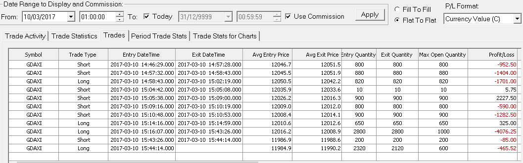

I'm doing some tests with the LMAX API, so I enter multiple trades on the web site, some using the API, and also using Sierra DTC.
Today again I managed to make my Sierra local fills and the LMAX server off sync, i.e. the local Sierra thinks I'm long 20 contracts, the LMAX server shows I'm flat.
To be sure I emptied the fill log and reloaded, same thing.

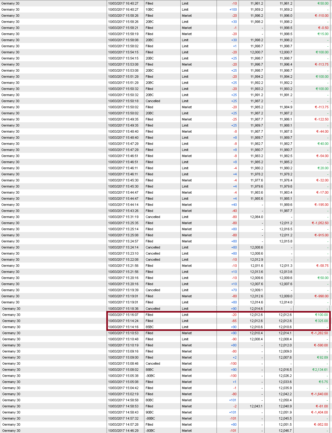

Here are the logs, you can see that all the trades PnL is in sync up to 15:14, then all is off.
I nailed it down to one trade , here's what I found, hope you can have a look.
PS : on the LMAX log, 85BC Limit +90 means 90 long limit order, with only a 85 fill (partial)
imagetradesdtc.PNG / V - Attached On 2017-03-10 16:40:18 UTC - Size: 26.76 KB - 480 views
imagedtclog.png / V - Attached On 2017-03-10 16:40:24 UTC - Size: 119.62 KB - 490 views
imagelmaxlog.png / V - Attached On 2017-03-10 16:40:29 UTC - Size: 97.43 KB - 497 views
