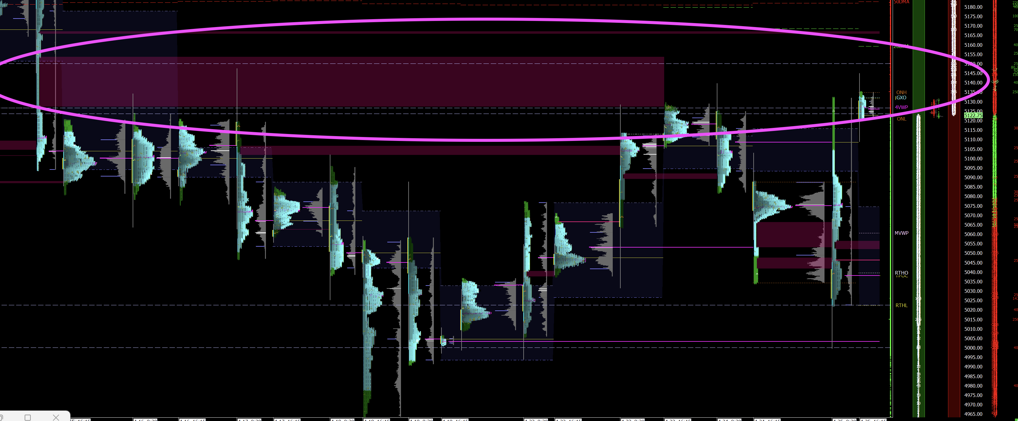

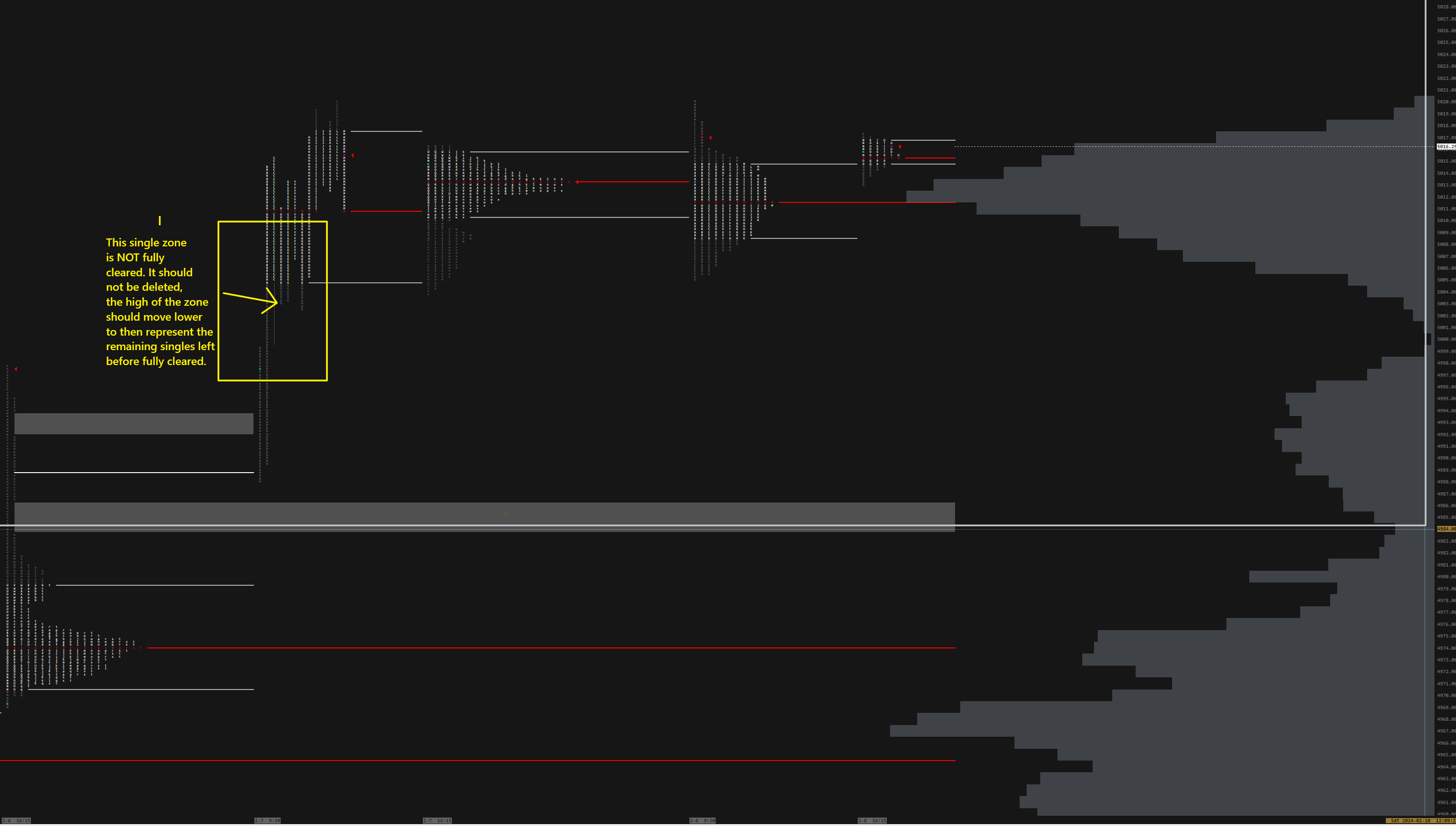

@ sierra dev team, the singles should not be deleted fully until the entire zone is back filled with new letters. See example, there is a single zone that was launched, and price started to move back down into it, but fell short of completely moving through the single zone. the high of the singles zone should move down to represent the remaining singles to fill until price moves down to the lowest single print. can this be fixed? That zone is technically still valid. Notice before in the profile prior price moves completely through the zone, and it is cut right there where it clears as it should be.
Image link - https://www.sierrachart.com/Download.php?Folder=SupportBoard&download=95505
thats with price split out , below is link with profile normal, you can clearly see the large single zone that still exists, but no zone extending like the rest.
https://www.sierrachart.com/image.php?Image=1707440542445.png
Date Time Of Last Edit: 2024-02-09 01:03:21
imagesierra singles .png / V - Attached On 2024-02-09 00:52:39 UTC - Size: 206.84 KB - 1132 views

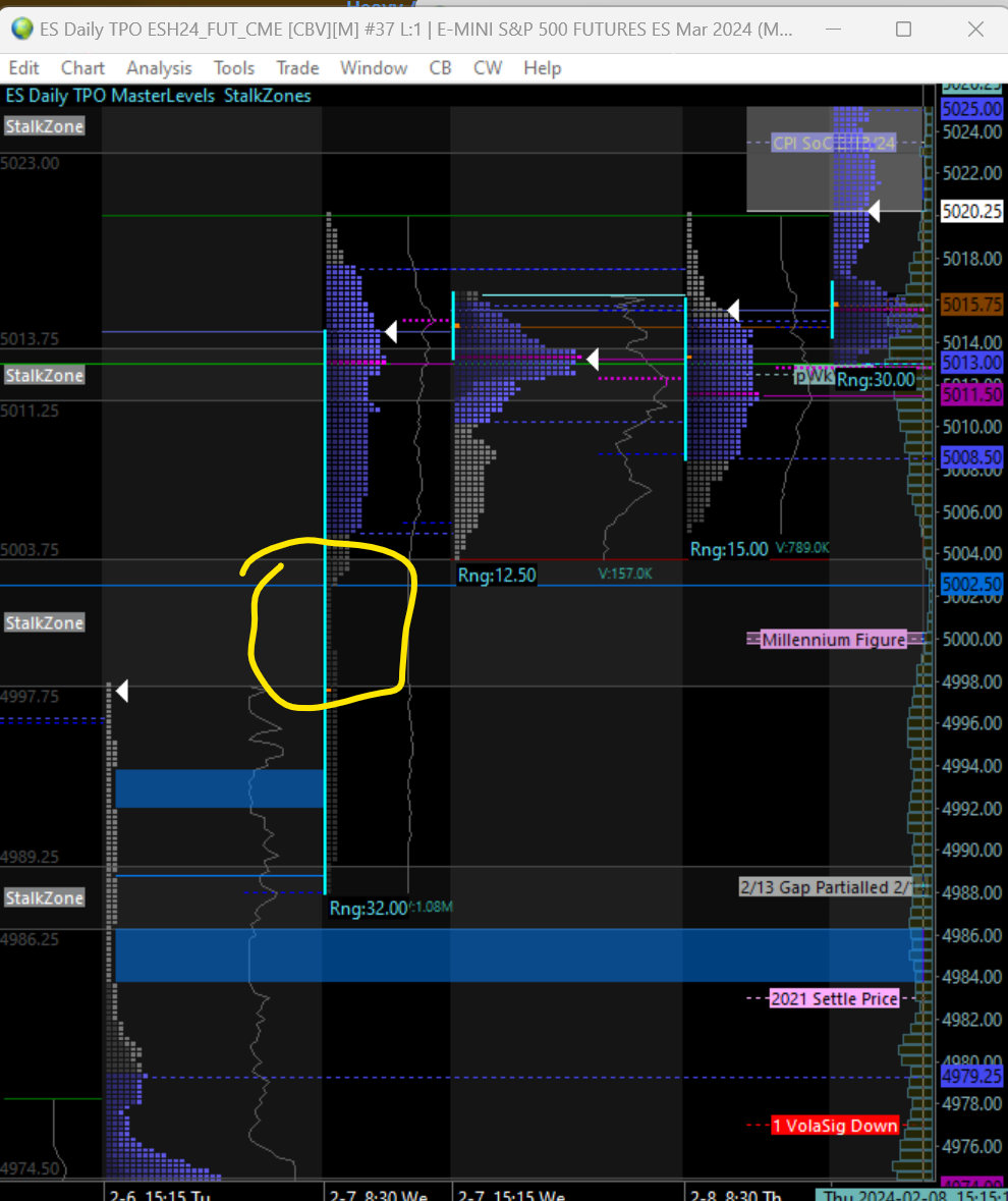

[2024-02-12 17:45:30]
jmftattoo - Posts: 106

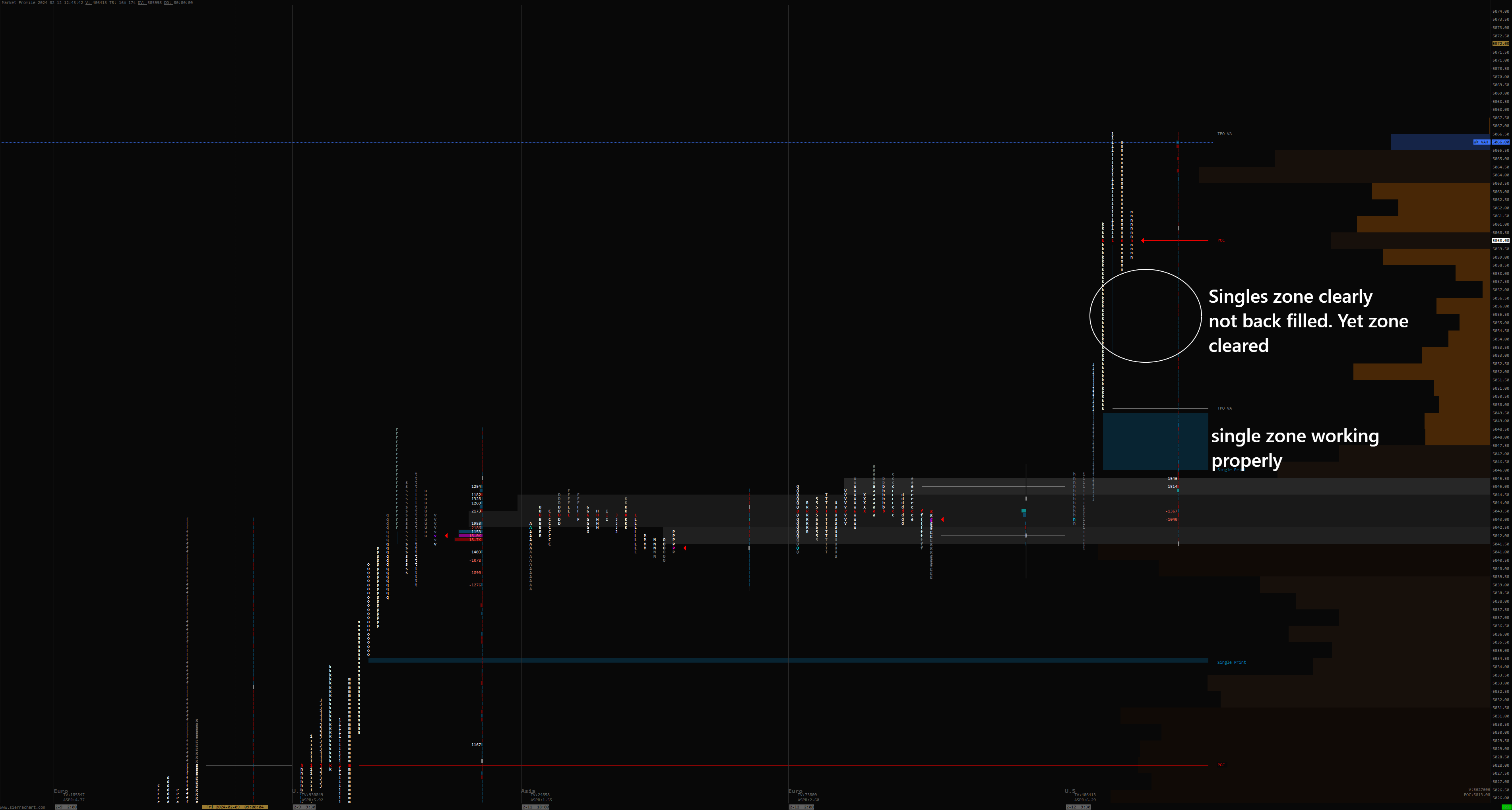

Any update from dev team on the singles zone's that are not clearing properly? example from todays weekly profile. Clear unfilled single zone up top on period K, that launched, then cleared because price touched it, but did not go all the way through. Then the one below which is still untouched, and working fine.
https://www.sierrachart.com/image.php?Image=1707759823416.png

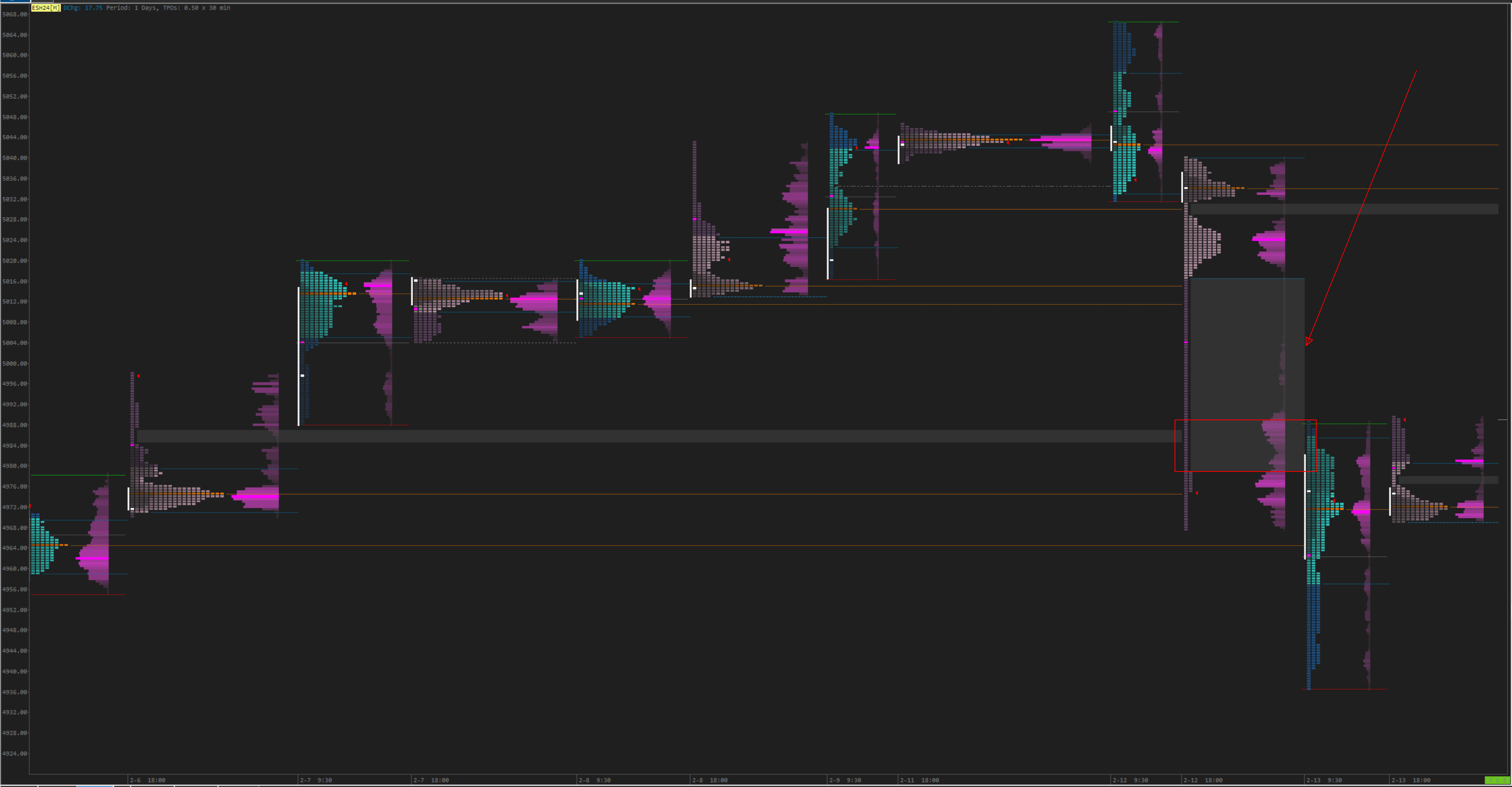

Another bug I noticed.
Chart is ES. Note yesterday overnight session single print area does not project further than the overnight session (pointed the arrow). That's a singular issue, didn't notice it before.
Also is does not get filled when touched (pointed the square area).
Sierra 2599 build.
Thanks!
imagex.png / V - Attached On 2024-02-14 09:46:35 UTC - Size: 277.33 KB - 536 views

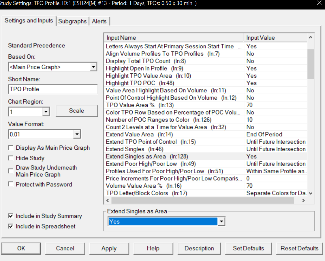

[2024-02-14 11:26:54]
fried4104 - Posts: 108
Go to Studies->TPO Profile->Extend Singles as Area
imagex.png / V - Attached On 2024-02-14 11:26:49 UTC - Size: 270.44 KB - 474 views

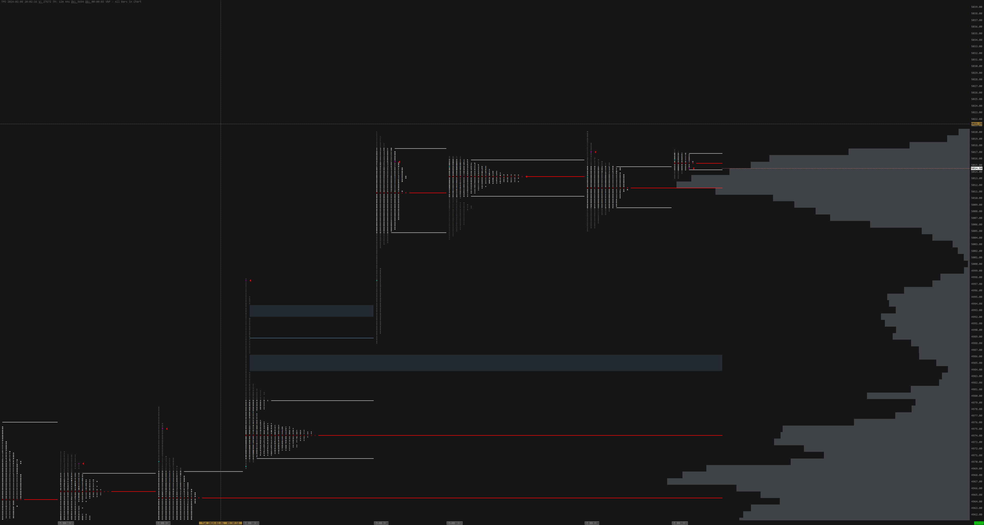

Also, how does this handle overnight sessions? does it clear singles or does that depend on whether you have overnight enabled? For example I hide all overnights except the last. Would this follow depending on whether I have have EXT session enabled in tpo? thx.
*example of singles during IB
https://i.imgur.com/cJoHIu3.png
Date Time Of Last Edit: 2024-02-15 08:04:40
imageScreenshot 2024-02-15 015415.png / V - Attached On 2024-02-15 08:03:31 UTC - Size: 337.17 KB - 554 views

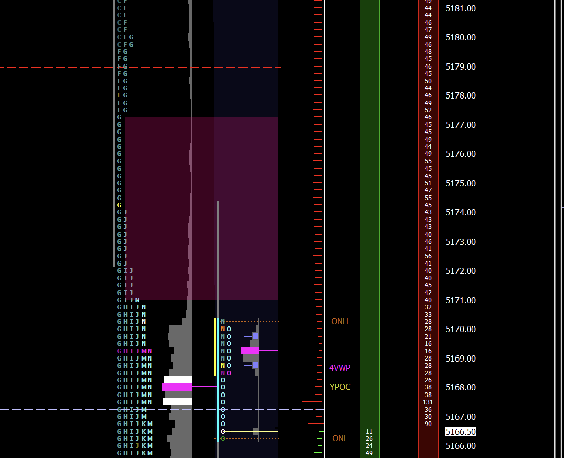

[2024-04-12 22:11:59]

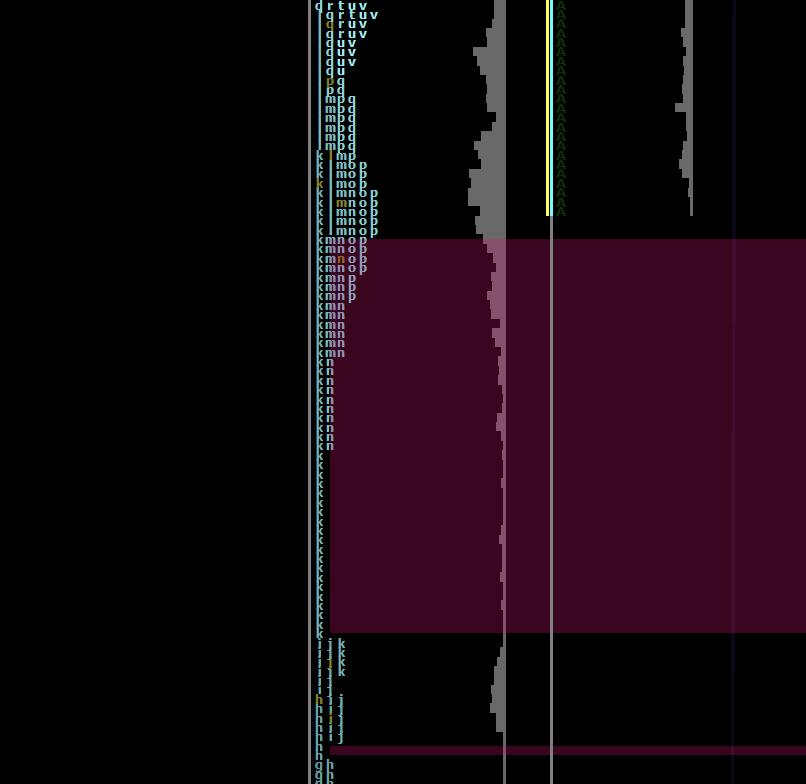

User652903 - Posts: 27
Another error with singles. See attached. The hot pink shading is the singles area. You can see it's overlapping an area that is not a single print area.
Date Time Of Last Edit: 2024-04-12 22:30:32
imageScreenshot 2024-04-12 at 6.10.47 PM.png / V - Attached On 2024-04-12 22:11:13 UTC - Size: 102.54 KB - 604 views
imageScreenshot 2024-04-12 at 6.29.56 PM.png / V - Attached On 2024-04-12 22:30:19 UTC - Size: 47.14 KB - 674 views

[2024-04-25 22:06:04]
More problems with singles; see attached. The pink circled single prints area should still be running.
The way this should work is that the singles extension box should close down one tick at a time until it is completely filled in.
Here it cut off inexplicably, not having been filled in really at all. Would be great to get this working properly.
imageScreenshot 2024-04-25 at 6.03.31 PM.png / V - Attached On 2024-04-25 22:05:30 UTC - Size: 664.33 KB - 670 views
