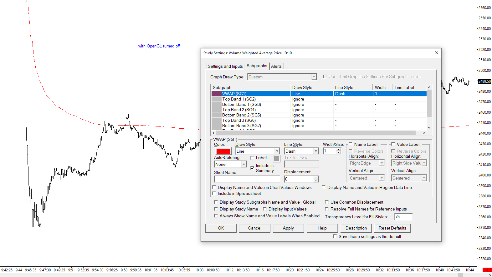

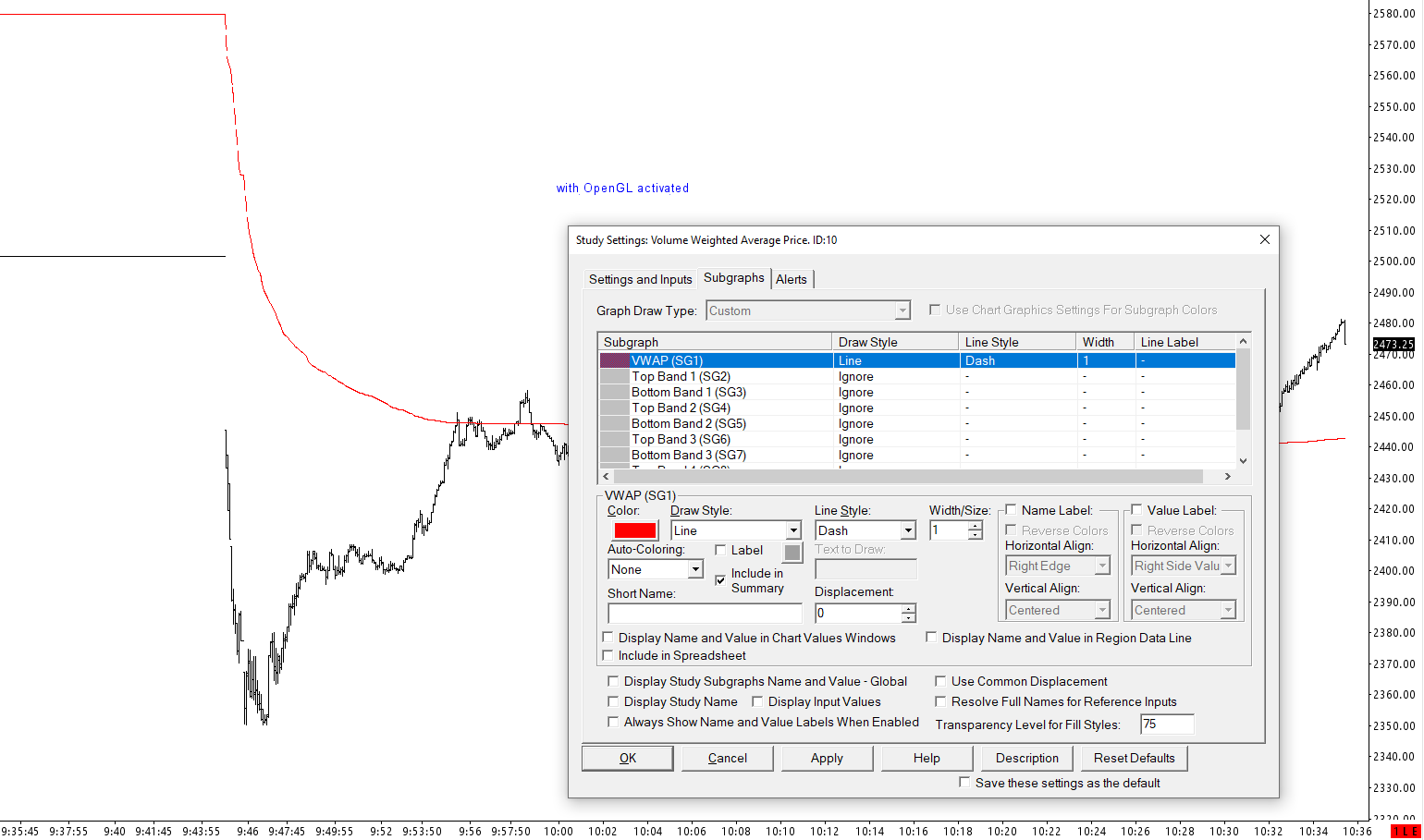

Another issue with regards to openGL is the drawing of VWAP. (it might not be VWAP, it might be drawing in general for different line types)
I use a dashed line for my VWAP. If you refer to the two attachments, you can see with openGL on, there is no dash, it just looks solid, except when the line is steeply vertical. With openGL turned off, the dash is visible at all times.
imageopengl ON.png / V - Attached On 2020-03-17 00:09:54 UTC - Size: 78.99 KB - 678 views
imageopenGL OFF.png / V - Attached On 2020-03-17 00:09:59 UTC - Size: 72.32 KB - 595 views

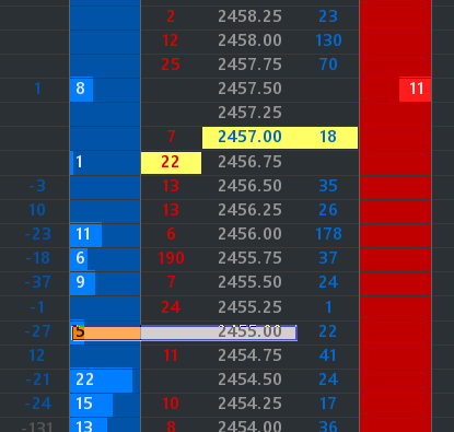

I still have some graphic issues with DOM overlay when hovering over Bid/Ask to put in an order and Ask/Bid-Differnce Profiles are missing the divider line per price level. Also the fonts are just ugly and letters are never aligned/centered in current price box or DOM e.g.(attached files)

[2020-04-02 18:16:13]
We will look over the recent postings here but we cannot do anything about post #164. That is just how the line will be under OpenGL, with all of the details surrounding drawing Study Subgraphs.

Thanks. I think the flickering is something I can fix when I deactivate transparency in a custom study. Still need to do some verification with that. If the exceptions you mentioned caused a freeze or shutdown of Sierra, I have that too sometimes, think it started in a recent release prior 2080 or so.
For me the most disturbing is really the DOM overlay. Without OpenGL its yellow colored, with Open GL its grey, orange (bid) and mintgreen (ask). Re-Attached the pic.

Re your answer in post #78, I've attached a screenshot taken using OpenGL when trying to place an order from the Chart DOM.
As you can see, because the highlighted box is black it is impossible to tell what price you are submitting the order at other than looking at the very top left of the chart.
This is what I meant by black and this is even though the buy column and sell column lines are set to blue and red respectively

nosast - Posts: 327
@Acro: Same for me as you can see on my screenshot from post #171 and #165
[2020-04-21 10:18:44]
We are aware of the issue in #173. And we are working on that.
