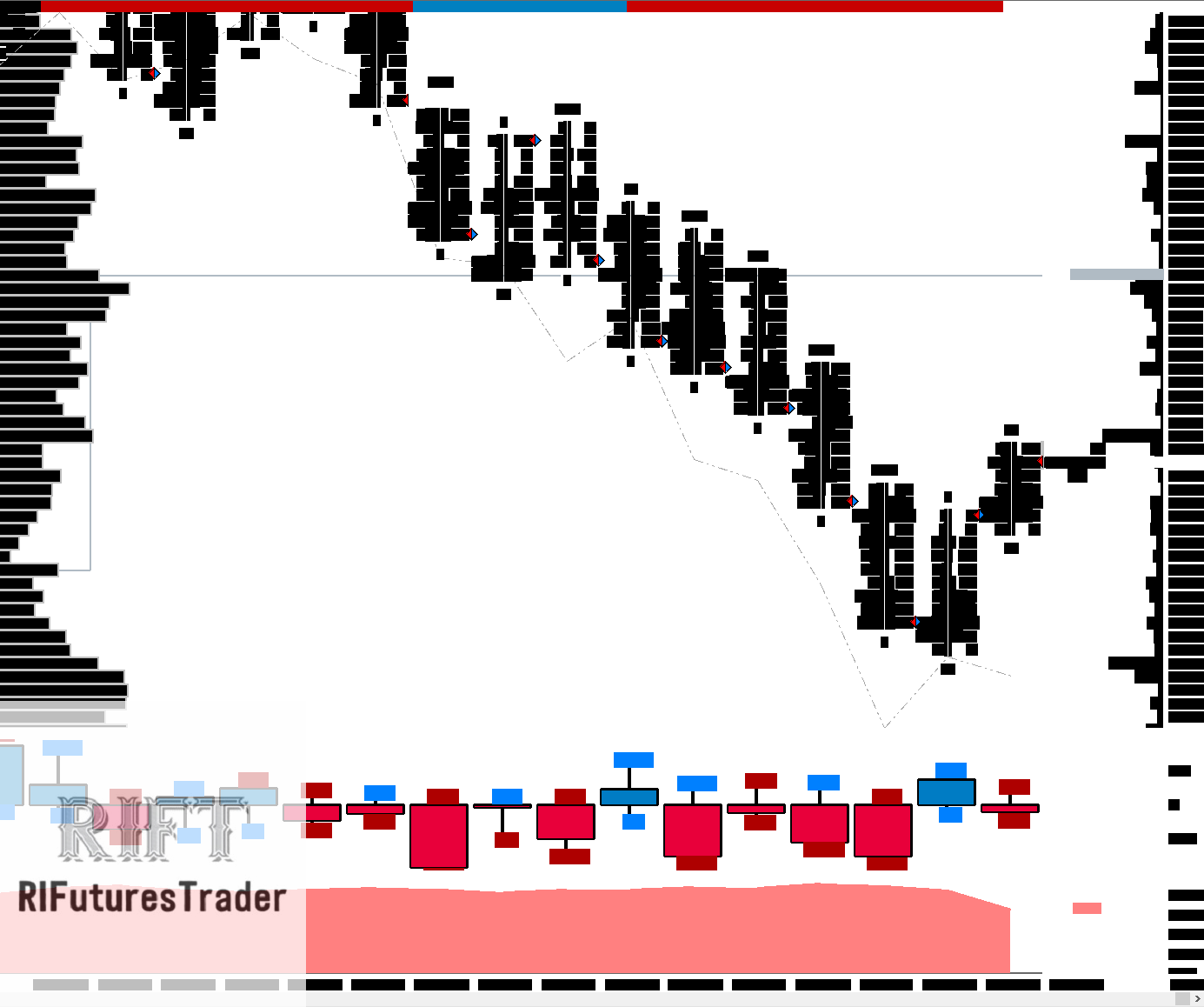

[2020-01-16 00:31:56]
RIFT - Posts: 124
many transparent studies are gray and sometimes I have such charts as attached (GPU: AMD 5700XT)
imageSierraChart.OpenGL.png / V - Attached On 2020-01-16 00:31:39 UTC - Size: 88.24 KB - 765 views
