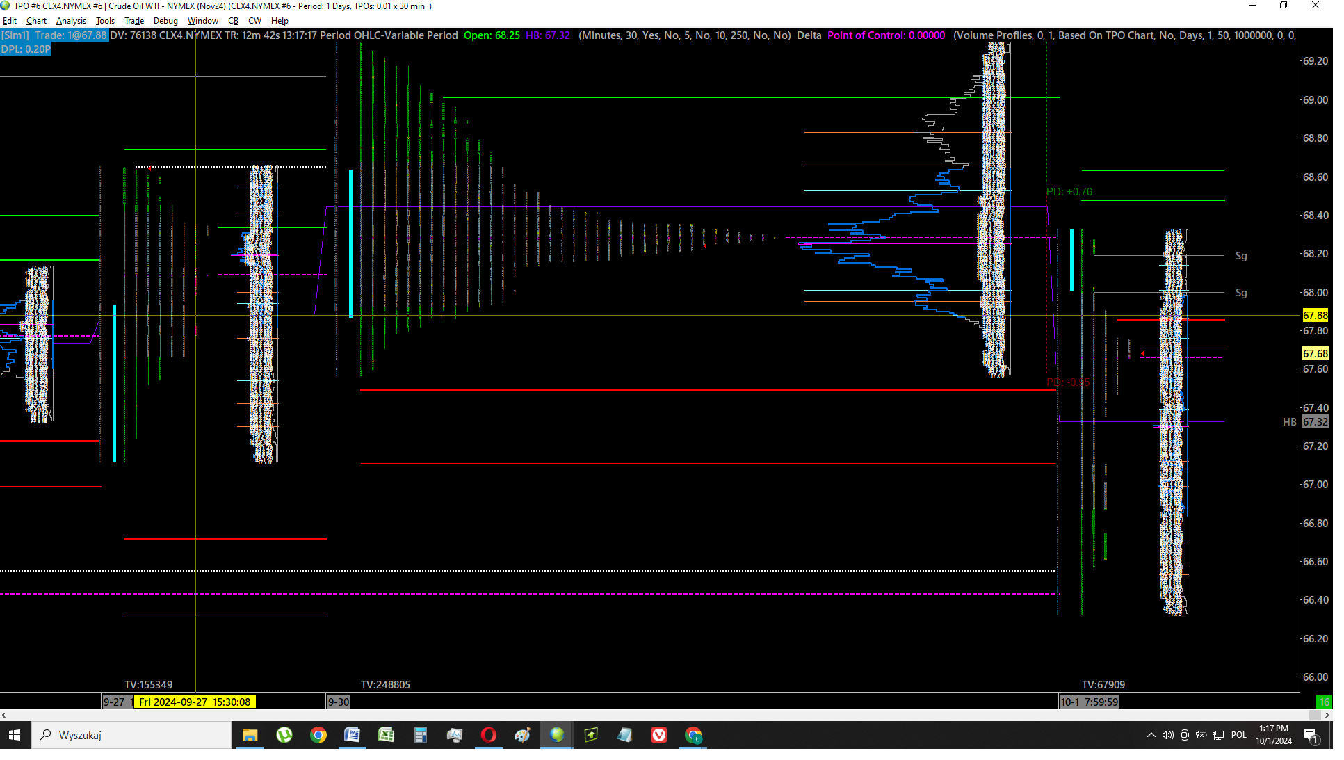

How can I make the columns closer to each other on TPO and letters more legible ?
Turning fonts from auto to bigger doesn't sort this out...
imageTPOtoosmall.png / V - Attached On 2024-10-01 11:18:33 UTC - Size: 217.62 KB - 364 views

John - SC Support - Posts: 48520
To bring the columns closer you need to decrease the bar spacing.
To show the letters more legibly, changing the font is one option. But the best way is to increase the "Letter/Block Price Increment in Ticks", as if this is a small value, you will have too many blocks and they will be difficult to see. Refer to the following:
Time Price Opportunity (TPO) Profile Charts: Letter/Block Price Increment in Ticks

UnleashedPiglet - Posts: 67
It works, but makes the POCs show differently to the, say, M5 or Number of Trades 1 tick charts with the same VbP which I use alongside. Thus I can't go any less than 1 tick on TPO , it affects the POC even as much as 20 ticks.

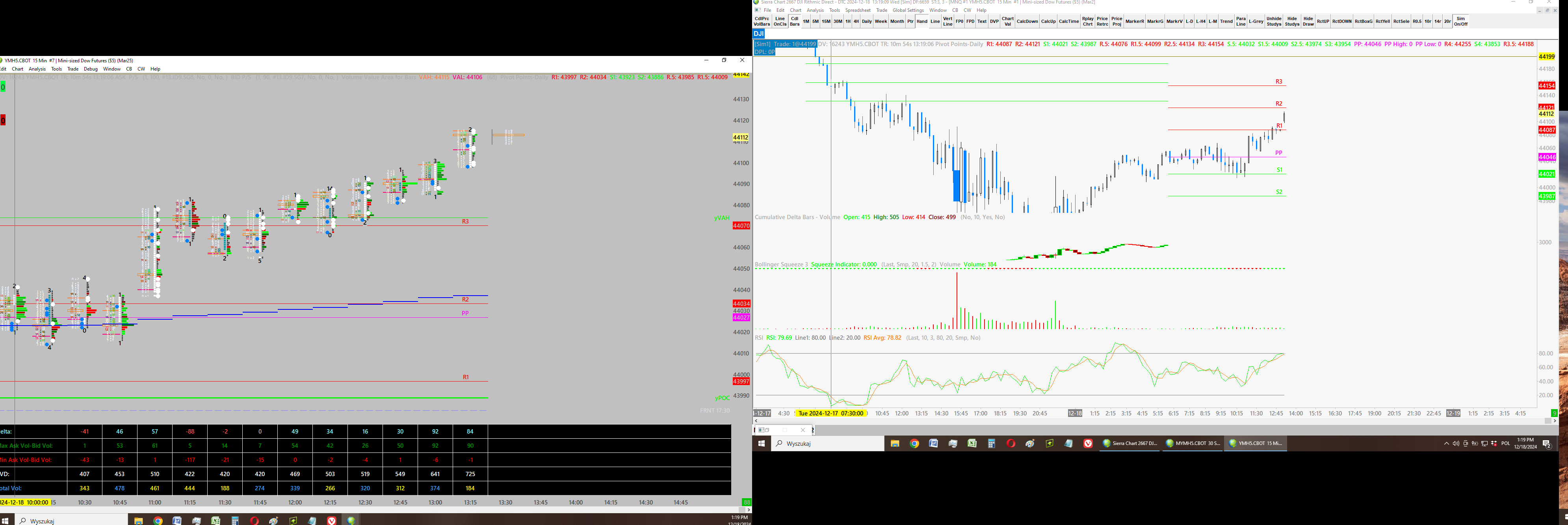

I happen to have a strange occurence with pivots though. I have the same camarilla (formula 5) applied to 2 charts of M15 YM: i.e. Candlestick and Number Bars. These are both the same study, no changes made to the study. Look at the difference.
imagepivots.png / V - Attached On 2024-12-18 12:25:05 UTC - Size: 434.37 KB - 309 views
[2024-12-18 16:04:25]
2. When this occurs try resetting the scales first. It may be that the scaling is somehow lost, although we do not know why.
3. With the Pivot Points, do you have the Input for "Reference Daily Chart for Data" set to "Yes" on either chart? If they are both referencing another chart, are they referencing the same chart?
If they are not referencing another daily chart, then does the Numbers Bars chart have more than 1 day of data loaded? Is there information for the previous day for it to pull from?
3. They aren't . Yes, they do. Now works fine... Don't know what to tell you.

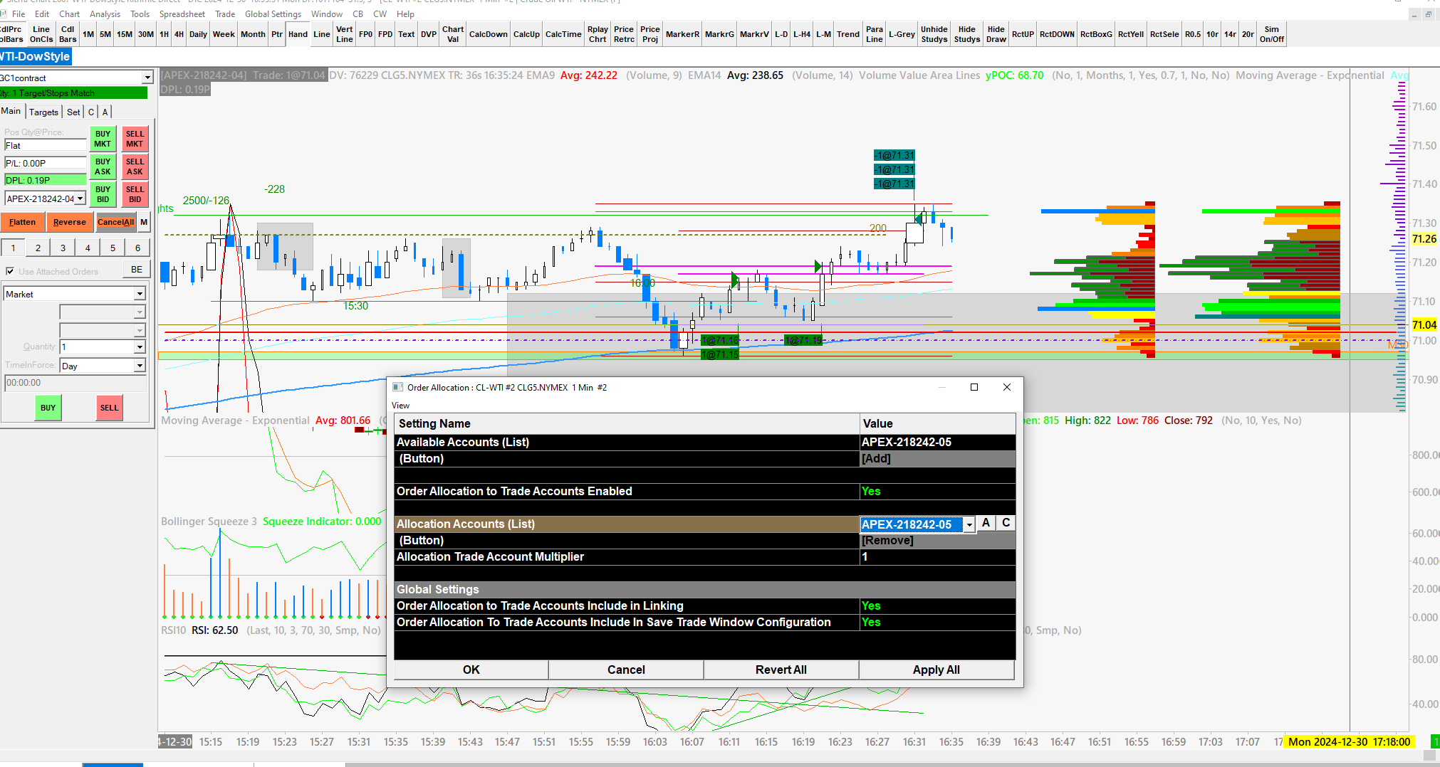

2. ok , I can live with that, although I can barely do with the 1. problem. It happened again. I had 10 contracts opened. Pressed my flatten and cancel shortcut today. 8 out of 10 stayed open!
No stop loss nor take profit, poof. Just the bare contracts stayed in the game. I had to manually pull them out from rTrader, lucky I made it .
Should I use Flatten all Positions - All Accounts to be secure ?
Another thing - I also had a bad copying issue, it seems as if it opened two positions properly and then when I scaled in the third one it did it only for one account. The second one stayed with the initial two positions.
Apex won't talk to me because once they don't deal with copying, another time copying is made by Apex Investments (?) so I should address them.... I'm not sure either this is a common issue, or maybe I did something wrong. Or perhaps they're ripping me off just a bit.
imagewrong30.12.png / V - Attached On 2024-12-30 18:17:33 UTC - Size: 161.22 KB - 289 views
imagewrong30.12-3a.png / V - Attached On 2024-12-30 18:20:56 UTC - Size: 138.46 KB - 343 views
[2024-12-30 22:16:58]
The Order Allocation to Trade Accounts is fairly straightforward, in that it simply copies the orders to the other accounts. There is nothing fancy about how it has been implemented, which is done specifically to avoid issues.
The only thing we can say is that you need to pay attention to the various accounts and make sure everything is working properly. If an order does not get copied to an account, then check your "Trade >> Trade Service Log" and your "Trade Activity Log" to see if there is a rejection, or some other reason for this occurring.
Our final statement on this is that since you are working with APEX, you are using Rithmic for the order routing. We have seen lots and lots of issues with Rithmic's ability to stay connected and properly respond to orders. So it's quite probable that the issue you are having is related to the Rithmic interface. We want to point out that in this situation, Rithmic owns that interface, so there is nothing we can do about it. We can only tell you that it has issues.

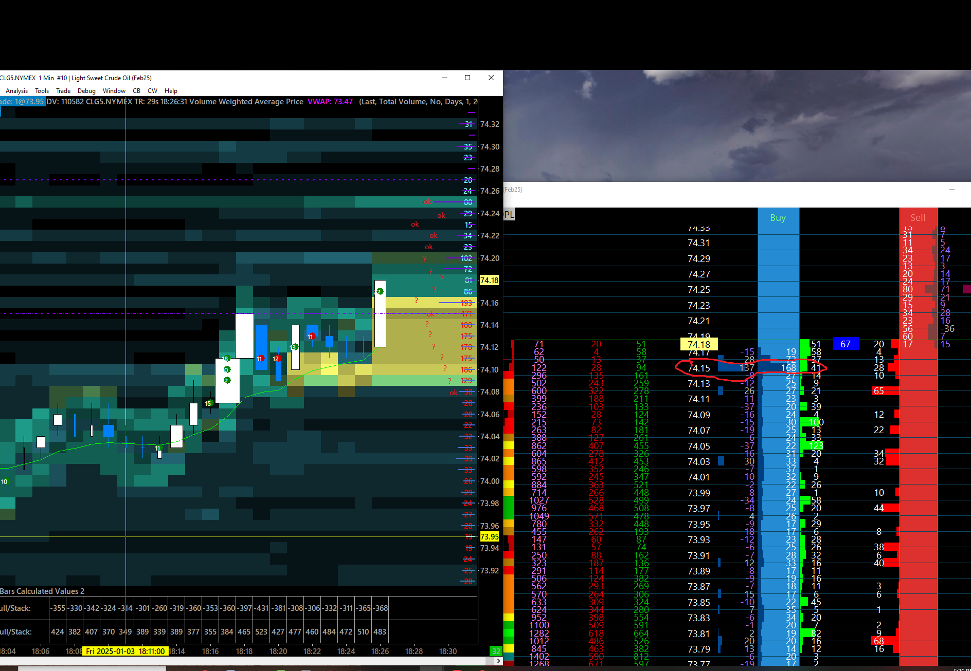

Can you tell me why there are inconsistencies in market Depth Historical Graph ? It should show present pending orders up and down as i understand (beside obviously presenting historical depth)
It's not refreshing along with the order book, shows the orders selectively. See the attachment.

Sierra_Chart Engineering - Posts: 25420
We do not understand what inconsistencies you are referring to.
We only accept an image following these instructions:
And make sure you are looking at the same symbol. Not comparing market depth for a different Trade/Current Quote symbol as compared to the main symbol of the chart.

Yes, I'm looking at the same symbol, I only trade CL.
Perhaps I'm unaware of something but I see a lot of strong price levels on the heatmap which do not exist on the DOM , I do not even see them stacked and pulled immediately (if this is supposed to be the case). If it's about the refresh and I could do something about it so the heatmap reflects the DOM, which is clearly not the case at the moment, please advise.
The attachment file has been corrected.
imageheatmapinconsistencies.png / V - Attached On 2025-01-07 09:31:54 UTC - Size: 351.44 KB - 262 views
[2025-01-07 16:17:54]
If you want the values that are shown "after the last bar" to be the same as the Market Depth in the DOM, then the Input for "Depth Quantity Type to Display After Last Bar" needs to be set to "Last Depth". Make sure this is set correctly. Refer to the following:
Market Depth Historical Graph: Depth Quantity Type to Display After Last Bar
