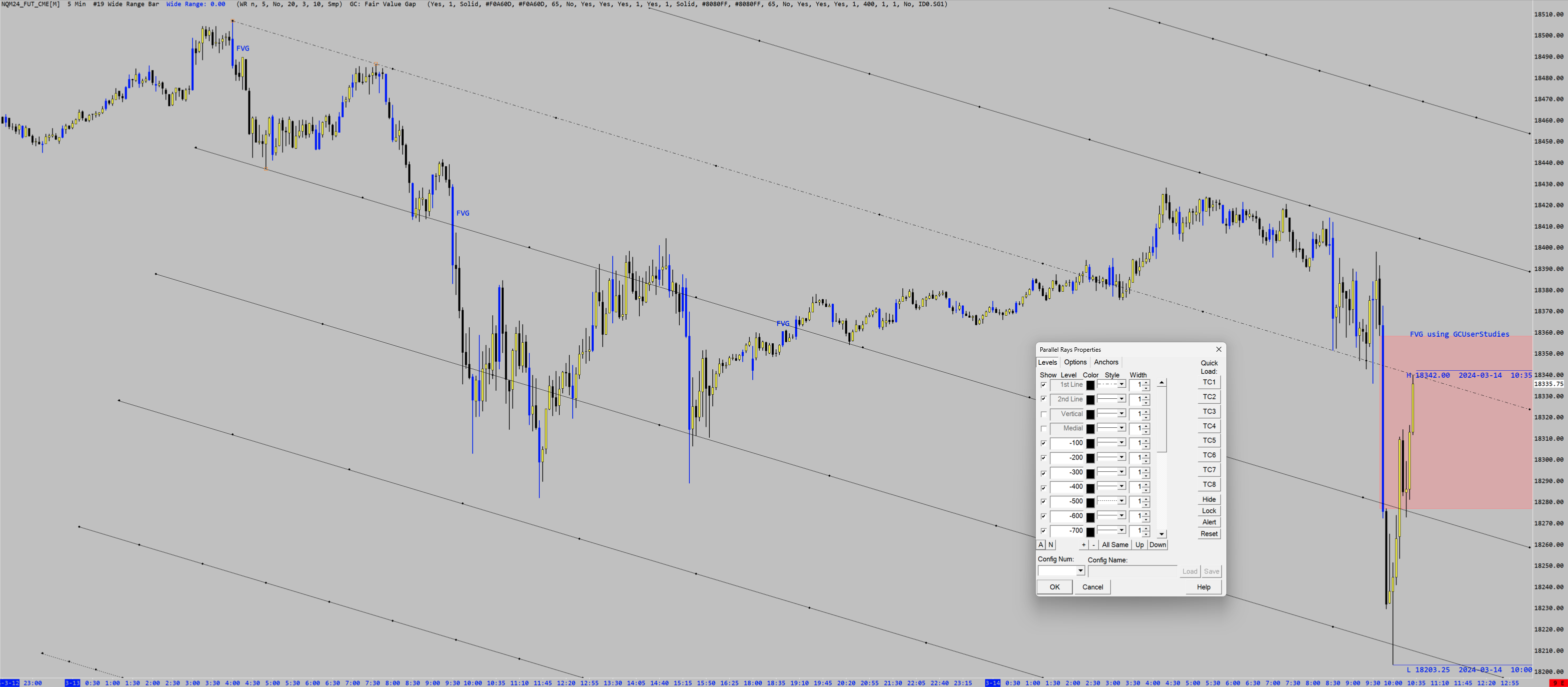

I've attached a chart showing you what the Sierra Chart Wide Range Bar studies accomplishes and also comparing it with the GCUserStudies tool and overlaying a parallel rays tool that shows you where to expect those FVGs to form using technology from the 1890s and 1960s.
Cool isn't it?

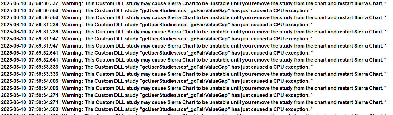

[2025-06-10 19:53:04]
User731023 - Posts: 167
When I open FVG I get this constant message.
Any help would be appreciated.

[2025-07-14 23:07:52]
Can anyone help?
[2025-07-15 01:20:59]
D.Vicious - Posts: 26
@User731023
How many days are you loading on the chart you are applying the FVG study? Are you hiding when filled?
Date Time Of Last Edit: 2025-07-16 01:24:11
[2025-07-16 12:32:12]
@D.Vicious
Thanks for answering.
Even does it with 1 day loaded. Yes on hiding when filled.
Frustrating because really would like to use one.
[2025-07-16 13:13:51]
User431178 - Posts: 907
Which file version are you using and which Sierra Chart version are you on?
[2025-07-16 22:04:41]
@User731023
Interesting lol just to get it out of the way: Are you on a laptop or desktop? what kind if CPU do you have? Are you using OpenGL(with a GPU)? I use this study on 4 different charts and haven't had that log message pop up or notice any kind of lag when working my charts.
