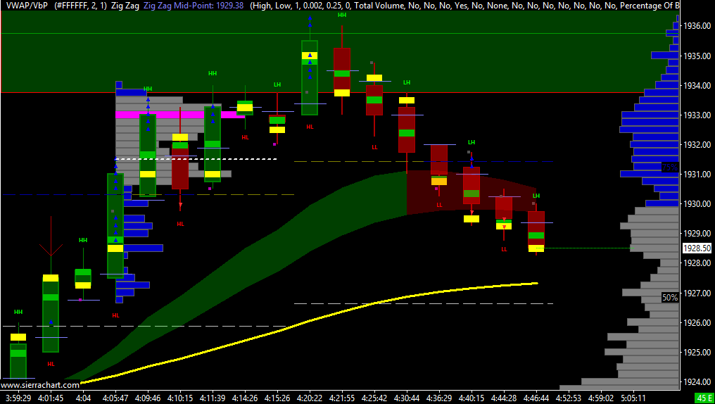

Hi Zdislav. Any updates as of yet. Love the ofa bars :) Take a look at the volume paint bar study. I added it to the ofa bars. Then turned off some its functions so it only shows the volume cluster and mean average volume. It really works well. I am no programmer so i a useless in helping you with code. It might give you an idea if you can view the code for the volume paint bar study. I really like the momentum studies. Not sure how the exhaustion study works yet. Screen shot below. http://www.sierrachart.com/image.php?l=1443084465195.png |

Hi. I think your work is fantastic. Lets get the momentum study perfect :) Seems to be good within the current bar. But i am no expert on the underlying mechanics of it. It certainly helps me when big buyers or sellers are hitting the tape. Thank you. The volume paint bar study is a study that you can add to your chart. These bars show you where 70 percent of the volume is. Its a sierra study. The kicker and the cool thing is it shows you the moving cluster within the bar as volume it coming in. So the yellow squares in the chart i posted, move up or down within the bar as volume is coming in. The green square is the mean volume of that bar. Within subgraphs set barhigh and barlow to ignore. This will isolate the volume cluster :) OMG love the candle price volume bars with ofa bars. Looks great with the cluster from volume paint bar study too. Date Time Of Last Edit: 2015-09-24 21:17:08

Happy to hear it is useful to somebody. Try to look at post #37 in this thread if you want. It may help you understand the logic behind momentum study. I guess you mean "Volume distribution paint bar study". I looked at it. This study works only if the cluster size is set to 1. That means it shows POC of the bar. But the purpose of cluster analysis is to find the largest concentration of volume in a given bar which doesn't necessarily mean it has to be the POC (and often it is not). Any larger setting only draws cluster evenly distributed around POC (and if the POC is close to high or low it often draws the cluster in a void. Try to draw the study under Numbers bars study and you will see. So I need to stay with my cluster analysis. |

Well you no more than me:) Lets get the cluster study perfected then!haha. sure wish i knew how to code! i was confusing volume cluster study with poc. Thanks for checking in.I added your cluster study to ofa. I did not think it worked. Could you tell me the difference between the yellow and orange squares? Thanks. I have watched lots ofa videos so i am not sure what your colors represent. thanks...

In last videos DB uses just one-tick cluster, so it may be POC. "Gold-ish" color represents the highest concentration of volume (BID+ASK), which is a cluster of set size (3 ticks works well) in a given bar. Point of control - orange dash - represents only one price level with the most volume. Test: 1) Where is concentration of volume in this bar? 2) Where is POC? 2) Is this bar bullish or bearish? 3) If you would like to enter a trade (in either direction), at which price level would you set your order? 1007: 0|2 1006: 99|50 1005: 0|40 1004: 0|5 1003: 20|2 1002: 50|20 1001: 50|10 1000: 50|0 |
