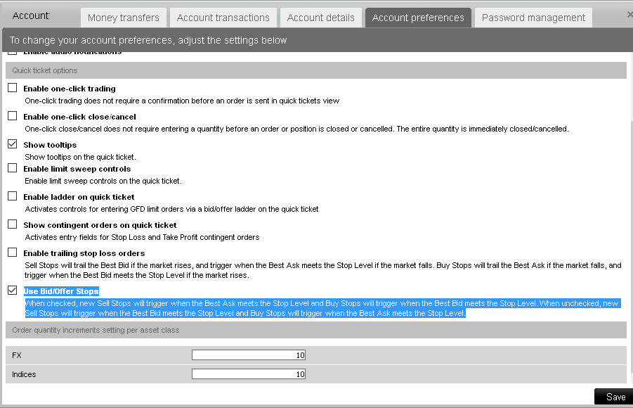

[2016-03-23 08:35:55]
gomifromparis - Posts: 244
It does not seem to enforce the Bid/Ask setting
Use Bid/Offer Stops
When checked, new Sell Stops will trigger when the Best Ask meets the Stop Level and Buy Stops will trigger when the Best Bid meets the Stop Level. When unchecked, new Sell Stops will trigger when the Best Bid meets the Stop Level and Buy Stops will trigger when the Best Ask meets the Stop Level.
[2016-03-23 08:42:13]
What setting are you referring to? There is no setting in Sierra Chart that would have any effect on this.
The stop orders are filled by LMAX. This question should be directed to LMAX.
[2016-03-23 09:14:32]
This setting.
LMAX/FIX stops me out when both bid and ask touch the stop price.
LMAX/DTC stops me when bid or ask has touch the price. So it's much sooner, before price is actually touched.
It acts like if the checkbox was not checked.
So I'll keep directing the question to you, since it works as planned over FIX.
imagestopsetting.png / V - Attached On 2016-03-23 09:11:39 UTC - Size: 27.86 KB - 823 views

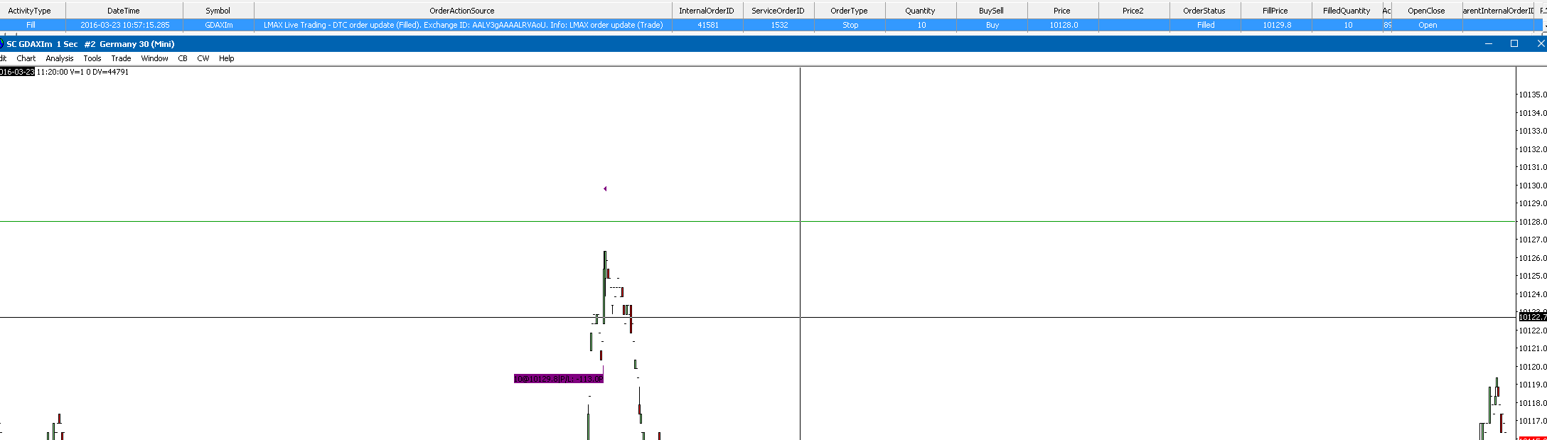

[2016-03-23 16:36:11]
Maybe they don't apply the customer settings on the grouped sierra connection.
Anyway here's what happens, stop 128, executed 130 when price never got past 126
Date Time Of Last Edit: 2016-03-23 16:36:34
imagestoplmax.png / V - Attached On 2016-03-23 16:36:29 UTC - Size: 22.8 KB - 786 views

This is the answer from LMAX:
This needs to be enabled on each sub-account, not on the Master FIX.
When you place a Stop Order on each account, it should trigger according to
the rules of "Bid/Offer Stops".
Are you not seeing this behaviour?

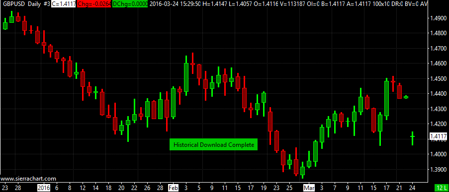

[2016-03-24 14:33:06]
AndyL - Posts: 119
Have you had a chance to look at daily/historical data?
imageGBPUSD Daily #3 2016-03-24 15_29_46.009.png / V - Attached On 2016-03-24 14:32:38 UTC - Size: 31.5 KB - 800 views
[2016-03-24 16:36:38]
Yes we did and we did get this working properly.

Regarding stop order triggering, this is from LMAX:
We realised the problem. The setting for "Bid/Offer Stops" needs to be
applied to the Master FIX connection for it to apply to the sub-accounts.
The only drawback to this is that the setting will apply to ALL Stop orders
you place on any sub-account, regardless if the sub-account has the setting
enabled or not.
Not sure how to resolve this because most likely people want different settings?
