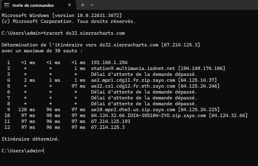

[2024-06-16 17:03:15]
BenjFlame - Posts: 353
That was from a friend in France, from another ISP than mine.
This was run on 2, June.
Seems to be clean route with Zayo handling everything.
But his ping to ds32 is about 10ms slower than mine.
imagerr.png / V - Attached On 2024-06-16 17:03:07 UTC - Size: 50.22 KB - 330 views
[2024-06-16 18:48:58]
Zayo is one of the peers with the Internet from the 123.net data center that we use in Michigan. Your friends ISP is routing data over Zayo. Your ISP is routing it over Cogent. See if you can change to a different ISP if Cogent is giving you trouble but Cogent is not necessarily bad in this case.
This is a trace, to DS32 from one of our servers in Germany. As you can see it also takes Zayo route:
Tracing route to ds32.Sierracharts.com [67.214.125.3]
over a maximum of 30 hops:
3 4 ms 4 ms 4 ms core1.fra.hetzner.com [213.239.224.70]
4 5 ms 7 ms 4 ms as6461.frankfurt.megaport.com [62.69.146.139]
5 105 ms 104 ms 104 ms ae1.cs1.fra9.de.eth.zayo.com [64.125.29.64]
6 * * * Request timed out.
7 108 ms * 107 ms ae2.cs1.ams17.nl.eth.zayo.com [64.125.29.59]
8 * * * Request timed out.
9 104 ms * * ae10.cs1.lhr15.uk.eth.zayo.com [64.125.29.17]
10 * * * Request timed out.
11 * * * Request timed out.
12 * * * Request timed out.
13 104 ms 104 ms 112 ms ae10.mpr2.dtw3.us.zip.zayo.com [64.125.24.225]
14 105 ms 105 ms 105 ms 64.124.32.66.IDIA-385104-ZYO.zip.zayo.com [64.124.32.66]
15 104 ms 104 ms 104 ms 67.214.125.193
16 104 ms 104 ms 104 ms 67.214.125.3
Date Time Of Last Edit: 2024-06-16 18:54:44

In relation to the closing of this thread: Sierra Chart Internet Connectivity Related Issues
What's the now default dsxx.sierracharts.com that is used when connecting from France ? I'd like to ping it from France to test the definitive setup you guys set.
Date Time Of Last Edit: 2024-06-24 20:27:16
[2024-06-24 22:06:03]
You could test DS28.SierraCharts.com.
[2024-06-25 08:31:11]
I get a good 87ms average. From across Atlantic I think this is as good as it gets.
It goes trough cogent but it appears not to be a problem now and not something you can control. Also cogent picks up my route right here in France, and single handle it right to SC servers. That is also good.
I notice I get also very good ping on DS32.SierraCharts.com .
Can I use it to get the data ? How is the server used determined by SC, I see no mention of particular server in the message log ?
Date Time Of Last Edit: 2024-06-25 08:54:55
