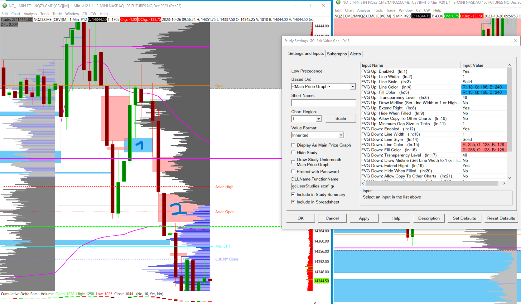

gcUserStudies Can you add a setting to filter when the fair value gap has been filled?
[2023-05-23 20:58:10]
gcUserStudies - Posts: 143
Can you explain further what you mean? There is a setting to hide them once they are filled. Not sure if you are asking something different.
[2023-05-23 21:21:19]
awakef - Posts: 72
As you can see on the image the price went to the fair value gap and went long but the fair value gap is still there.
Is still there because it hasn't been filled completely.
Ict teaches that when that happens is filled already that no need to be fullied completely.
What I mean is a setting that you can put when if filled halfway or just 2 ticks the fair value gap goes filled and disappears.
Thanks for an awesome study!! ;)))

@awakef,@gcUserStudies; Is it okay if you can share the study for the Fair Value Gap? Is there also a study Order block? Thanks..
[2023-05-27 15:58:41]
I see what you mean. I will take a look and see if I can add this.
[2023-05-27 16:00:04]
The study is here if you need to find it or share it: https://gcuserstudies.github.io/#download

maxm1987 - Posts: 136
Hi guys.
would appreciate if you could have a look at the screenshot, i am forever grateful for the fvg indicator BUT: maybe I just not getting 1 or 2 things.
I set the indicator to extend the fvg to the right and that it doesnt disappear when it gets filled in.
the FVG marked 1 gets filled in and then disappears, the fvg marked 2 doesnt get extended to the far right of the window.
Is this what it´s supposed to do?
TY
EDIT: reading through my post I stumbled upon the disappearing part of it. The fvg doesnt disappear but is there a way to leave the fvg extended to the right until the session ends even though it got filled in? like a fvg cutting through candles
Date Time Of Last Edit: 2023-10-26 14:29:02

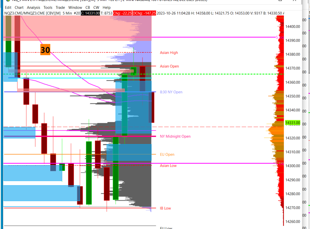

and while we are at it maybe you could have a look at the second screenshot as well.
I concerns the order of the studies .. first, the FVG were hidden under the VP, so in the drawings settings I set "Draw highlight drawings underneath main graph and studies" to "No" .. so now the FVG are on top of the VP however the fvg are on top of the candles as well .. is there a way to display the VP in the background, on top of that come the fvgs and then the candles?
