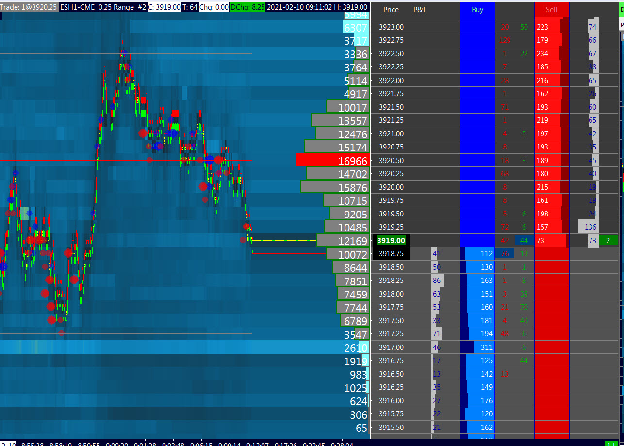

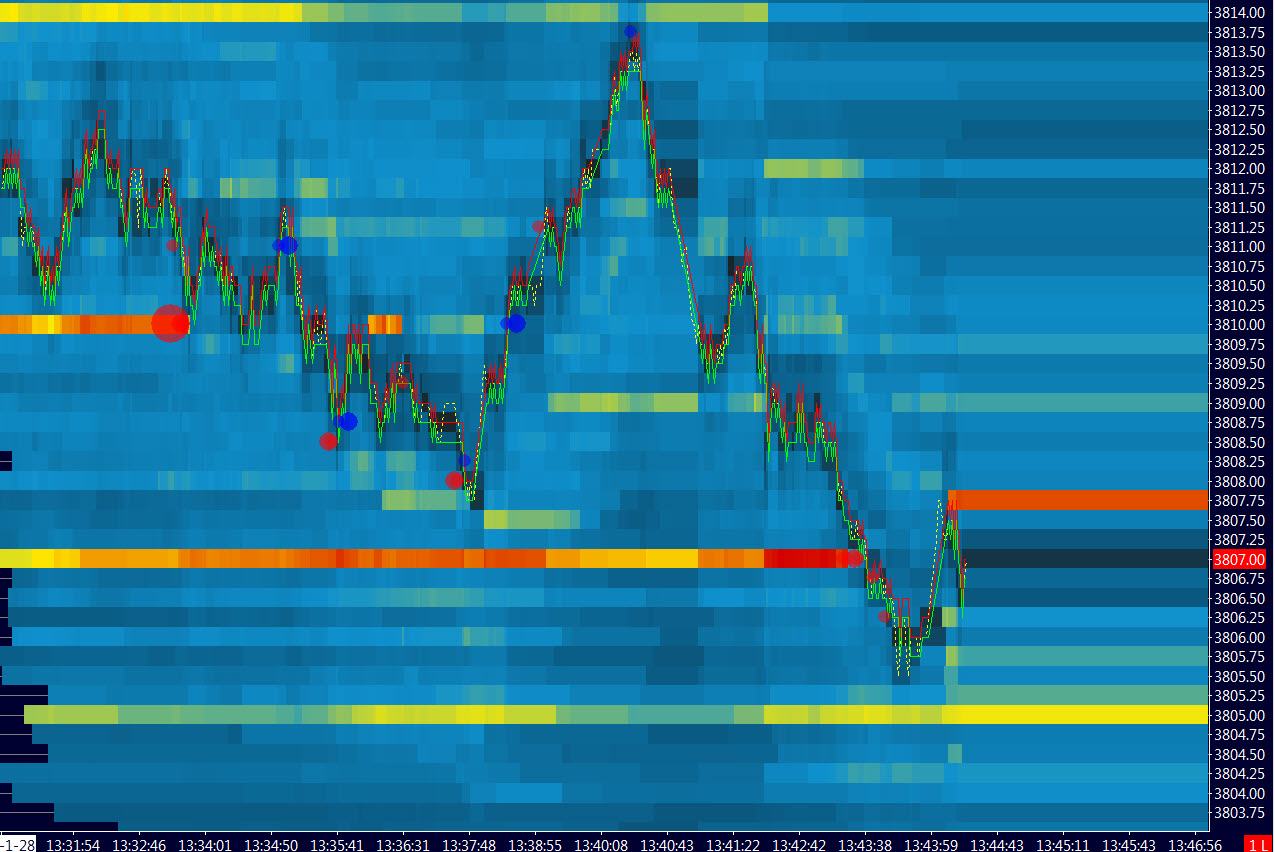

To have a Bookmap like representation, in my opinion probably an easier possibility could be to work on the Volume At Price Threshold Alert V2, (I've done the chart you see below with it but putting on more than one indicator with different setttings) just adding "Automatic Indicator Size", on this indicator there is already the Ask Volume - Bid Volume Difference... so it would be perfect and more flexible.
regards

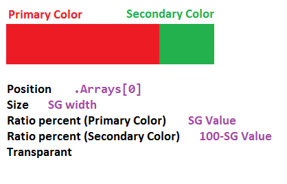

We are considering adding Bid/Ask coloring to the Text as well. Would that be the best way to differentiate Bid and Ask dominant delta when both numbers are positives?
John, I wrote it a few years ago and it was rejected. So I'm trying again:
New Drawstyle "Transparent Circle Ratio" with two colors
and
New Drawstyle "Transparent Rectangle Ratio" with two colors
imageDrawstyle.png / V - Attached On 2021-02-02 01:22:44 UTC - Size: 6.97 KB - 903 views

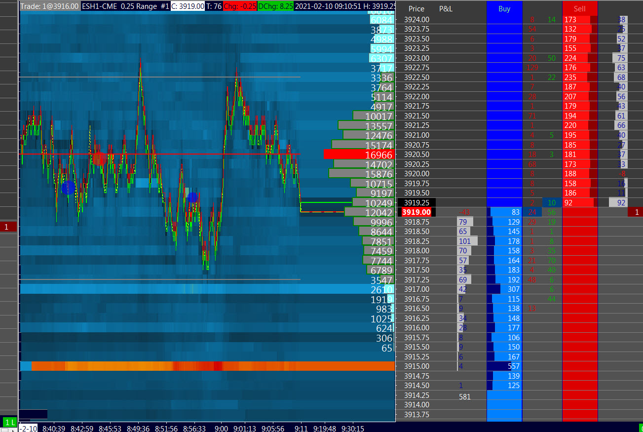

just downloaded the pre-realise 2227 (36090) an put on the indicator Large Volume Trade on a ONE TICK CHART put on the Draw Mode "Based on Enttire Bar Total Ask Bid Above Threshold - Difference, but something is not correct in my opinion, I've setted the Volume Threshold at 100, it should draw all the DIFFERENCE ASK-BID TRADED from 100 contracts and more drawed at different dimensions according to the actual difference numbers.
The point is that if I compare this chart with another chart (again a 1 tick chart- exactely the same) where I used the indictor Volume at Price Threshold Alert V2 that draws Circles of different dimension starting from 100 (ask-bid difference) to 300 (6 indicators, 3 for the positive numbers and 3 for the negative numbers) the 2 charts are very different, instead they should be very similar.
The Volume at Price Threshold Alert V2 seems more reliable, but it is not practical... it misses the Automatic Indicator Size.
How could be this difference? wouldn't be possible simply adding to the Volume at Price Threshold Alert V2 or there is an expalation that I don't understand for this difference?
regards
imageVolume at Price Threshold Alert V2.jpg / V - Attached On 2021-02-10 15:19:15 UTC - Size: 369 KB - 870 views
imageLarge Volume Trade Indicator.jpg / V - Attached On 2021-02-10 15:19:28 UTC - Size: 417.23 KB - 819 views

There is a fundamental difference between how these two studies work that you need to understand:
- Volume at Price Threshold Alert V2: Gives an indicator when the total of the calculated volume at that price exceeds the threshold.
- Large Volume Trade Indicator: Only accumulates trades that are larger than the threshold and then displays the indicator for the resulting calculation.
For example, a bar has a Bid Volume of 73 and an Ask Volume of 182.
- Volume at Price Threshold Alert V2 set to Ask Bid Difference with a threshold of 100: will give an indicator since 182-73 = 109 (>100).
- Large Volume Trade Indicator: May give an alert, depending on if any individual Trade is > 100. Most likely, this will not be the case.
Also, if you are wondering why you would see a difference in your 1 charts since they only reflect a single trade - your charts are not 1 tick charts. Since they are setup as a 1 tick Range chart, there can be multiple trades that occur within the range of 0.25, and you can see that your bars actually have a range of 0.25 (meaning they stretch from one price point down/up to the next price point. In order to have a true 1 tick chart you need to set your chart to Number of Trades and then use a setting of 1.
