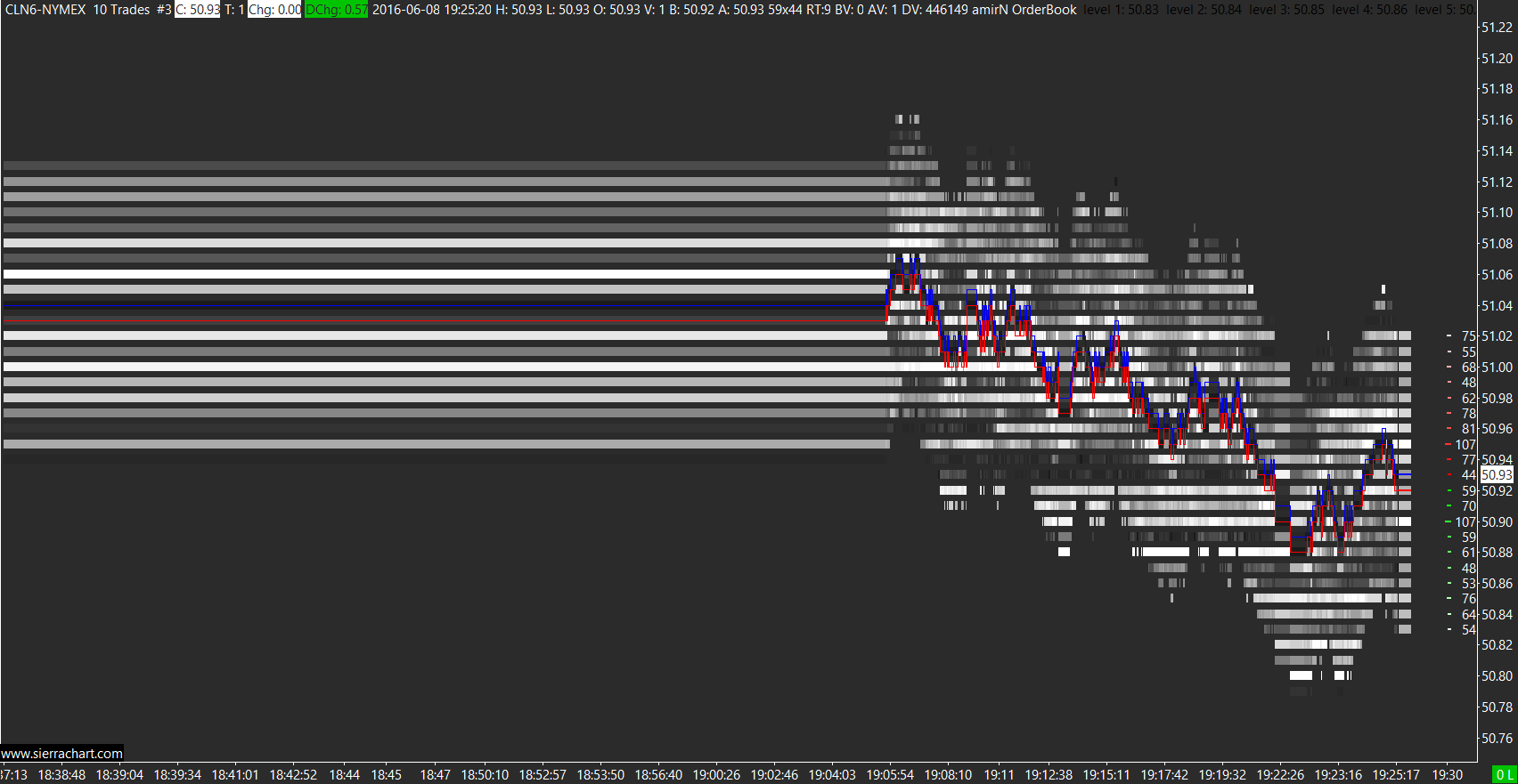

[2016-06-06 08:10:51]
amirN - Posts: 169
Another version.
Changes are:
1- Extended the current orderbook to at least 20 points into the future. The Bid/Ask lines have changed to DOT for these points. In order to see them you have to use <CTRL)-> to see the Fill space. Please set the option "Lock fill space".
2- Large volume study now works on the total volume traded during the period. But the colouring is based on the relative size of Bid and Ask volume during the period.
I have not done much testing so please feel free to point to possible shortcomings.
You might have to remove and then reapply the indicator to your chart.
Amir

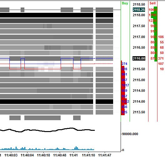

No worries, As I am using the DLL I continually update it to add more functionality useful to me.
Here is the latest one:
The "Display type" option 1 has changed. When selected, the Black would be the "Max Volume" or more and not the maximum volume on the DOM. Therefore the shading is not based on the relative volume to the current maximum volume on the DOM but to an absolute value.
This would allow me to look back at any historical data and see what the DOM volume was at the time. Also if a very high volume has reached the DOM the other levels shading does not change.
Since there are 20 shading levels then if the "Max Volume" chosen is 2000, the shade levels would change every 100, i.e. a volume of 0 to 100 on the DOM would be White, 100 to 200 a darker shade and so on.
Regards

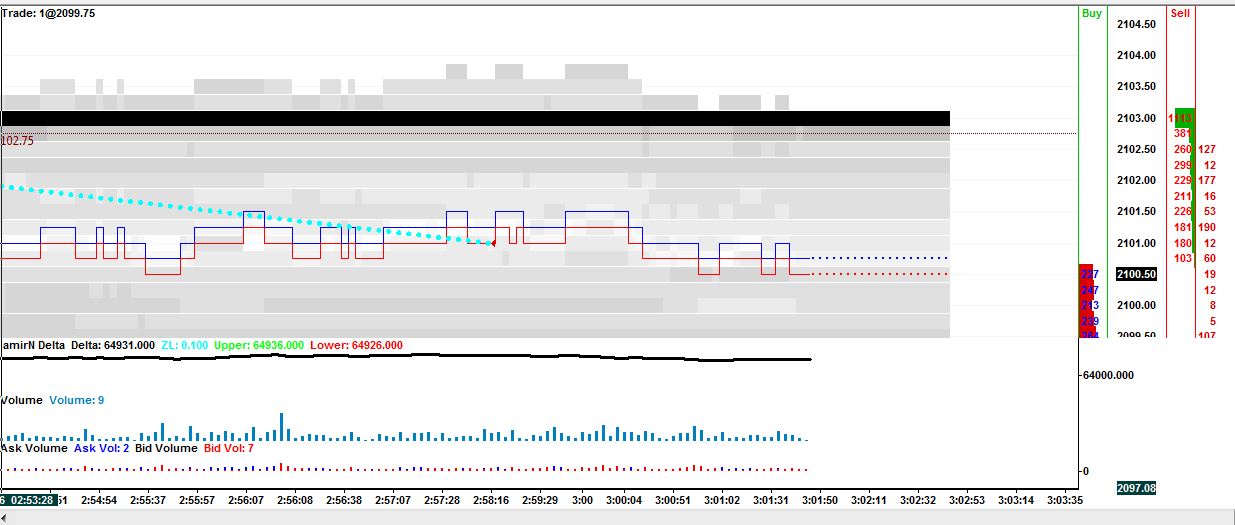

[2016-06-08 16:43:49]
amirN - Posts: 169
Sorry I had to add MinVolume as well so that I can have more shades in the range I want. Also separated the current DOM shading from historical shading.
Hopefully this would be the last change until SC version.
Regards
Amir
attachmentamirN.dll - Attached On 2016-06-08 16:38:06 UTC - Size: 105 KB - 916 views

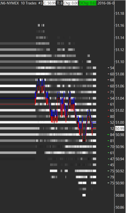

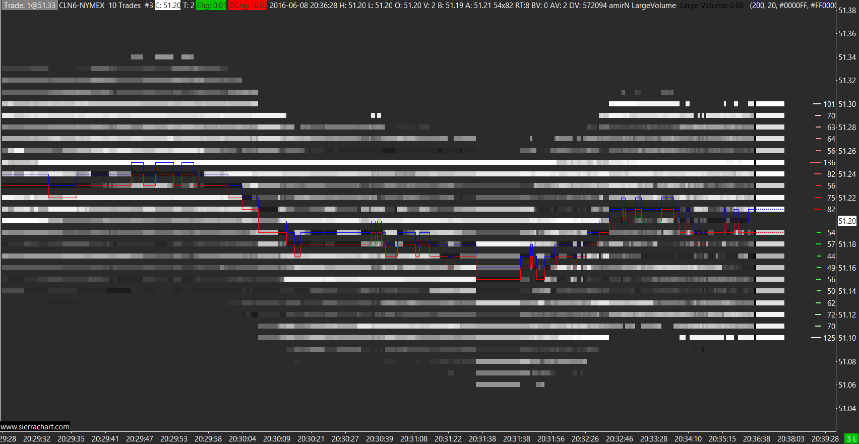

User529762 - Posts: 25
Hi Amir, firstly thank you very much for your generosity for sharing this! Please see attached picture. This is the last DLL however I am missing a lot of information referring to your picture, not sure how to get the lot sizes etc on the right like yours? I am trading CL and like to see 80 contracts and
the 100 as white, what would you suggest to highlight these 100 contracts ?
http://www.sierrachart.com/image.php?Image=146540672646.png
imagesierra.png / V - Attached On 2016-06-08 17:19:48 UTC - Size: 72.06 KB - 1122 views

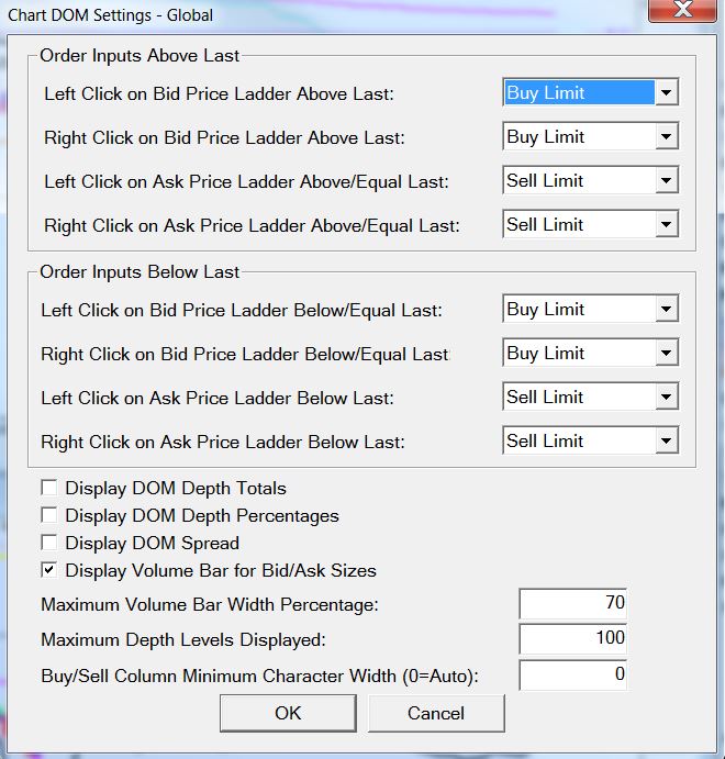

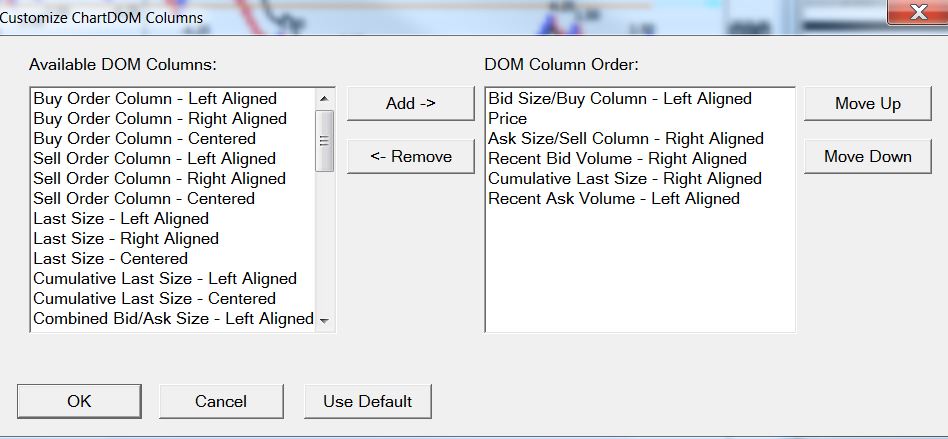

amirN - Posts: 169
You have to attach the DOM to your chart to see the values on the right side of the chart. I am attaching my DOM settings.
Set the "display type" option to 1 and "MaxVolume" to 80 and "MinVolume" to 0. In this case all volumes above 80 would be white and granularity of shading would be 4 (80/20).
There is a LargVolume indicator in the DLL that you can use to mark the range of volumes you are interested in, see the example chart in the first post.
By the way looking at the subgraphs tab would show you all the 20 shadings available.
Regards
Amir
Amir , thanks for reply, just one more question. See screenshot, how do I get the new section (dotted area) to colour same as volume? you will see on screenshot that mine are all white?
http://www.sierrachart.com/image.php?Image=1465410992712.png
[2016-06-08 20:21:15]
amirN - Posts: 169
There is no special settings. This area is for the current DOM and all 16 points on each levels would have the same colour, based on the relative size to the maximum volume.
Regards
Amir
