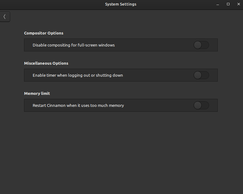

User509533 - Posts: 99
<<<I have moved the following discussion from another thread>>>
@UnixManiac @VLiviu or others Can you please help with the following?
1) I have been using SC over Wine/Mint Linux for over a year. Every time I open my chart-book, many windows/charts open as blank/dark. To solve the problem, I
have to minimize those windows & select/non-minimize them to make them not blank. Have you seen similar issues? Do you have a better solution?
2) On the trading panel, sometimes, I cannot edit/delete the limit price. (maybe not Linux/Mint/wine specific).
3) A suggestion: Can we just modify the networking stack of Wine to make it faster for SC (as fast as the SierraChart_ARM64)?
Reply from @VLiviu (from the previous thread)
"sorry, never seen something like that before but I would do backup of all your charts (only charts) and settings.
Then I would get a clean zip file from sierrachart , move the charts and the settings from backup and run the exe from that clean folder.
Just an idea.
I've been testing mint, arch and Debian."
Just to let you guys know that all the issues (see above) with running Sierra on Linux Mint/Wine are gone as I have removed the limit on the memory under System Settings >> General. Not sure why Mint Linux defaulted to any low limit for a system with 128 GB memory.
imageSierra-Order-entry-slow.png / V - Attached On 2023-07-24 01:22:42 UTC - Size: 21.93 KB - 569 views
[2023-07-24 06:03:47]
VLiviu - Posts: 223
Not sure it has to do with our slow speed download.
The limit is for the desktop manager
Date Time Of Last Edit: 2023-07-24 06:05:05
