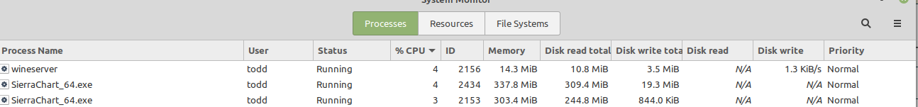

[2021-10-10 20:32:39]
ertrader - Posts: 700
I see what I think may be the same issue:
1) I used an identical chart book on latest Windows 10 and Linux. SC V2319 on both. The Linux computer is much faster than the Windows computer and yet the Linux computer performs this function much slower.
2) I used a trade evaluator account with Denali data to eliminate third party connections
3) Performed Delete All data and download. Then took time measurements from the logs when data started downloading and then when completed.
4) Ensured only one computer was downloading at a time
5) Used the same network for both Windows and Linux
6) CPU usage was only 1% on Linux.
7) The log files, chart book and screenshot of CPU usage are attached
8) No proprietary studies
9) Mint Linux 20.2. Kernel 5.11.0-37.
10) Wine Development 6.19
11) This is affecting historical download times. Once downloaded, everything works exceptionally fast as usual.
Windows: 30.6 seconds
Linux: 20.52 MINUTES
The cause is unknown nor do I know how long this has been happening.
Some insight may be in the attached logs. I will try different configurations to see what may be possible causes and solutions. Any insight and help from SC or others would be great.
A thought: Could this possibly be related to compression and decompression?
Date Time Of Last Edit: 2021-10-11 03:09:26
attachmentTRG_ES_Data_Test.Cht - Attached On 2021-10-10 20:31:55 UTC - Size: 6.41 KB - 843 views
attachmentSC_Windows_Log.txt - Attached On 2021-10-10 20:34:57 UTC - Size: 12.03 KB - 966 views
attachmentSC_Linux_Log.txt - Attached On 2021-10-10 20:46:56 UTC - Size: 13.24 KB - 894 views
[2021-10-10 20:43:08]
CPU Usage
Date Time Of Last Edit: 2021-10-10 20:47:13
imageScreenshot from 2021-10-10 16-24-57.png / V - Attached On 2021-10-10 20:46:21 UTC - Size: 16.07 KB - 750 views

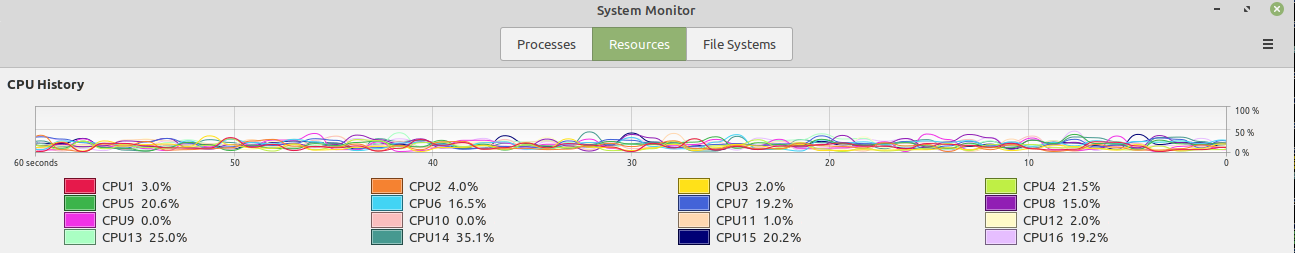

[2021-10-15 22:36:44]
Correct, it is only historical data that is slow to download. I've tested several alternative configurations and the latest GE Egg-roll version and all respond the same with slow historical downloads. Real-time data and order routing work perfect and fast as always.
Slow historical downloads are also NOT caused by CPU locks. During testing, all CPUs are all well under 20% and most in the single digits.
Memory usage values below are lower due to some optimization and elimination of unused charts.
Current configuration:
SierraChart Version 2320 64 bit (2 instances)
wine-6.19 Development
Mint Linux 20.2/Cinnamon desktop
Kernel 5.11.0-37 generic
OpenGL X11lib: 1.7.0
AMD Ryzen 7 3800X
GeForce GTX 1660 Nvidia video card w/6 GB GDDR5 and driver 460.91.03
Dual Monitors 1920X1080 60 Hz for both monitors
Total System RAM: 16 Gig
Memory usage: <350 Meg per instance.
Total CPU Utilization: <=4% per SC instance
45 Charts, 5 instruments (ES, YM, GC, DAX, CL)
Denali datafeed with MBO data
CQG order routing
Updated 10/15/21
Date Time Of Last Edit: 2021-10-15 22:39:51
imageScreenshot from 2021-10-15 18-31-26.png / V - Attached On 2021-10-15 22:35:55 UTC - Size: 27.85 KB - 760 views
