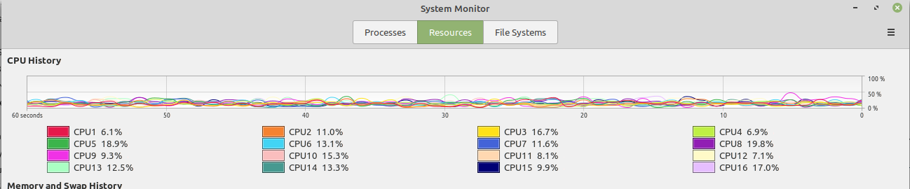

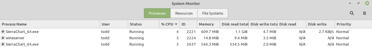

[2021-07-23 02:20:00]
ertrader - Posts: 698
Updated Linux to 5.11.0-25, Wine 6.13 and SC 2288 with zero issues. Added 14 charts (7 per instance for CL and Micro CL) for a total of 100 charts.
Current configuration:
SierraChart Version 2288 64 bit (2 instances)
wine-6.13 Development
Mint Linux 20.2/Cinnamon desktop
Kernel 5.11.0-25 generic
OpenGL X11lib: 1.7.0
AMD Ryzen 7 3800X
GeForce GTX 1660 Nvidia video card w/6 GB GDDR5 and driver 460.91.03
Dual Monitors 1920X1080 60 Hz for both monitors
Total System RAM: 16 Gig
Memory usage: <610 Meg per instance. Using a little more memory on this SC version for one of the instances
CPU Utilization: <5% per SC instance
100 Charts, 7 instruments (ES, YM, NQ, RTY, GC, DAX, CL)
Denali datafeed with MBO data
Updated 7/24/21.
Date Time Of Last Edit: 2021-07-24 18:31:22
