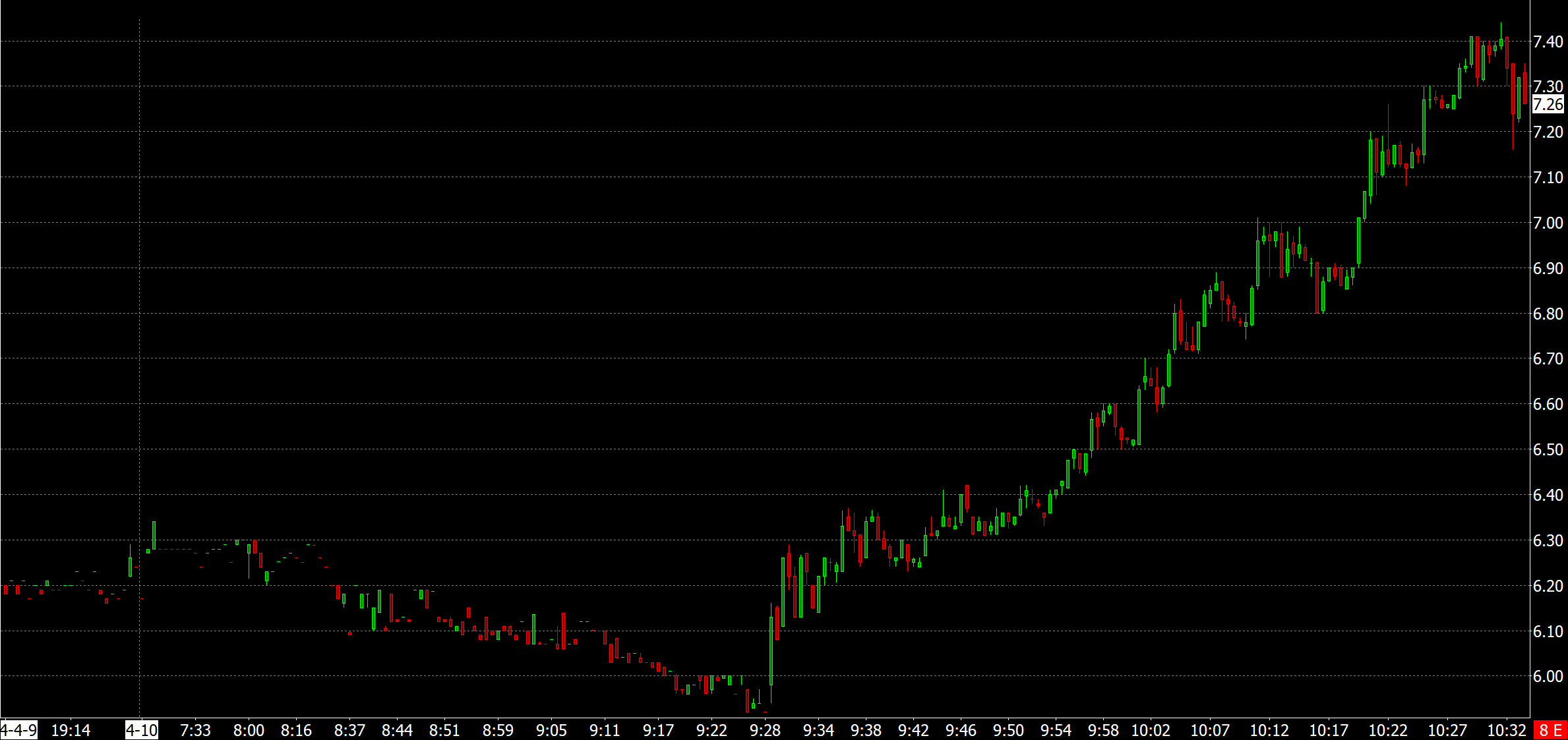

Attached is an image of what we see this morning for that chart. We have the chart setup to be New York time with a Start Time of 09:30. Everything looks correct.
Please get us an equivalent image of what you are seeing.

before 9:30 it showed premarket data. At 9:30 premarket data disappeared. see the image.

The image you attached has us very confused. It looks like you just took this image based on the time in the upper right corner. If this is correct, then your chart is properly showing the data. But you have been stating that this goes away, and in the previous image it showed no data between about April 9, 2024 at 16:00 and April 10, 2024 at 09:30.
Does the data magically show up again? Are you turning off the use of the Evening Session somehow?

Thank you for a good question. Here is the sequence.
1.in the early morning, when i turned on sc, pre market data was showing. in the settings evening session was on.
2. at 9:30 pre market data disappeared. I made no change to the setting.
3. when you asked for the image, premarket data was not on the chart. evening session was on.
4. i turned the evening session off and then immediately on. pre market data showed up on the chart. i took the image and sent it to you.

We were finally able to figure it out. You have the study named "Load Day Session Only at Open" on your chart. This does exactly what you are seeing - it removes the evening session data when the day session starts. Refer to the following:
You will want to remove this study from your charts if you want to continue to view the evening session data when the day session starts.
