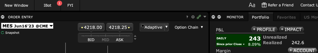

I Enter them on SC but but they would disappear from my charts. I had to use IB platform to see my orders because the wrong orders were showing on SC. The trade window was not showing my P/L and the p/l for the day is wrong. The trade I made today is not showing on SC. See attached trades, p& l from IB. Is there a log file I can send you?
imageIB orders.png / V - Attached On 2023-05-30 20:24:24 UTC - Size: 53.85 KB - 238 views
imagetrade May30.png / V - Attached On 2023-05-30 20:24:39 UTC - Size: 199.42 KB - 313 views
imageP:L may30.png / V - Attached On 2023-05-30 20:24:49 UTC - Size: 36.64 KB - 220 views
[2023-05-30 20:46:13]
Refer to the following:
Interactive Brokers Trading Service: Trade Position Line or Quantity Disappearing or Displaying Zero

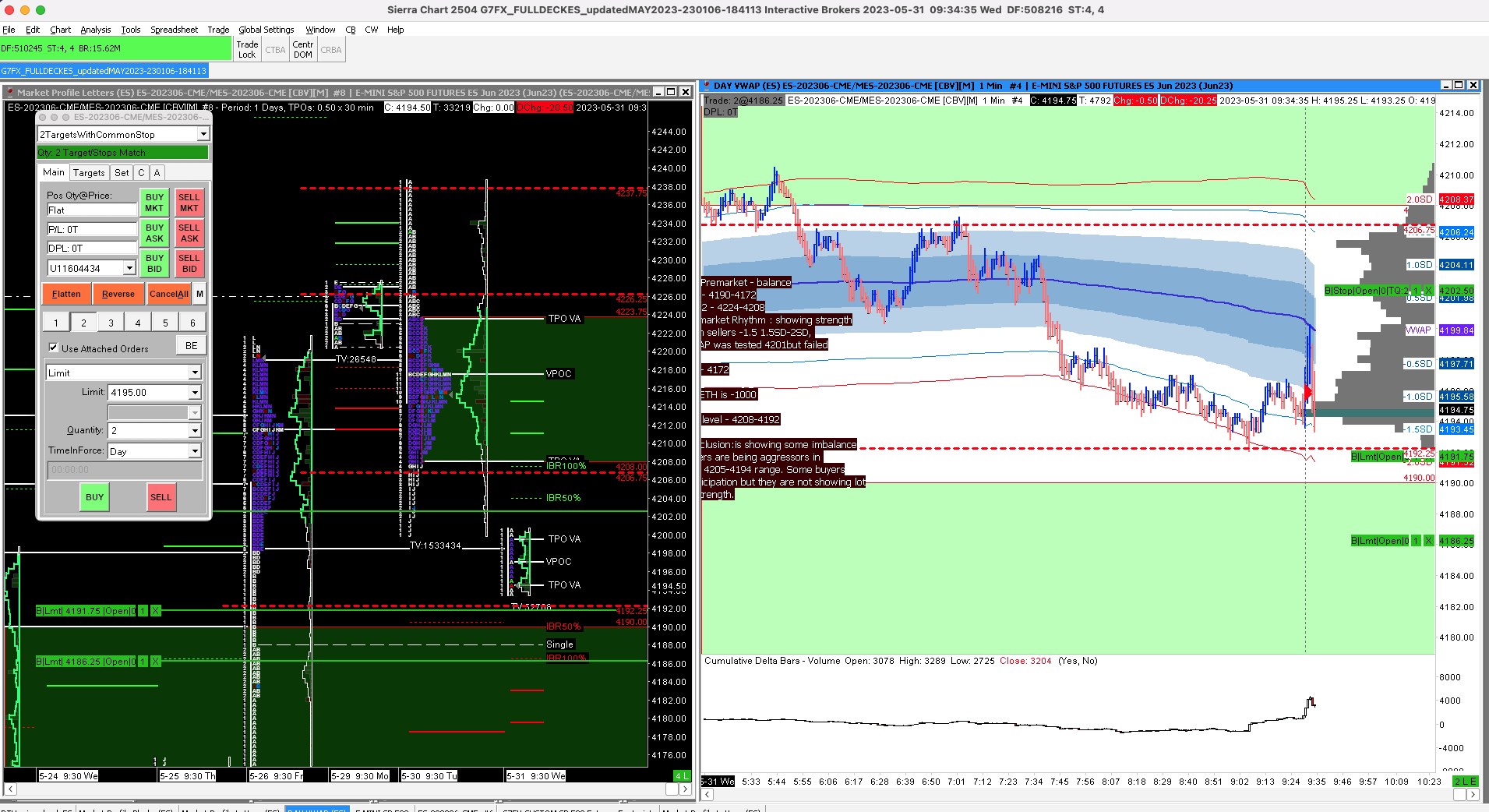

Why is my Position and quanity or P/L is not showing on the trader window? Also the position is not showing on the chart.
imageScreen Shot 2023-05-31 at 6.34.36 AM.png / V - Attached On 2023-05-31 13:41:16 UTC - Size: 281.64 KB - 323 views
[2023-05-31 14:20:32]
User756716 - Posts: 32

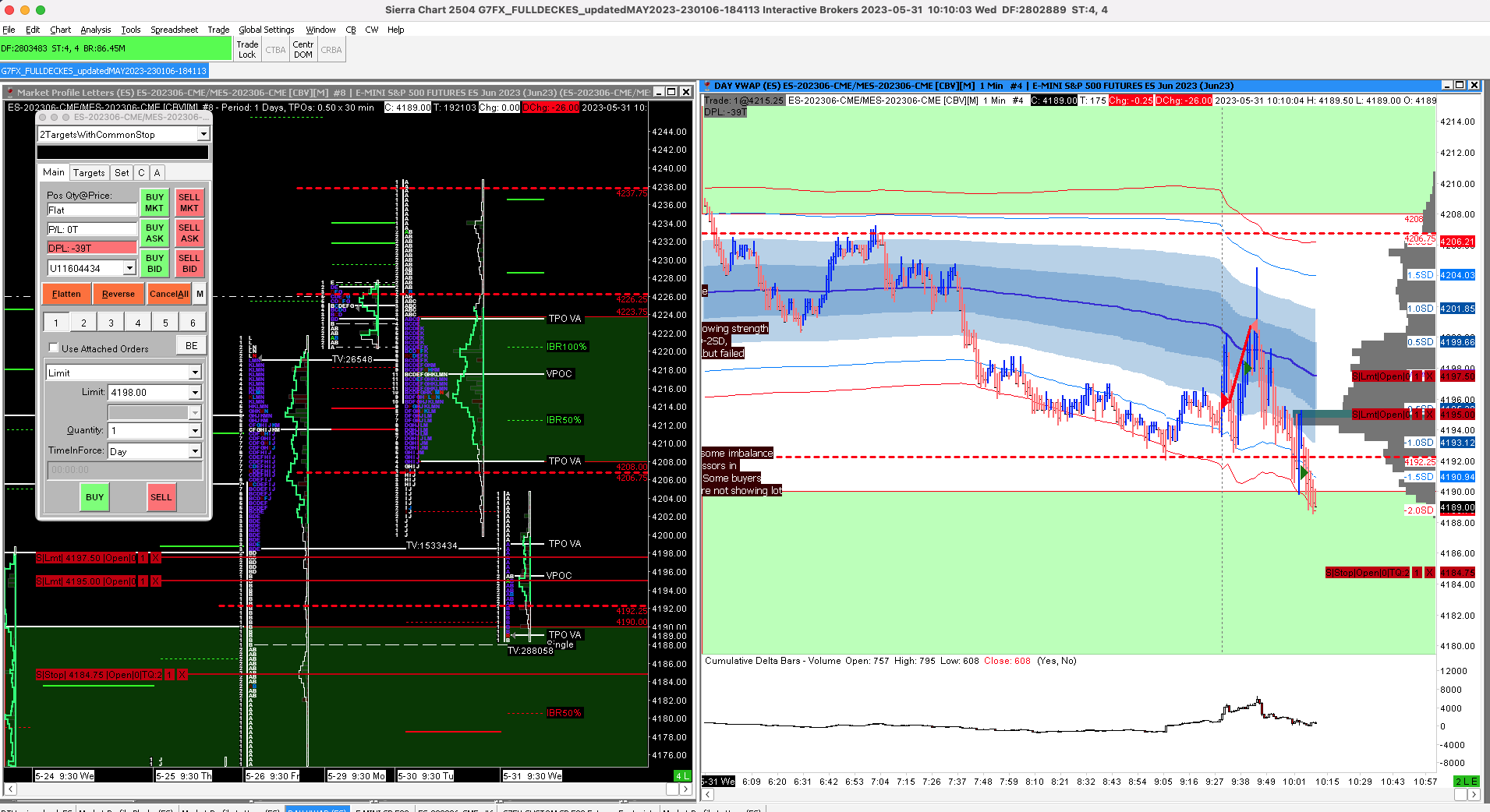

I have 3 trades but the only chart only shows 2. I can see all my trade on my broker platform so they are being transmitted from the SC. How do I see all my trades on the chart and positions and p/l on the trade window?
imageScreen Shot 2023-05-31 at 7.10.04 AM.png / V - Attached On 2023-05-31 14:19:50 UTC - Size: 206.49 KB - 256 views
[2023-05-31 15:34:05]
The main thing is to open a chart for MES and see if the orders are showing properly in that chart. Since you are using a "Trade and Current Quote Symbol" of MES, you need to ensure that the orders from IB are showing on a chart that is just for MES.

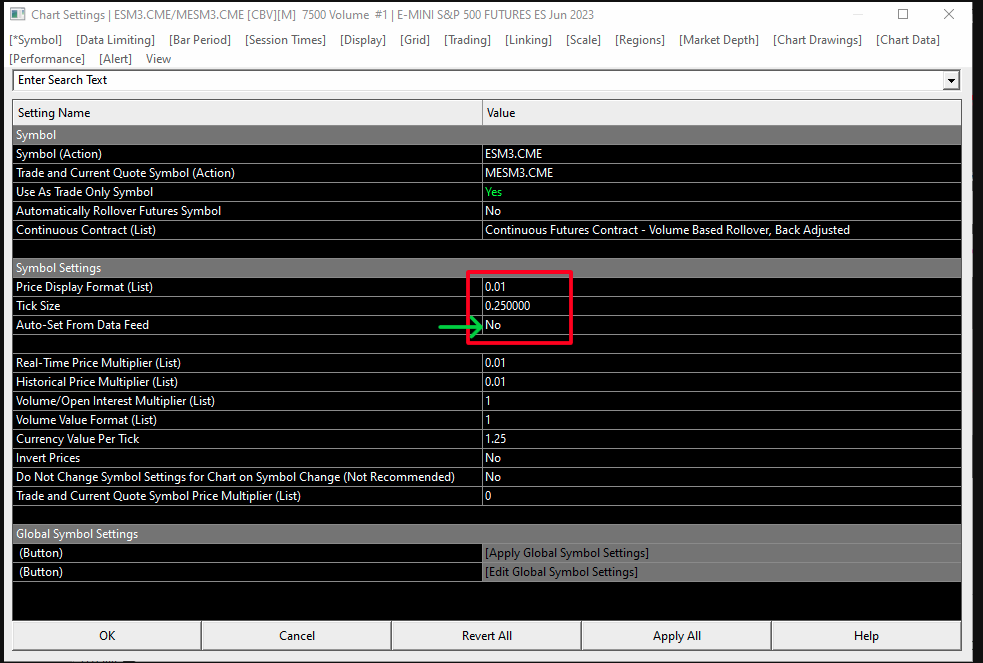

I am switching my broker to Edge Clear from IB. Is this the correct symbol setup for ES and MES using service pack 11 or 12?
imageScreen Shot 2023-06-01 at 1.10.01 PM.png / V - Attached On 2023-06-01 20:11:52 UTC - Size: 68.99 KB - 258 views
[2023-06-01 21:31:17]
Those are the correct settings for the "Price Display Format", "Tick Size", and "Auto-Set from Data Feed" (although this last one is up to you).

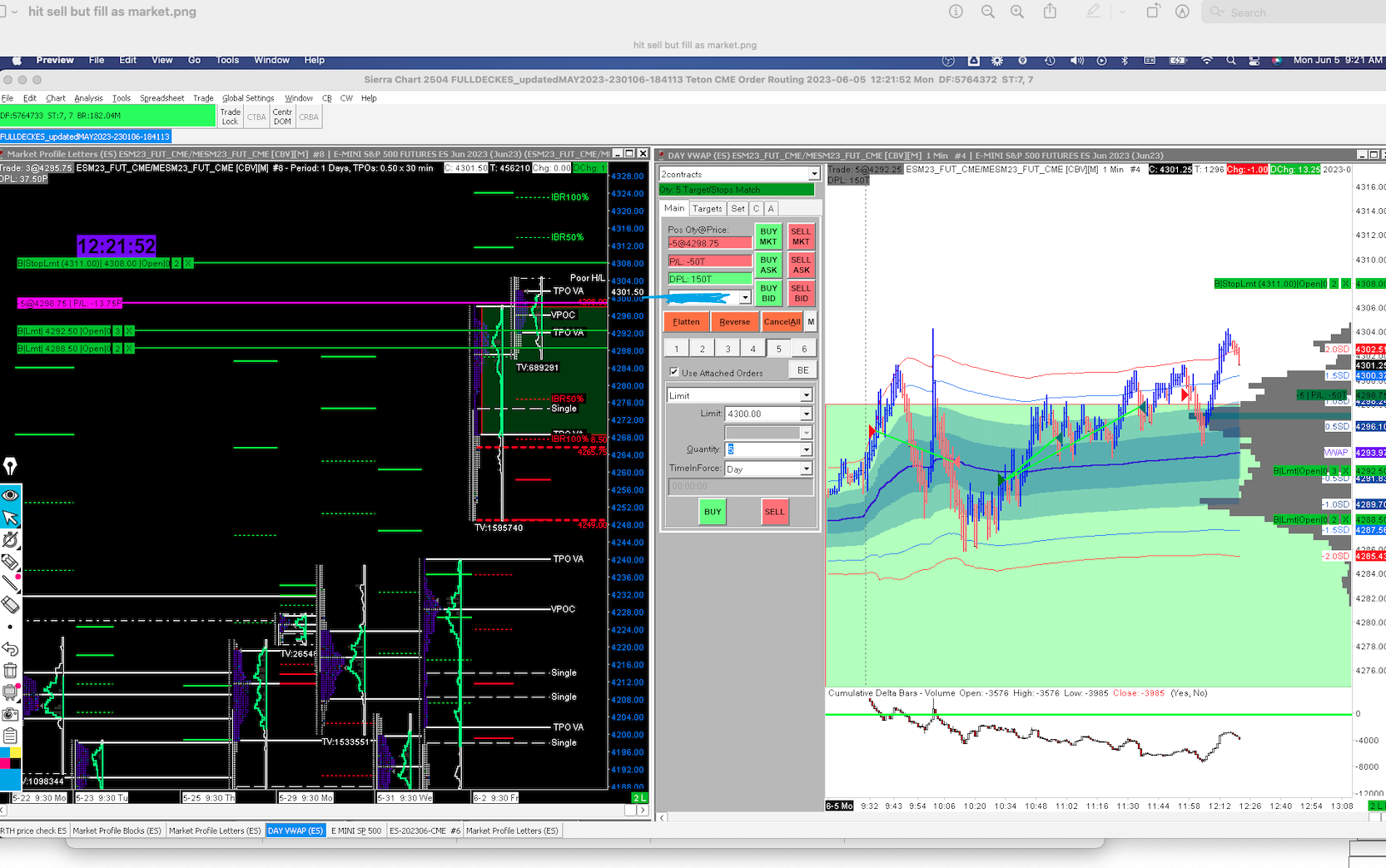

When I put in a limit order on the trade window and hit the "sell" but at the bottom of the trade window my orders are getting filled as market. On the attachment I sent you I put in a limit order at 4300 but it got fill at 4298 Market and I reviewed my other trades and they also getting filled at market. Please advise.
imageScreen Shot 2023-06-05 at 9.48.06 AM.png / V - Attached On 2023-06-05 16:49:27 UTC - Size: 722.8 KB - 299 views
[2023-06-06 08:32:26]
Regarding the issue of not seeing positions when using Interactive Brokers, the issue in your particular case is clear. You were using the wrong symbol. It needs to be exactly:
MES-######-CME-USD
Unless necessary, do not manually specify symbols when using Interactive Brokers and use the symbols only in File >> Find Symbol.
Check the Trade Activity Log and see exactly the order parameters of the order to try to get an understanding of the issue:
Trade Activity Log: Viewing Historical Trade Activity

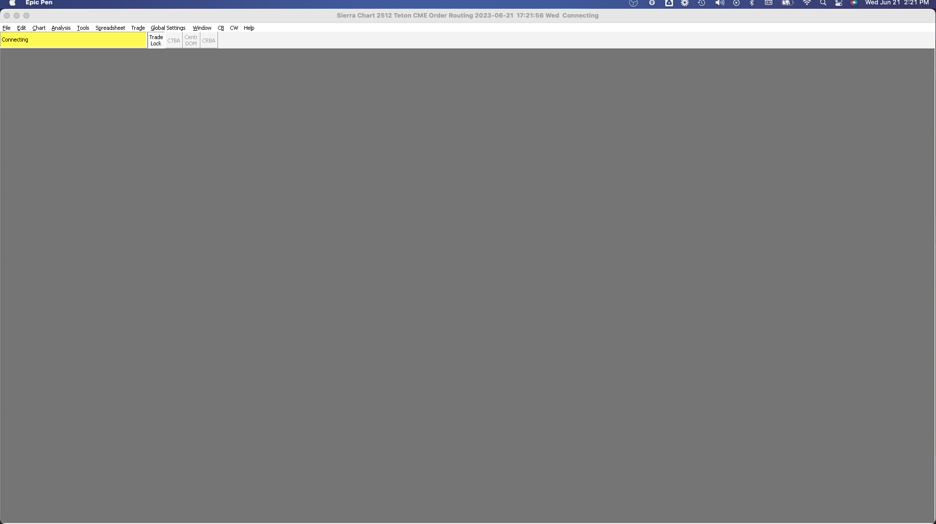

Is the Denali feed down? My feed has been trying to connect and reconnect for the past hour. Please advise.
