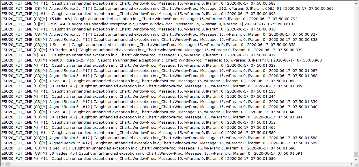

nosast - Posts: 327
Crashed again while basically doing nothing special. Just preparing for the day and looking at charts. This happened while I just put one chart to fullscreen...
Message log attached. Same messages keep flowing in until SC is restarted.
@SC
Please guys. This needs to fixed asap. Let me know if I could be of any help.
imageSNAG_ 2020-06-17 - 14.50.36.png / V - Attached On 2020-06-17 12:53:40 UTC - Size: 107.98 KB - 775 views

nosast - Posts: 327
If I interpret the message log correct, the exception is caused by chart #11. Attached is a chartbook with this chart. Hope you can read private - otherwise hit me up to send over via email.
Date Time Of Last Edit: 2020-06-17 20:02:19

nosast - Posts: 327
Further testing showed that my above statement is wrong. Looks like the issue is not tied to a specific chart at least in my case. Is there any way to drill down the cause of this issue in the logs?
[2020-06-17 20:46:27]
Tooth Fairy - Posts: 89
@nosast
U need to catch it at the beginning, otherwise the message log will be overran by window crashing messages. It always is the first exception message. U need to close the chart book, not sc, then roll back the log to look at the 1st message. Once it’s overran real bad, u can’t even close the chart book so u have to exit sc or terminate the whole process thru task manager.

nosast - Posts: 327
On which systems did you test and on which GPU? Do you suggest one particular GPU that works perfect? I may just get this model than.
I use latest Win 10, Nvidia Quadro P600 with latest nvidia drivers and have really no issues with other OpenGL applications like Bookmap.
Also I will try to reproduce crashes in safe mode to check if a custom study is causing this.
@ Other guys having these issue:
I suppose we are not all using the same custom studies so there might be a problem with Windows 10 edition, compatibility to nvdida GPU or GPU driverset?
[2020-06-19 06:33:37]
samual sprat - Posts: 343
Windows 10 with Nvidia 1070 and latest Nvidia drivers Here
Sierra. Seems the issue is with custom studies? Surely you would need to test with custom studies then. You cannot simply say it’s the fault of the devs making the custom study as they are simply using your libraries in most cases and are competent coders
Ignoring this just means that any further custom studies made could be causes of even more issues And further instability.
Maybe the devs in this thread can test and share some of their code that is basic but causes these exceptions?
[2020-06-19 07:39:16]
nosast - Posts: 327
@sunnyd
I will test every and drill down as good as I can over the next couple of days. Strange thing is, if I do nothing and just let it run it's stable. When I prepare for the day I often put the chart to fullscreen, duplicate and move lines and zones (transparency), zoom in and out. These drawings are linked into other charts with different update intervals.
Once I have a chartbook without custom studies where I can reproduce crashes I will share it here for broad testing.
Seems to me this is not related to a custom study but rather to an issue with chart drawings.
Also tried to go back to GDI last night but it is just way too laggy for me. Tried to quickly move trade lines in SIM on a depth chart with an update interval of 250ms just not doable while trading.
[2020-06-19 07:51:20]
@nosast thanks bud, very much appreciated
I too use a lot of drawing tools, lines, channels, transparent rectangles and also copy drawings across charts. Zooming often seems to cause crashes, but only when I first open the chartbook. Like you if I leave it alone for a min or two it will be stable for days
I mainly get issues after updating to a new version of SC, after which to get it stable I find copying charts in safe mode to a new chartbook fixes most crashing issues.
Seems we need to get a list of things that cause issues for people and compile it somewhere so we can find patterns
