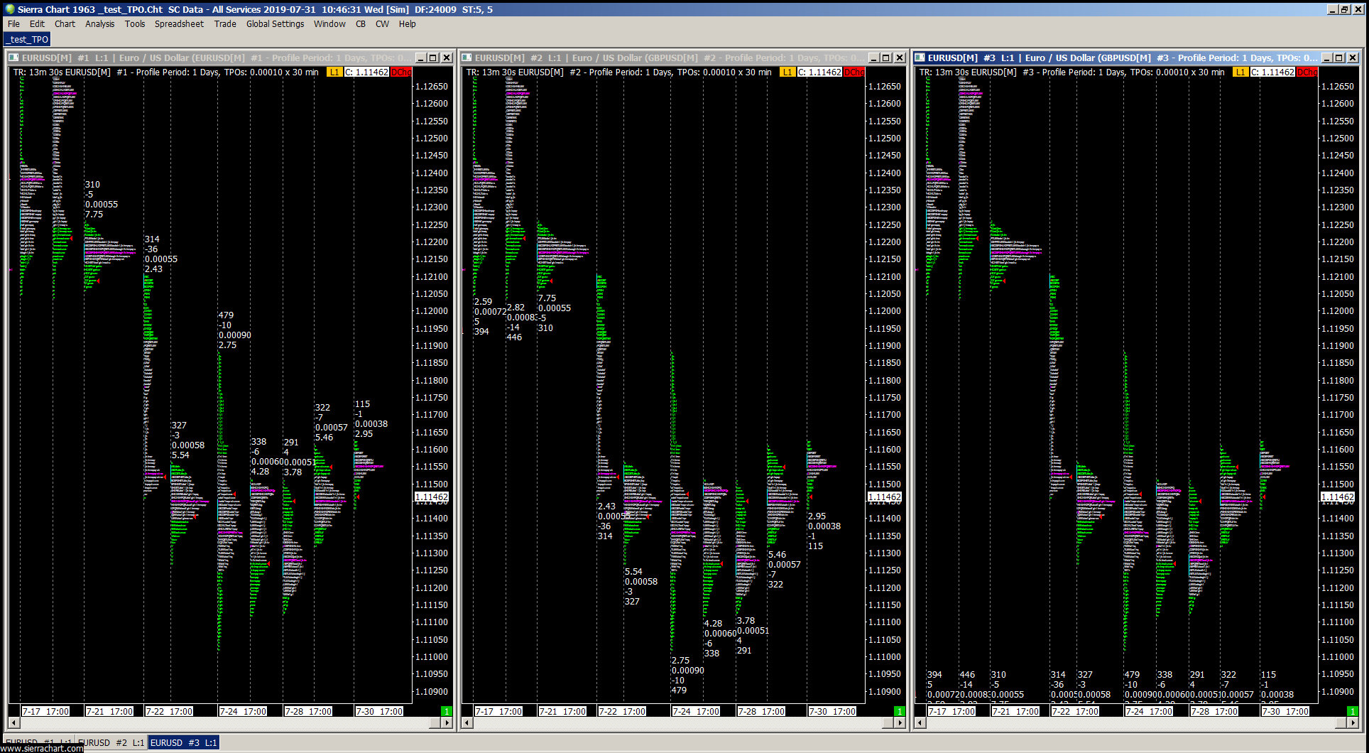

[2019-07-27 18:05:58]
User365411 - Posts: 196
Pre-realese 1959
I saw that you implemented my request, thanks for this.
I probably didn't understand your intentions, I thought the study was added as a separate study, as for "Number Bars Calculated Value" study, in its specific chart region, so you can export the data and avoid the overlap of the text on TPO profiles when there are many of them as you see in picture 1.
So, using actual solution, the primary problem remains, unfortunately the statistical data of the TPO profiles as they are now conceived are not exportable and a scan of the values in the sumamry window cannot be done either.
I don't know if you will ever implement the separate study, the best solution in my opinion, but in the meantime I ask you if you can make some changes to the current version to minimize the text overlap problems:
- add an option, maybe in "Show Text Label", to completely hide the visualization of data so with few clicks i can choose to remove them from the view leaving Chart Value 1,2,3,4 already set
- add an option, maybe in "Show Text Label", to leave only numbers without text field, so data visualization is more compact
- if possible add an option in "Show Text on Top" to view the data at bottom of the window so data don't overlap and comparing data in each field is visually more immediate (simulated in image 2)
Thank you.
Date Time Of Last Edit: 2019-07-27 18:32:56
imageIMG01_Sierra Chart MainWindow 2019-07-27 19_52_56.497.png / V - Attached On 2019-07-27 18:04:56 UTC - Size: 224.63 KB - 875 views
imageIMG02_Sierra Chart MainWindow 2019-07-27 19_58_48.046.png / V - Attached On 2019-07-27 18:05:02 UTC - Size: 126.05 KB - 741 views

[2019-07-31 08:49:22]
All items mentioned in post #31 will be addressed in the next release. We have also added a new ACSIL function to access all these TPO chart values:
int (SCDLLCALL* GetStudyProfileInformation)(const int StudyID, const int ProfileIndex, n_ACSIL::s_StudyProfileInformation& StudyProfileInformation);
And we also may add Subgraphs which hold the values but that is a little uncertain at this point in time. This may not be so practical. And now that we have added the function to ACSIL to access them you can programmatically do what you need with the values.
Pre-release 1963
Just a feedback, the data are now more readable, ty.
There are also 2 little bugs, (attached image):
- fields order is not costant using the 3 methods, if possible it's better to maintain always same order like in the input window and chart #2
- value in "Chart Value 1 (In:115)" partially disappear below the bottom of the window in chart #3, and totally disappear when there are long range profiles (i.e. GBP/USD)
And we do plan to work on the items requested in the other thread
This is a very very great news!
Date Time Of Last Edit: 2019-07-31 08:52:26
imageSierra Chart MainWindow 2019-07-31 10_46_30.005.png / V - Attached On 2019-07-31 08:47:18 UTC - Size: 129.55 KB - 842 views
[2019-08-01 02:16:47]
We will take care of these.

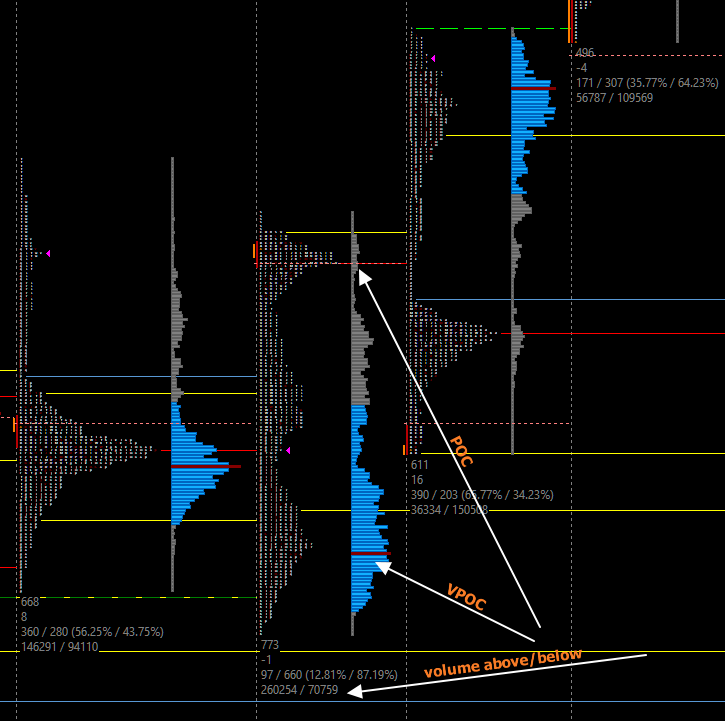

[2019-11-05 14:22:28]
User722856 - Posts: 81
Dear Sierra,
I have a question regarding the
„Volume Above/Below POC: This displays the volume traded above and below the POC Price.“
Is this really the POC Price or is that the VPOC Price and the Documentation is wrong?
Documentation:
Time Price Opportunity (TPO) Profile Charts
see: "TPO Profile Text Information Descriptions"
TPOs Above/Below POC: This gives the number of Letters/Blocks that are Above and Below the POC. It also displays the values as percentages.
Please see the example bellow and attached detail image.
There is simply too less volume, above the POC to be this correct, as stated in the documentation.
I think it is the VPOC.
http://www.sierrachart.com/image.php?Image=157296369523.png
And if i am correct, than this is somewhat unusefull, because we want to compare the TPOs above/bellow POC with the Volume above/bellow POC (and not the VPOC).
Thanks in advance.
Best regards
Date Time Of Last Edit: 2019-11-05 14:43:12
imagevpoc.png / V - Attached On 2019-11-05 14:21:57 UTC - Size: 39.66 KB - 730 views
[2019-11-06 23:06:22]
We will update the documentation. It is the volume traded above and below the Volume point of control. Not the TPO point of control.
In regards to post #38 we will see.
Date Time Of Last Edit: 2019-11-06 23:12:48
