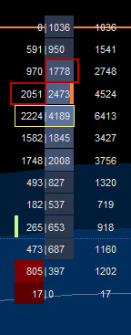

trademechanics - Posts: 29
When using the Text Coloring Method of 'Text On Dominant Side Auction', the comparison is diagonal and not horizontal.
Please see attached image.
Maybe I'm misinterpret what has been said but if true, shouldn't the 2051 be colored red since it traded more volume than the 1778?

[2014-02-21 20:37:29]
Al SC Developer - Posts: 434
In the current version (1095), there is an option in the background coloring to do dominant side coloring and an auction version as well which does the diagonal compares.
When doing dominant side comparisons, use values like "200" if you want 200%.
We are in the process of updating the Numbers Bars documentation to explain the above.
Date Time Of Last Edit: 2014-02-21 20:38:05

[2014-02-23 14:28:00]
The imbalance coloring is correct for background coloring, and will be addressed for text coloring in ver 1097.

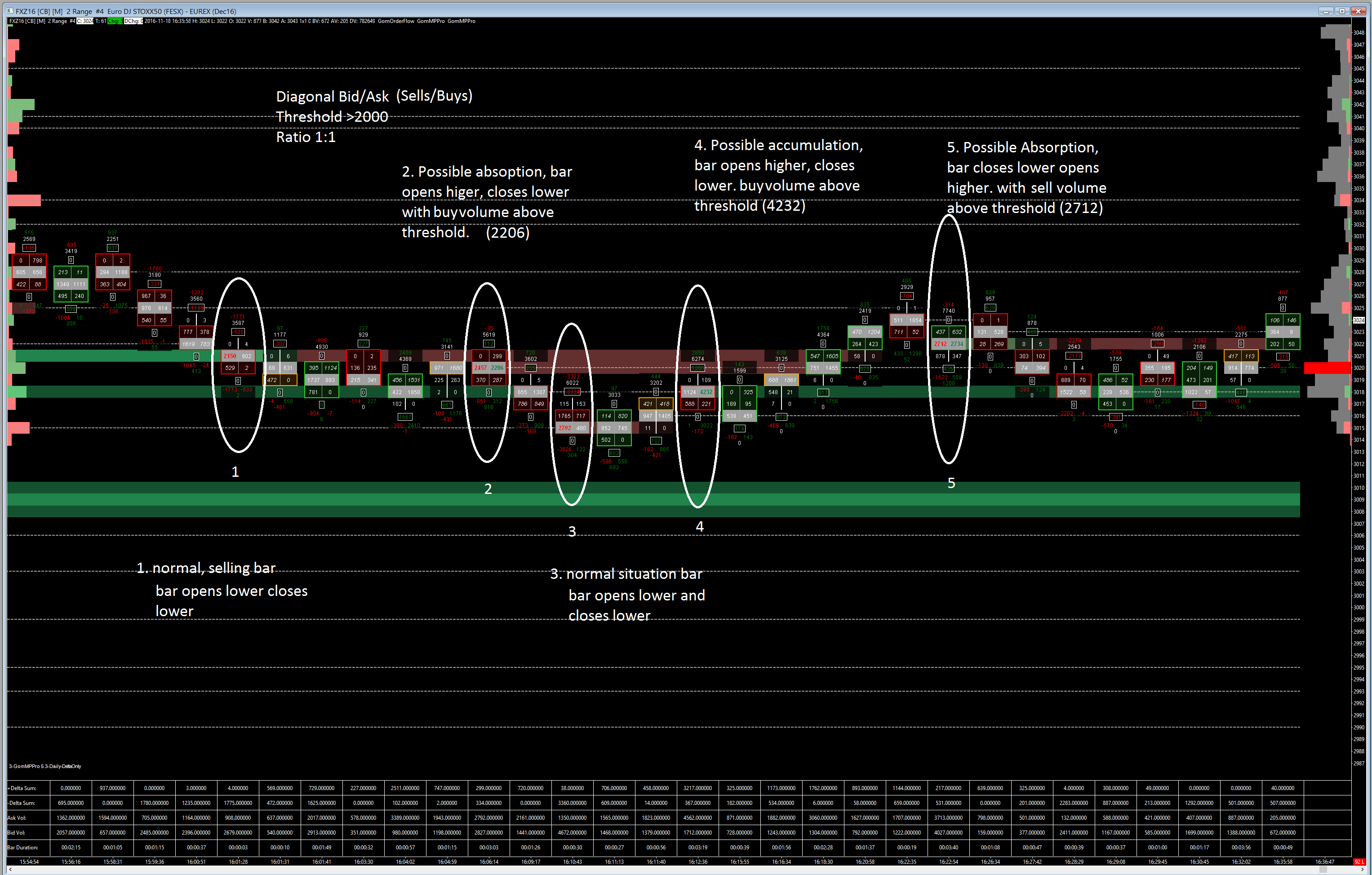

User83762 - Posts: 61
How can we set an alert for the largest threshold number?
[2014-03-31 16:22:11]
Alerts of this type with the Numbers Bar study are not supported. But we are aware there are some user contributed studies that do this. At least we think so. You will need to search through this Support Board.

[2016-11-22 03:45:01]
Peter - Posts: 9
Example pic.
Alert is coloring background based on alert condition (and color bar based on alert condition.)
not a sound alert.
Together with other parameters which i already have in an alert condition, this will give me just a little bit more.
I use it on "2-range" bars, its possible that on larger timeframes the info is useless.
Will to pay for it if it's within budget.
(i use 3rd party software for number bars, the sierra number bar study for alert conditions.)
changed pic.... (buys/sells wording in stead of bid/ask)
Date Time Of Last Edit: 2016-11-22 05:35:45
imagesierra-alert-question.png / V - Attached On 2016-11-22 05:34:45 UTC - Size: 175.61 KB - 3796 views
[2016-11-29 21:08:59]
You can already do what is described in the image attached to post #47 using the Color Bar Based on Alert Condition study:
https://www.sierrachart.com/index.php?page=doc/ColorBarBasedOnAlertCondition.php
However, we do not provide formula programming help.
