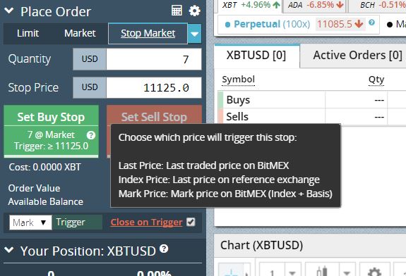

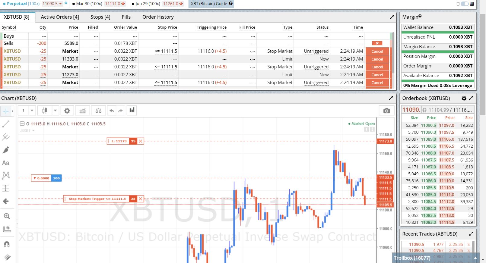

Anyone else having some serious problems with bitmex stop orders, i am on the new connetion (direct trading).
It seems as though the stop market orders are not working as i want them to. And after a little digging i found out why.
My guess is that Bitmex allows 3 different stop market triggers, the one that i want it to be using is the last price of the actual bitmex trades, but there is also the option of using the Mark price, or the index price. It looks like the orders through sierra are using the MARK price. so when price actually hits your level, it will NOT take you out of the trade. So the question is, how do we set the stop market order type so that the trigger price is the LAST price.
In the photo you can see the actual trigger price is not close to what the bitmex price is at... and when the trade was closed it was way way lower and you are blown out at that low lever.. and its costing me a lot of money, but im glad i figured out the reason why now. I just need to know how to let Sierra signal the proper stop market trigger type, the way stops normally work.

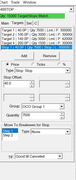

We are not specifying the execution instruction with a stop order so it must be defaulting to the mark price. Will make sure to specify it as last price.
For now use the client-side managed stop order type named Stop with Last Triggering.

I tried that stop with last triggering, it did not work at all.

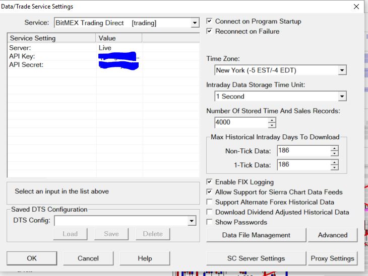

coin boss - Posts: 19

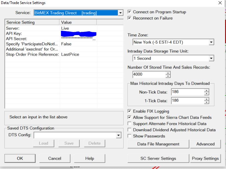

you mean when you have service: Bitmex Trading direct in the drop down menu.. then you go to service setting and add a field?
That does not work.
There are 3 fields: server, API key, API Secret.
No other fields are there, and when you click on a blank field, it does not allow you to enter anything for that field. i have enclosed a screenshot.
You say you are going to add an adjustable setting, and are getting to it today.
So perhaps i will just wait until its done.
For now I am just using their website to add the stop manually.

[2018-03-02 23:21:40]
OK now we understand the difficulties. You are not running the latest prerelease. You need to be on the latest prerelease.
Update with Help >> Download Prerelease.
Also, we have that Stop with Last Triggering stop order issue resolved and will have a new release out in about an hour. It was not being allowed to be changed to a market order type or being recognized as a stop order by the external service client to do to several safety checks.

Ok I downloaded the release.
I see the execinst area... but if I set LastPrice there, it is trying to use that variable for all orders, so if i am entering with a limit order it throws an error and does not place. I guess the problem is that setting is a global setting for all orders (?).

Yes we were concerned about that. We have now released version 1711 with the new setting to set this particular execution instruction for stop orders.

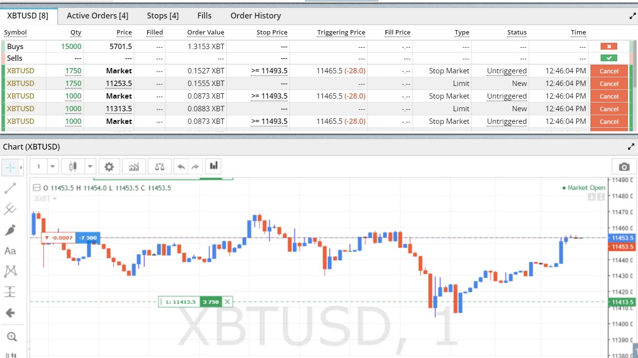

It is still not working, it is still using mark price... you can see the trigger price is not equal to the current price.
I have attached photos.
Do i have to have the STOP set to a certain type?

We apologize for this. There was a small error preventing that particular instruction from getting actually set with the order. This is now resolved.
Update with Help >> Download Prerelease:
The version number is still the same.

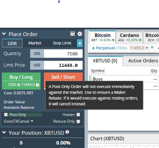

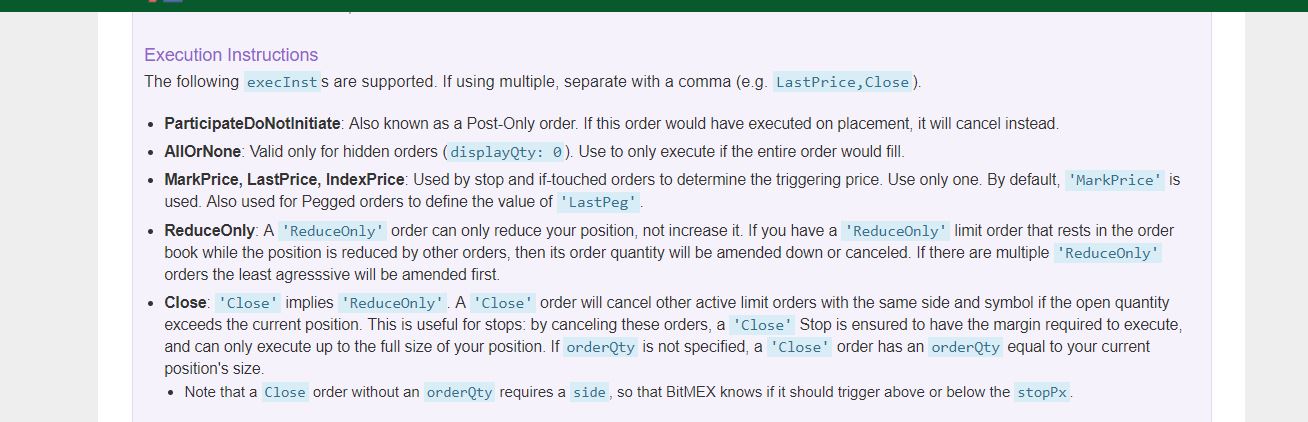

Re: the previous question about limit order executing as market.
That happens to me also. it is most likely because the order moves by the time it gets executed at the exchange.
There is a command to stop this when you send the limit order. I have attached 2 photos.
It is an execinst variable... so theoretically, just like the "lastprice" variable that sierracharts created an option to add, they can also do the same with the post only. Its actually a big deal for trading short term. it can make or break the trade being profitable if trading for 10 or 20 ticks.
The execinst variable is: ParticipateDoNotInitiate.
I notice there is an "additional execinst for orders:" where you can add a execinst variable..
but im afraid that might be a blanket variable used for all orders.. we would need there to be a separate one for limit orders.
imageCapture.JPG / V - Attached On 2018-03-05 01:29:48 UTC - Size: 59.59 KB - 1299 views
imageCapture2.JPG / V - Attached On 2018-03-05 01:29:53 UTC - Size: 111.87 KB - 768 views
[2018-03-05 03:36:26]
In Global Settings >> Data/Trade Service Settings you can enable the setting to specify ParticipateDoNotInitiate with orders. It is there.
We can make it for limit orders only if that is how it is only intended to be used.
[2018-03-05 04:39:01]
This is what BitMEX told us:
Yes, you cannot send execInst=ParticipateDoNotInitiate for ordType=Market or Stop or MarketIfTouched, nor can you send it with timeInForce=ImmediateOrCancel or FillOrKill
