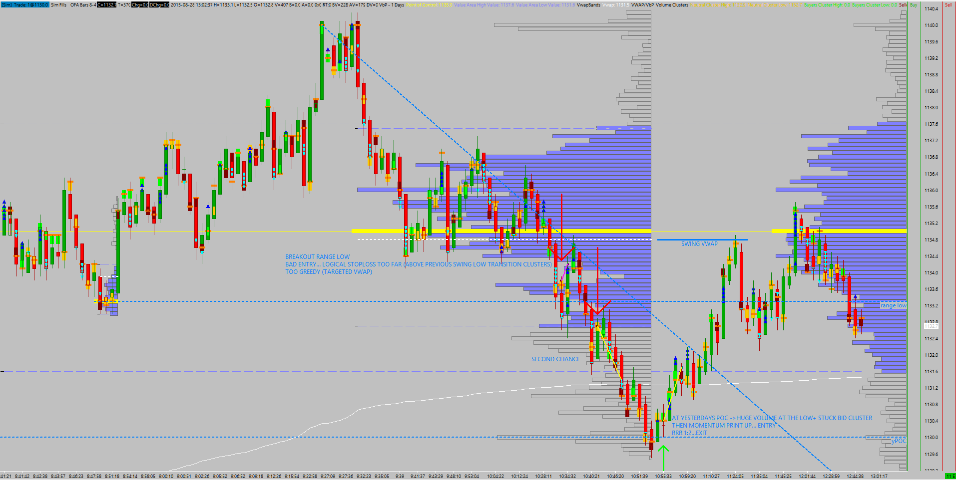

So here are my ideas about momentum mapping study. I managed to make the simple one and I plan to make the real OFA mapping. I hope you can understand what I mean... If you find something wrong, please let me know.
Petr
PS: Below you can see how it looks like... Trading Gold futures according to OFA in Sierra Chart with 1 contract on SIM.
(for explanation: mapping are the blue triangles, green-clusters of buying effort, brown-clusters of selling effort, yellowish neutral volume clusters.)
attachmentOFA Momentum.pdf - Attached On 2015-08-28 18:10:21 UTC - Size: 622.33 KB - 1608 views
image2015-08-28_GC.png / V - Attached On 2015-08-28 18:36:59 UTC - Size: 85.78 KB - 2501 views

ok i have to understand how to do diagonal comparison between ask-bid
[2015-08-30 13:27:52]
Zdislav - Posts: 73
That is simple... when iterating through price levels in each bar,I save the BID price to compare it with ASK price in next iteration (for bullish momentum from low to high iteration). Retrospectively for bearish momentum.

Question on Volume Cluster portion (which doesn't seem to be included in the above study) - Do you just pick the highest 3 consecutive prices which has the cumulative volume to be highest or some other logic do you use? What is the criteria you are using to mark the volume cluster on the candle?
thanks
[2015-08-31 17:40:30]
Zdislav - Posts: 73
ejtrader: Yes, that is exactly what I am doing. Take the highest cumulative volume of a given (from some input value) number of consecutive levels. In my case I use 3 levels. It is not exactly the OFA method, but it is close enough and it works pretty well. I haven't tried all the markets, only ES, GC and CL. OFA method seems to use different logic giving more clusters in one candle some times. The color distinction is simply comparing BID and ASK cumulative volumes in that given volume cluster against STRENGTH constant.
e.g.
IF BIDvolume >= 1.618*ASKvolume THEN Cluster color is green, resp. brown. If it does not fit either condition, than the auction is neutral (gold).
