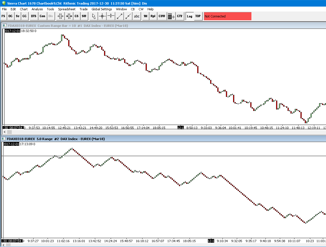

Please do check, you will see it is not giving the expected 10 range chart, I just checked 1678 build.
Custom Range bar : top chart of included pic
Normal working range bar : bottom chart of included pic

[2018-01-02 07:53:42]
We are looking this over now.
This has already been corrected:
It seems
ChartBarInterface.InsertNewRecord = 1;
is missing in the sample.
Date Time Of Last Edit: 2018-01-02 07:54:34
[2018-01-02 08:06:14]
We found the problem. We are just finishing with the testing now.
We apologize for the delay. We basically have been working nonstop over the holiday. Just getting to this now though.
[2018-01-02 09:04:07]
We have released version 1679.
Update to that Prerelease version. This is an additional revision of it.
Keep in mind that the Range bars example is not the same as what is built into Sierra Chart. It is just a simplified example and is not as thorough of an implementation. So the ranges are not always going to match the setting.
Date Time Of Last Edit: 2018-01-02 09:05:46
[2018-01-02 10:20:03]
gomifromparis - Posts: 244
OK works now. Thanks

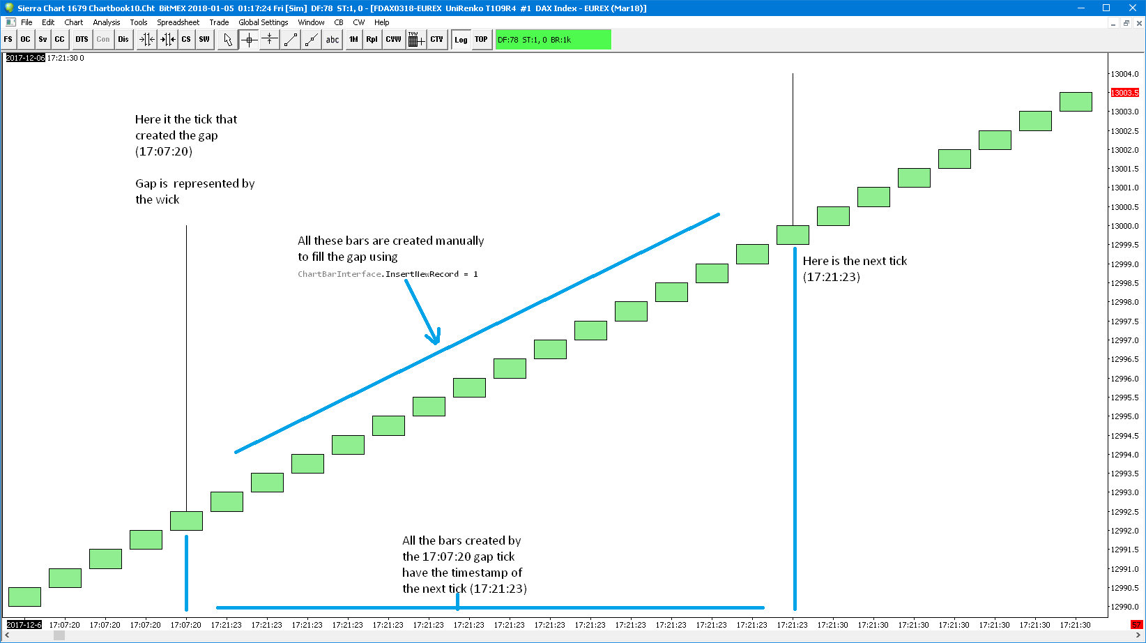

This can actually be observed on a historical chart, all the bars created by a gap tick using ChartBarInterface.InsertNewRecord = 1 have the timestamp of the next tick.
imagegaptimestamp.png / V - Attached On 2018-01-05 00:24:43 UTC - Size: 50.1 KB - 666 views
[2018-01-05 00:30:33]
This does make sense. Splitting does not occur until there is a new file record read and there is certainty the existing file record is finalized.
We will see if we can easily improve upon this and split even after a single tick record immediately.
