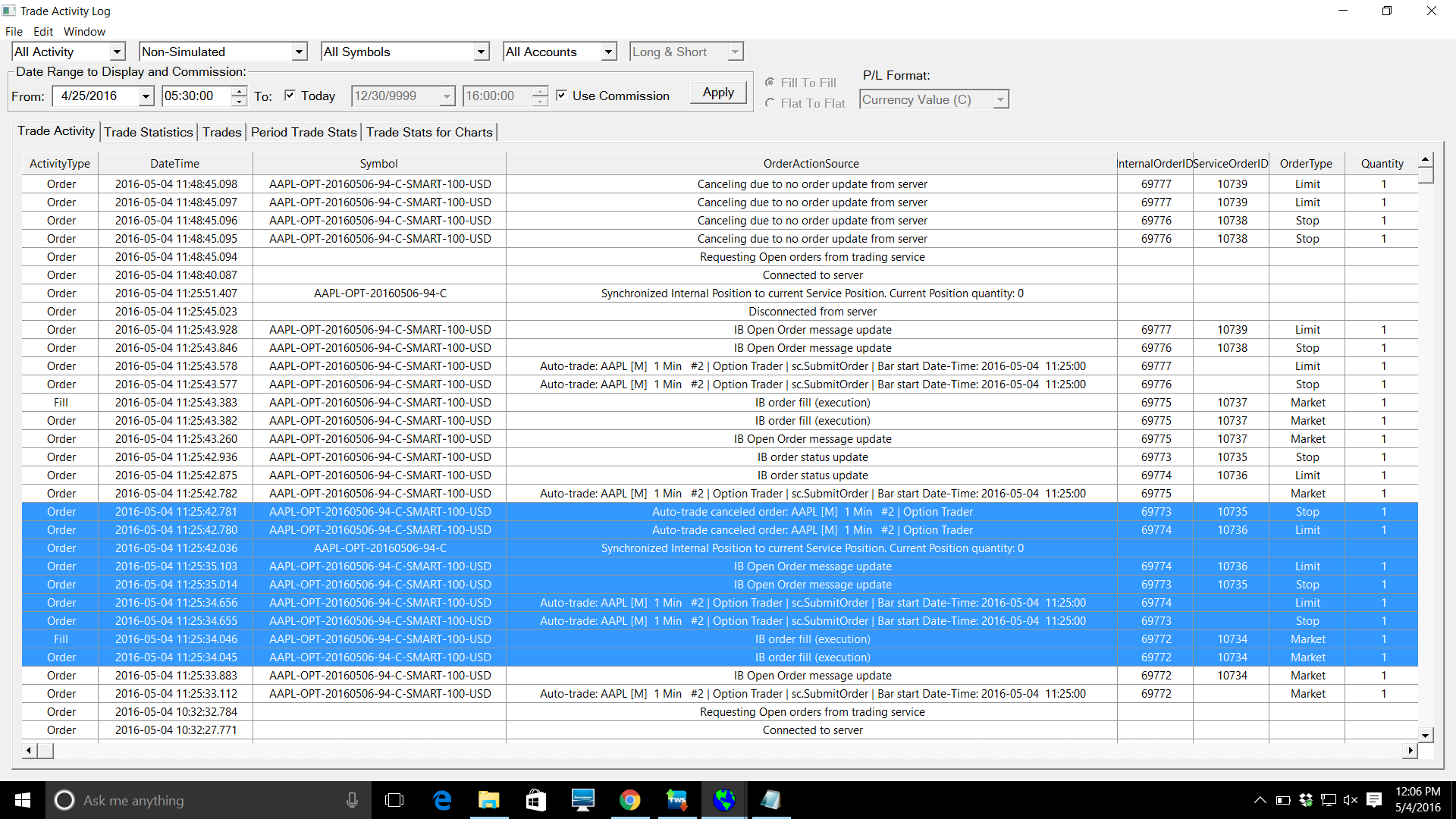

User713273 - Posts: 409
TWS Trade Logging also referenced if needed.
image2016-05-06_twslog.png / V - Attached On 2016-05-06 21:53:55 UTC - Size: 64.03 KB - 404 views

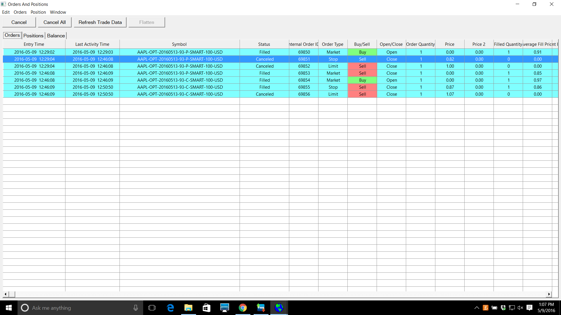

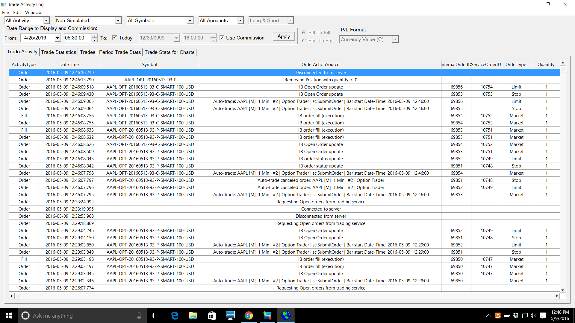

Just to be sure that we haven't overlooked anything, when you had a Position in the option symbol, did you look at the Trade >> Trade Orders and Positions >> Positions tab and see if the Trade Service Position Quantity was 0 for the Symbol?
Ok I did another test and did not have any errors. Have attached Trade Activity Log and Trade Orders and Positions, both Order tab and Positions tab attached. The cancellation you see in Trade Activity Log occurs only when we get a reversal in direction of position, this has always been inputted in our source code and relates to our strategy.
Running Version 1406.
Besides updating to Version 1406 there have been no discernible changes that have been made. I'm still very unsure of why we had no errors today and all of last week, when tested we did.
Thanks again, Adam
imageimage (8).png / V - Attached On 2016-05-09 20:03:01 UTC - Size: 239.08 KB - 389 views
imageimage (9).png / V - Attached On 2016-05-09 20:03:10 UTC - Size: 158.18 KB - 423 views
imageimage (10).png / V - Attached On 2016-05-09 20:08:36 UTC - Size: 111.47 KB - 426 views

Thanks. Updated to newest pre-release 1409. 2nd day in a row no issues have come about. Will test again tomorrow morning. Still wanted to get information to you as I know you've added logging.
Sierra Chart Trade Activity Log file attached.
Symbol - AAPL-OPT-20160513-94-C-SMART-100-USD & AAPL-OPT-20160513-93-P-SMART-100-USD
Time - 08:49:20:940 - 09:01:31:174
Time Zone - PST
Also I got this from IB Support.
Your log files have been received and reviewed.
The logs do show the cancel order requests being made by Sierra Charts on the problematic day 05/04. They also show that Sierra charts made a portfolio subscription request on 05/09 which resulted in streaming portfolio data being continuously returned on 05/09, but there is not such a request from the log section provided for 05/04. Presumably, the Sierra Charts software is interpreting the absence of data as evidence that there are no portfolio changes occurring, and this may be a source of issue.
To investigate further, can you please upload the complete log file from 05/04? If it is larger than 15 MB it will have to be zipped and emailed to api@interactivebrok ers.com.
Date Time Of Last Edit: 2016-05-10 17:21:20
