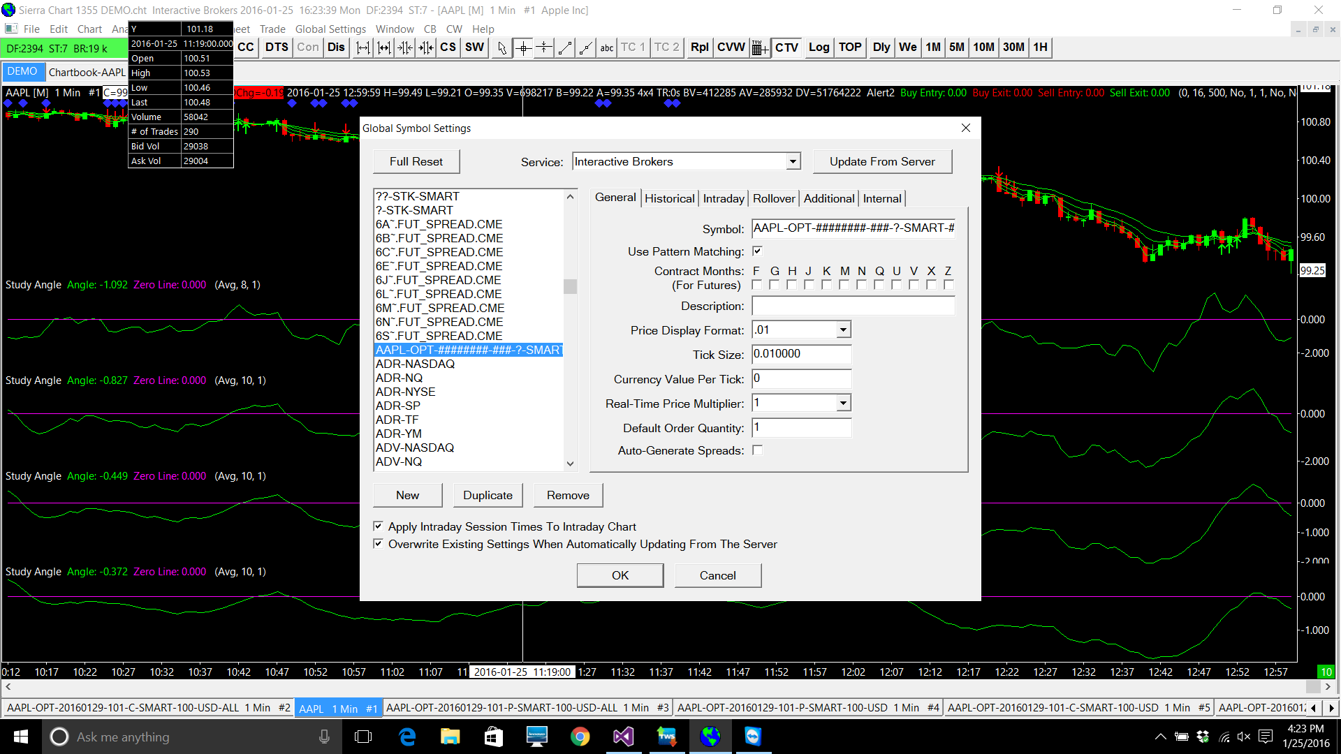

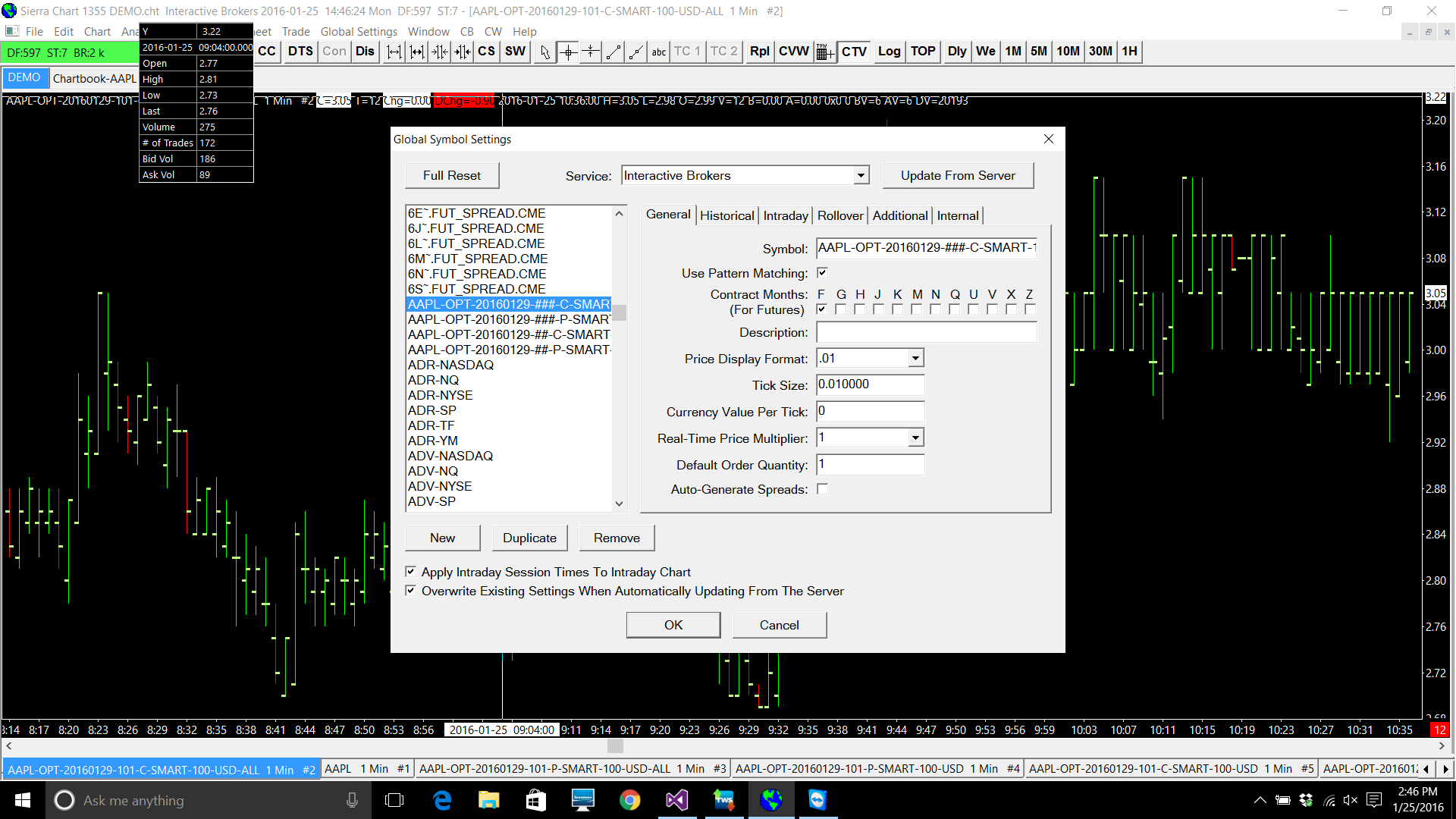

[2016-01-25 16:03:01]
You need to add the Symbol Pattern for this symbol being traded and set up the Tick Size in Global Settings >> Symbol Settings:
Global Symbol Settings
[2016-01-25 23:38:04]
User713273 - Posts: 409
Please confirm these are the appropriate settings.
imageimage.png / V - Attached On 2016-01-25 23:37:52 UTC - Size: 191.26 KB - 482 views
[2016-01-26 00:11:19]
Do not enable any of the Futures Contract months.
For the symbol use this:
AAPL-OPT-########-###-?-SMART-###-USD
[2016-01-26 00:27:20]
Great, please confirm, will be testing tomorrow.
imageimage.png / V - Attached On 2016-01-26 00:27:16 UTC - Size: 218.62 KB - 438 views
[2016-01-26 00:40:18]
Yes. That looks correct.

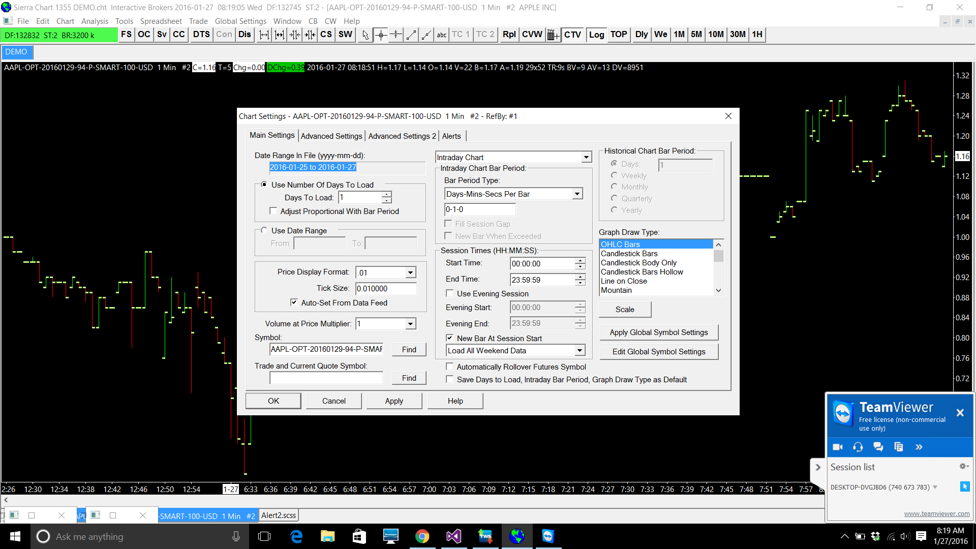

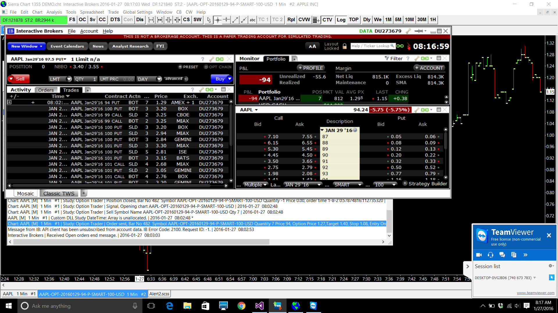

[2016-01-27 16:26:33]
We have switched symbol settings to the specifics you put forth still getting "tick size is unknown. Unable to modify order" & "the price does not conform to the minimum price variation for this contract"
Specifically what price field are you referring to?
I have attached a screen shot that shows a trade that occurred at 8:02, price in IB is 1.29, price within SC trade log is 1.27.
And is the Trade and Current Quote Symbol being programmatically changed through ACSIL?
The trade symbol is being populated based on spreadsheet buy/sell signals, and we are rounding to the nearest integer, we have had no issues facilitating market orders. I dont know if this is what you need here.
imageimage (1).png / V - Attached On 2016-01-27 16:25:44 UTC - Size: 211.28 KB - 410 views
